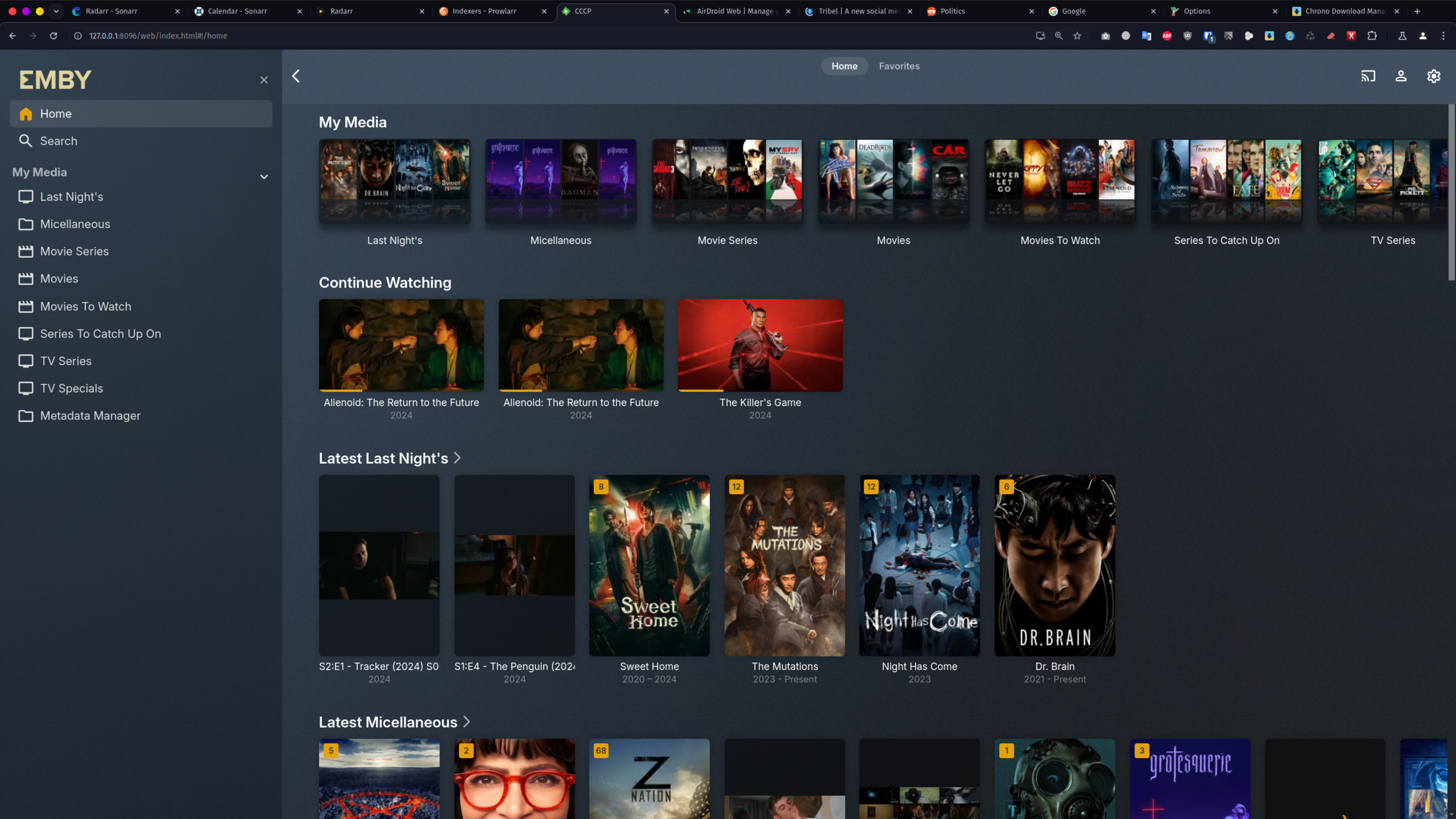

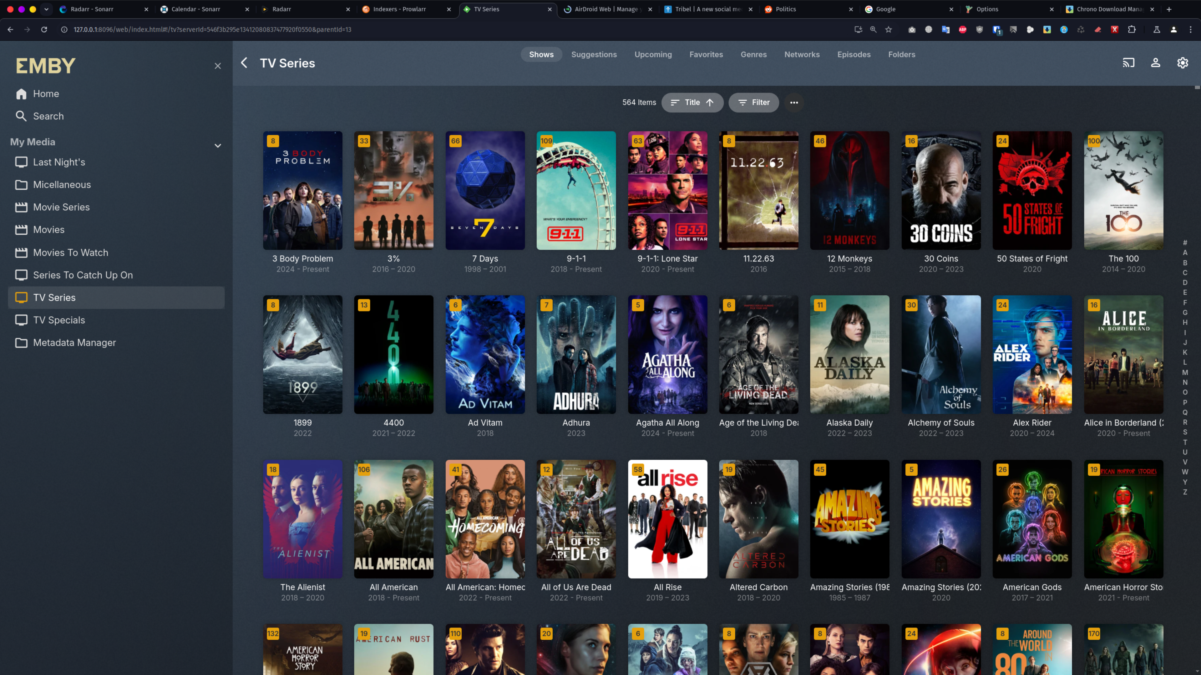

IAmHugh 64 Posted October 19, 2024 Posted October 19, 2024 I went in on a fresh install of Emby to finally fix any shows and movies that Emby may have grabbed the wrong metadata for. There are alway at least a handful. When I launched Emby I noticed right away that there were no buttons on continue watching Items, nor the button for the dropdown menu for editing individual shows and movies. I switch browsers to see if it was something being blocked by the browser and got the same thing. I restarted the server to see if that would help and no change. I added the PLEX theme CSS to see if that would force the elements back and no change. I am complete out of ideas and at a loss on how to address this.

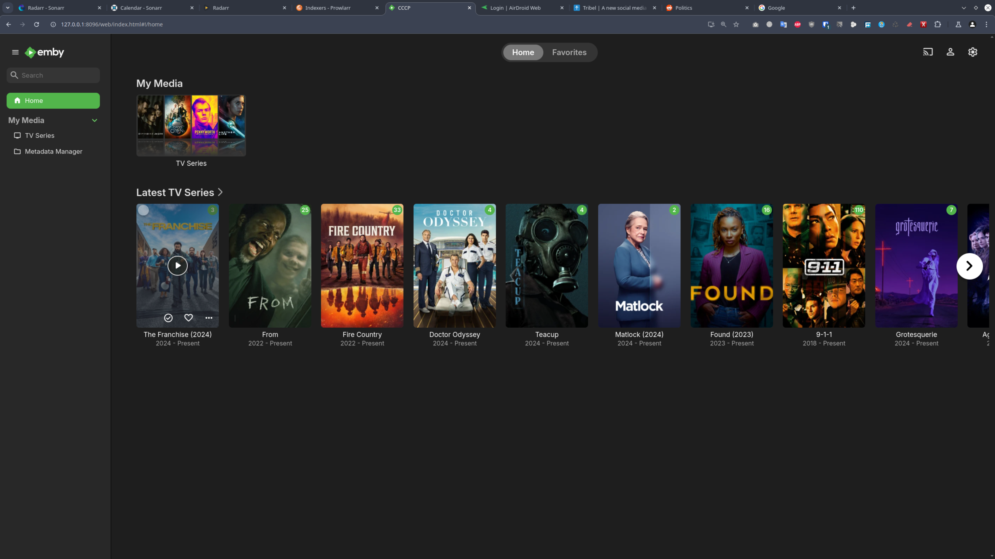

IAmHugh 64 Posted October 21, 2024 Author Posted October 21, 2024 @Lukehere is a image from my install in Arch and you can see I have the buttons on the bottom of the preview images.

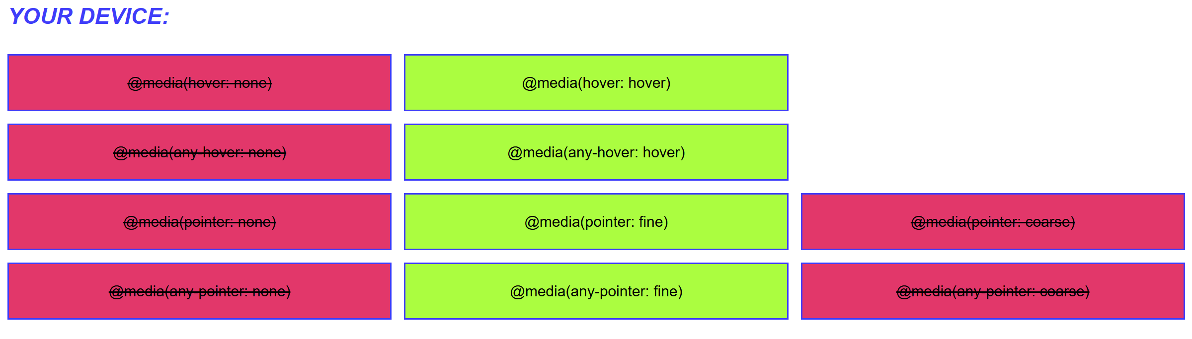

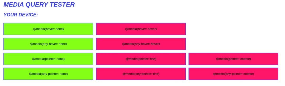

Luke 42243 Posted October 31, 2024 Posted October 31, 2024 How does this page look for you in the your device section: https://hover-pointer-media-query.glitch.me/ It should look like this: Otherwise the browser is reporting that your primary input method is touch, and the Emby Web UI adjusts based on that.
Luke 42243 Posted November 10, 2024 Posted November 10, 2024 @CummingCowGirlare you still having an issue with this? Based on that screenshot, the browser is reporting that you're not using a mouse and that's why the Emby user interface is adjusting based on that.
Luke 42243 Posted November 16, 2024 Posted November 16, 2024 On 11/10/2024 at 6:52 PM, CummingCowGirl said: See my last post. Hi, yes I did see your last post, and this is the reason for your issue.
