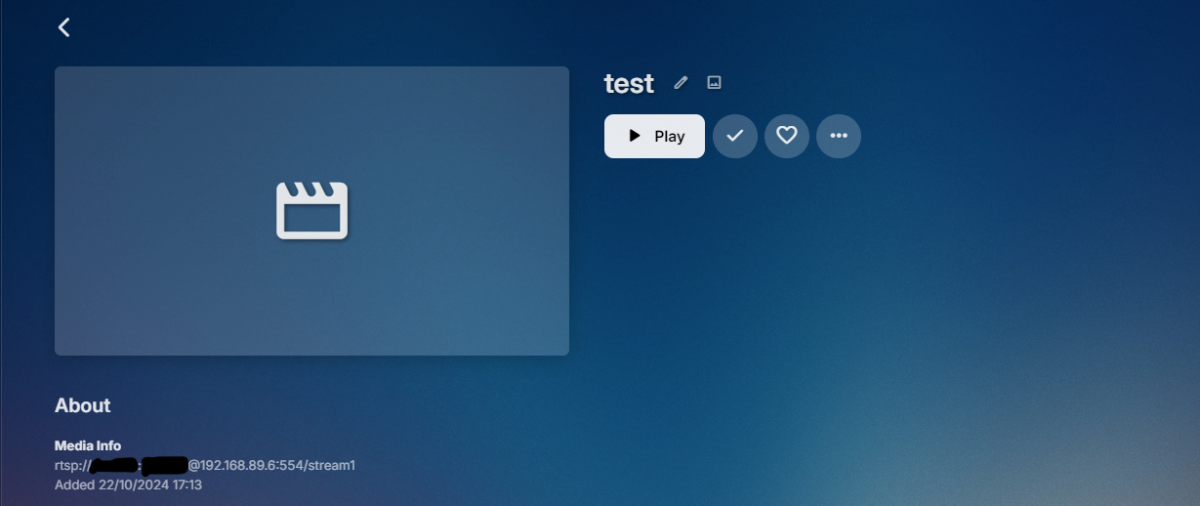

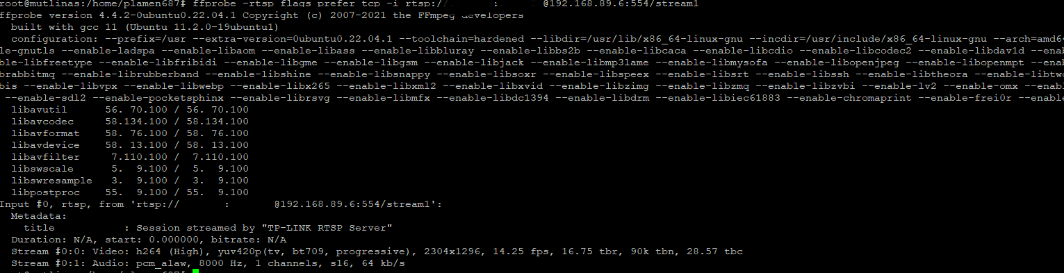

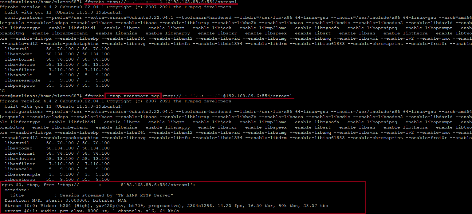

plamen6877 2 Posted October 18, 2024 Posted October 18, 2024 (edited) Hi, i have rtsp stream, which is not playable with security cams plugin In vlc on windows works perfect. My emby is on ubuntu server. I found that, when i try ffmpeg -i rtsp://user:pass@10.10.10.10:554/example_stream not working, but when i add "-rtsp_transport tcp" ffmpeg works. So in emby logs i saw, that "-rtsp_transport tcp" is missing and maybe that is the problem. Can someone help with this issue? Edited October 18, 2024 by plamen6877

plamen6877 2 Posted October 22, 2024 Author Posted October 22, 2024 Hi, here is screenshots from emby, from linux terminal with ffprobe and emby log. Thanks for reply! embyserver.txt
