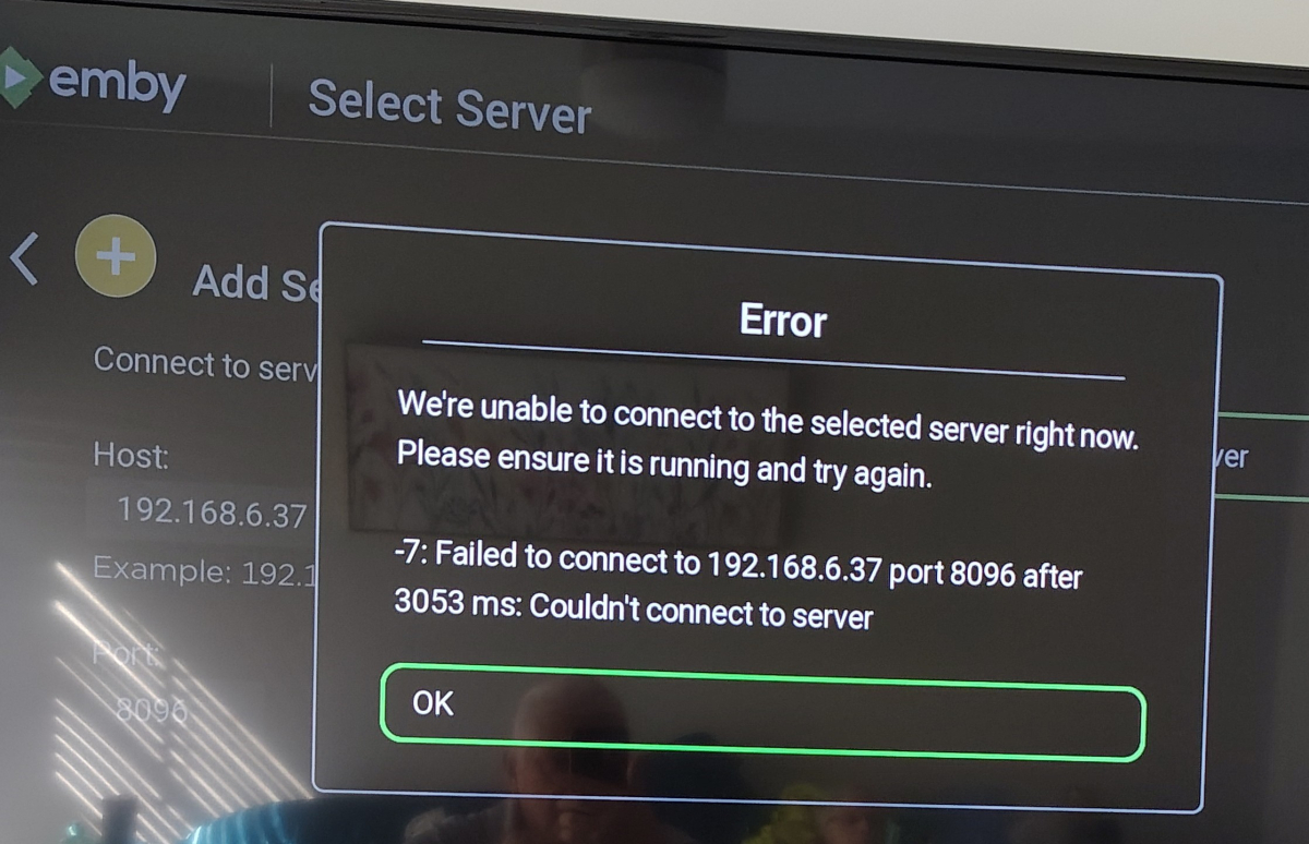

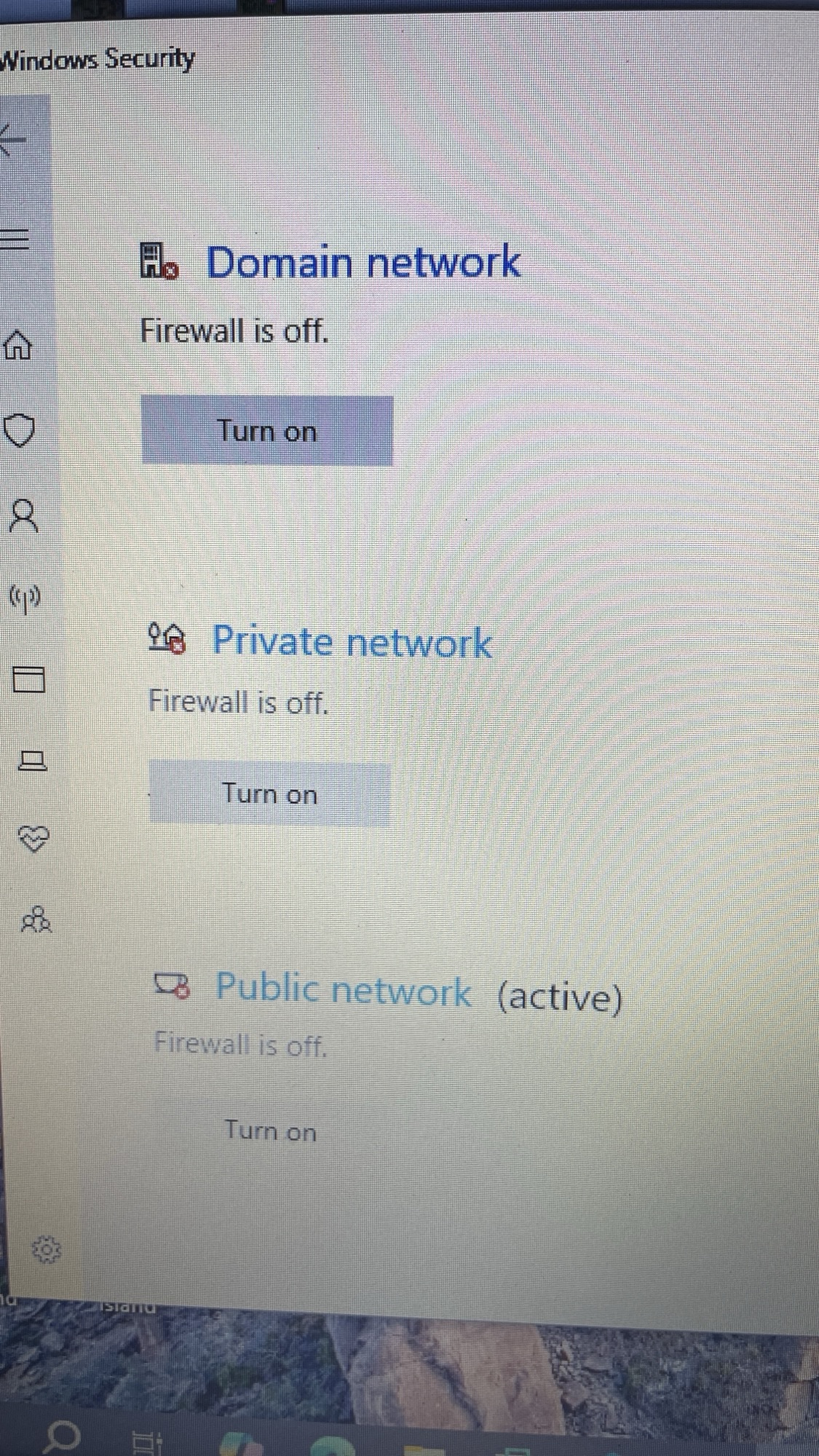

markie 2 Posted October 20, 2024 Posted October 20, 2024 (edited) Similar , but not same problem here. MY local network IS connected to internet BUT when I open the Emby app on my roku (V4.1 build 26) I was able to verify a firewall issue on my server (192.168.6.37), and I also did (trouble-shot myself...) disable, and then make sure the firewall off/then on with a private network was set ok I was then able to get into emby from any pc on my network. BUT: HERE's where my problem differs: 1) my roku tv IS online. 2) it shows a valid IP address on the SAME network. 3) it was working fine for a period of time. (server hasn't changed) 4) I just got off the phone with Roku support. THey had me: reset tv power reset entire Roku verify network still same situation. SO, I still have no connectivity on my roku and I have no idea where to look now (Firewall on server is OFF can get to server/emby from any other place on the local net ideas?? thanks in advance Edited October 20, 2024 by markie
Luke 42239 Posted November 7, 2024 Posted November 7, 2024 Hi @markieare you still having an issue with this? Are you sure the LAN ip address that you're trying to connect to is correct?
