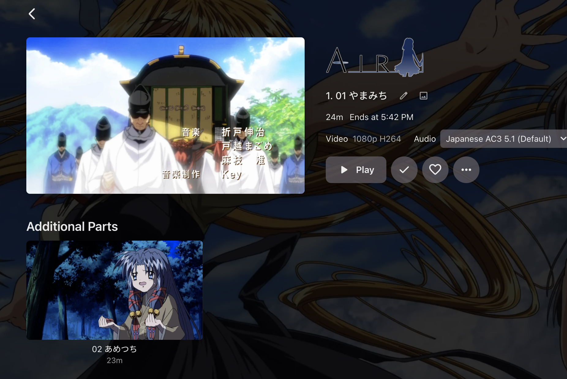

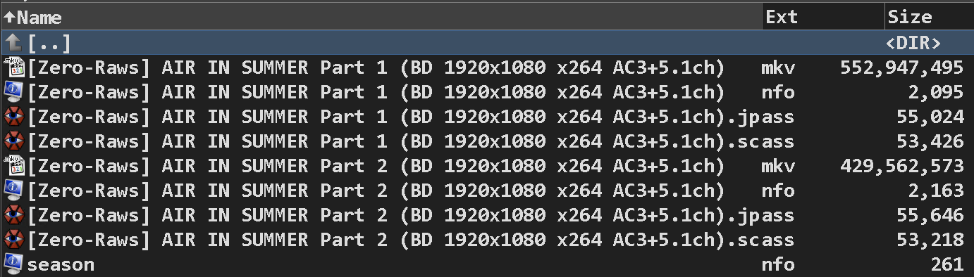

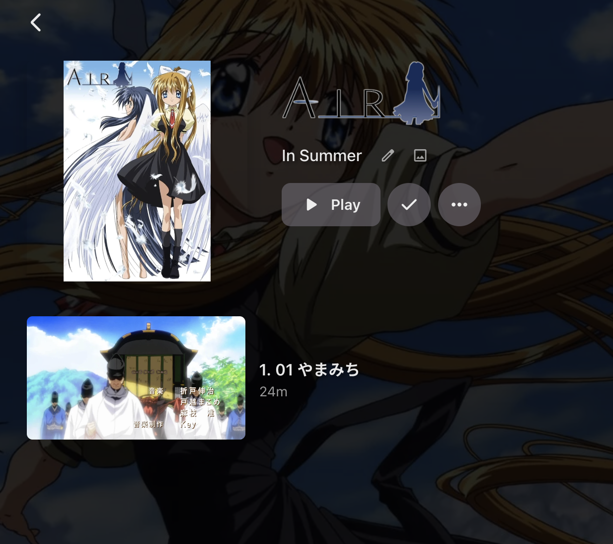

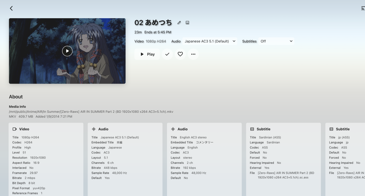

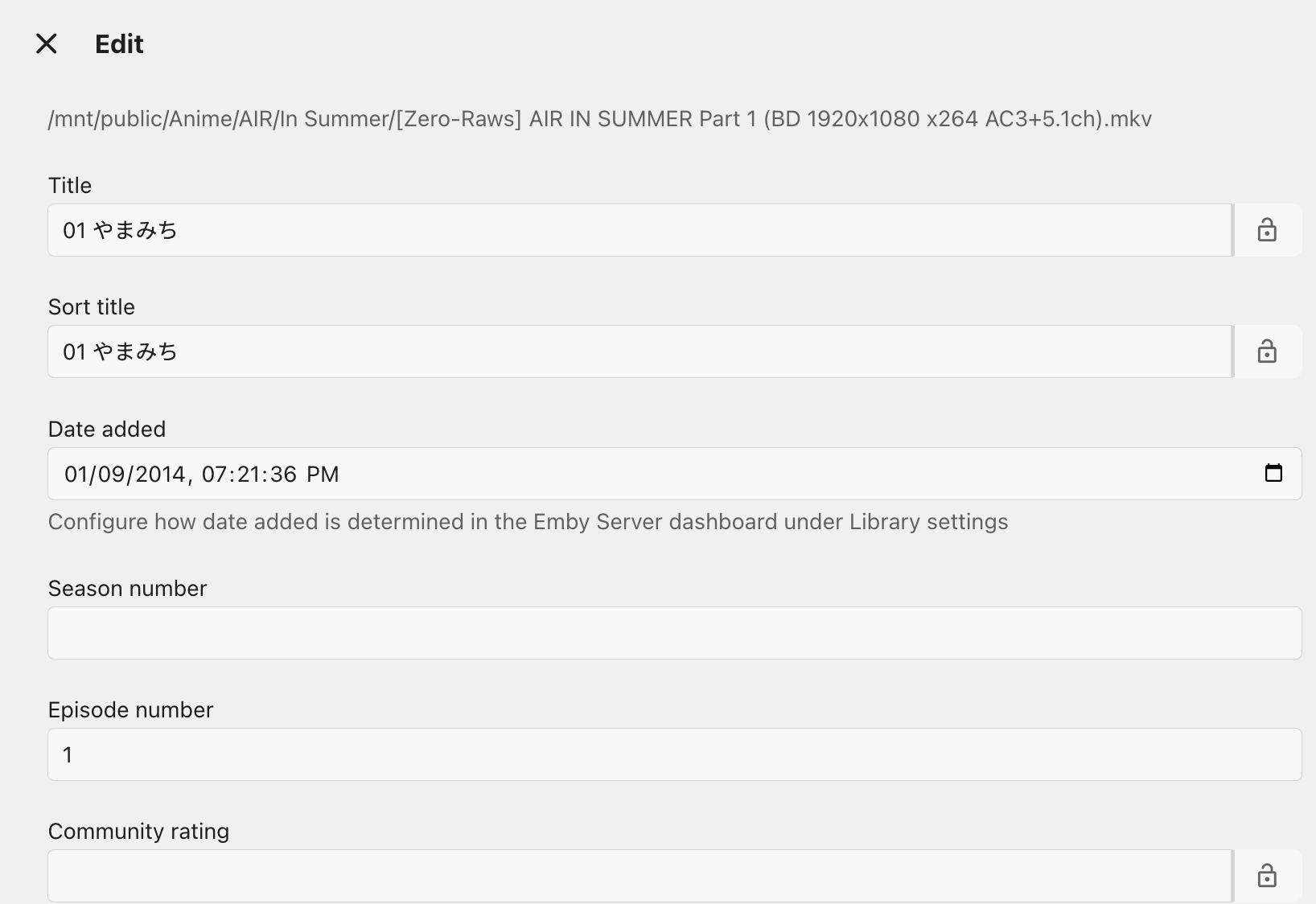

scegg 12 Posted October 17, 2024 Posted October 17, 2024 Hi. I have an anime which has several seasons. In one season, there is 2 video files. Emby recognized the 1st one but show the 2nd one as additional part under the 1st one. How to fix that? Tried to delete the whole library and rebuilt, still the same. In Emby, the season displayed like: Enter the 1st file, the view is: The folder contains these 2 files is: These 3 nfo files are also attached here. Any idea? Thanks a lot. [Zero-Raws] AIR IN SUMMER Part 1 (BD 1920x1080 x264 AC3+5.1ch).nfo [Zero-Raws] AIR IN SUMMER Part 2 (BD 1920x1080 x264 AC3+5.1ch).nfo season.nfo

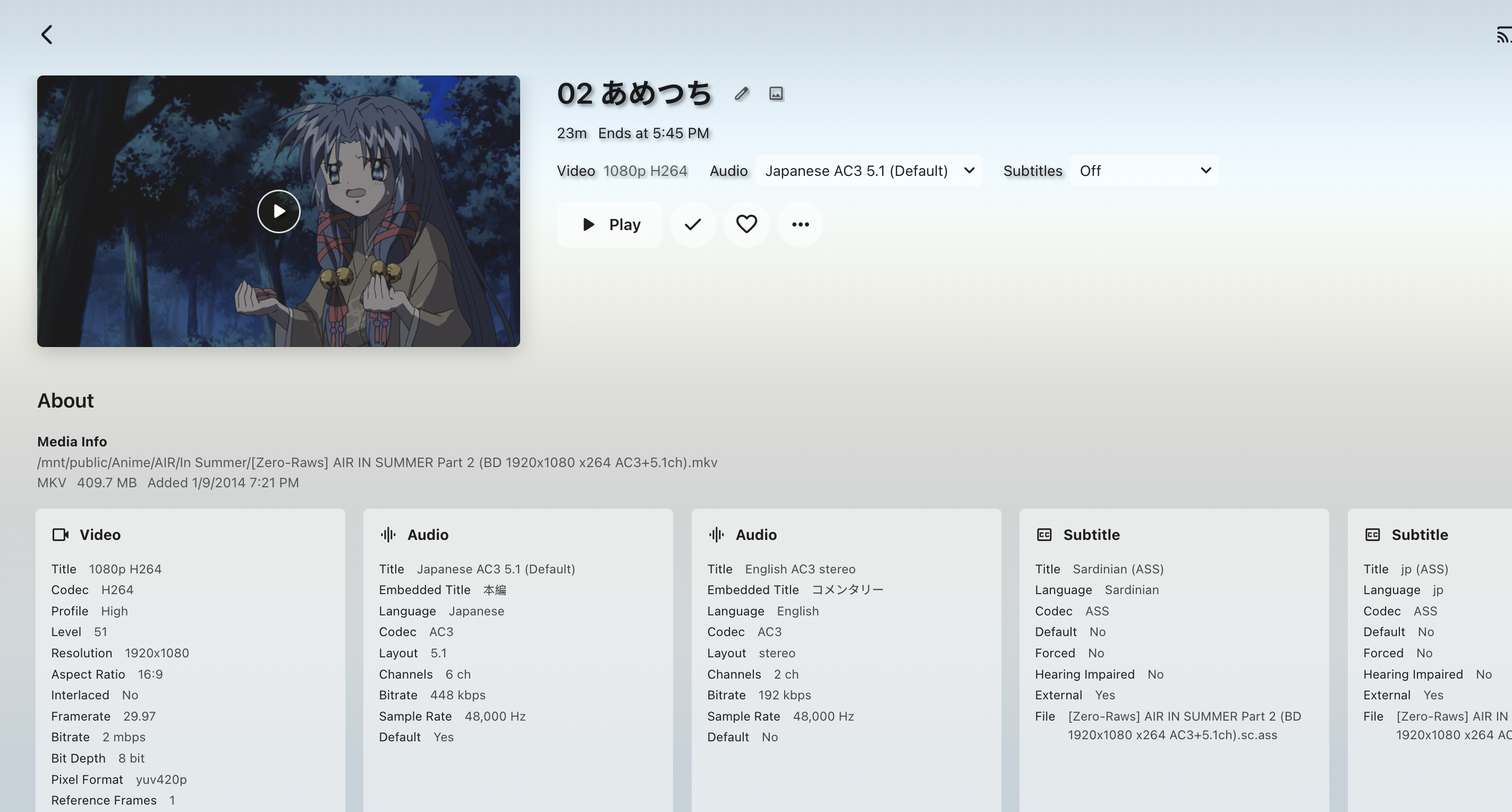

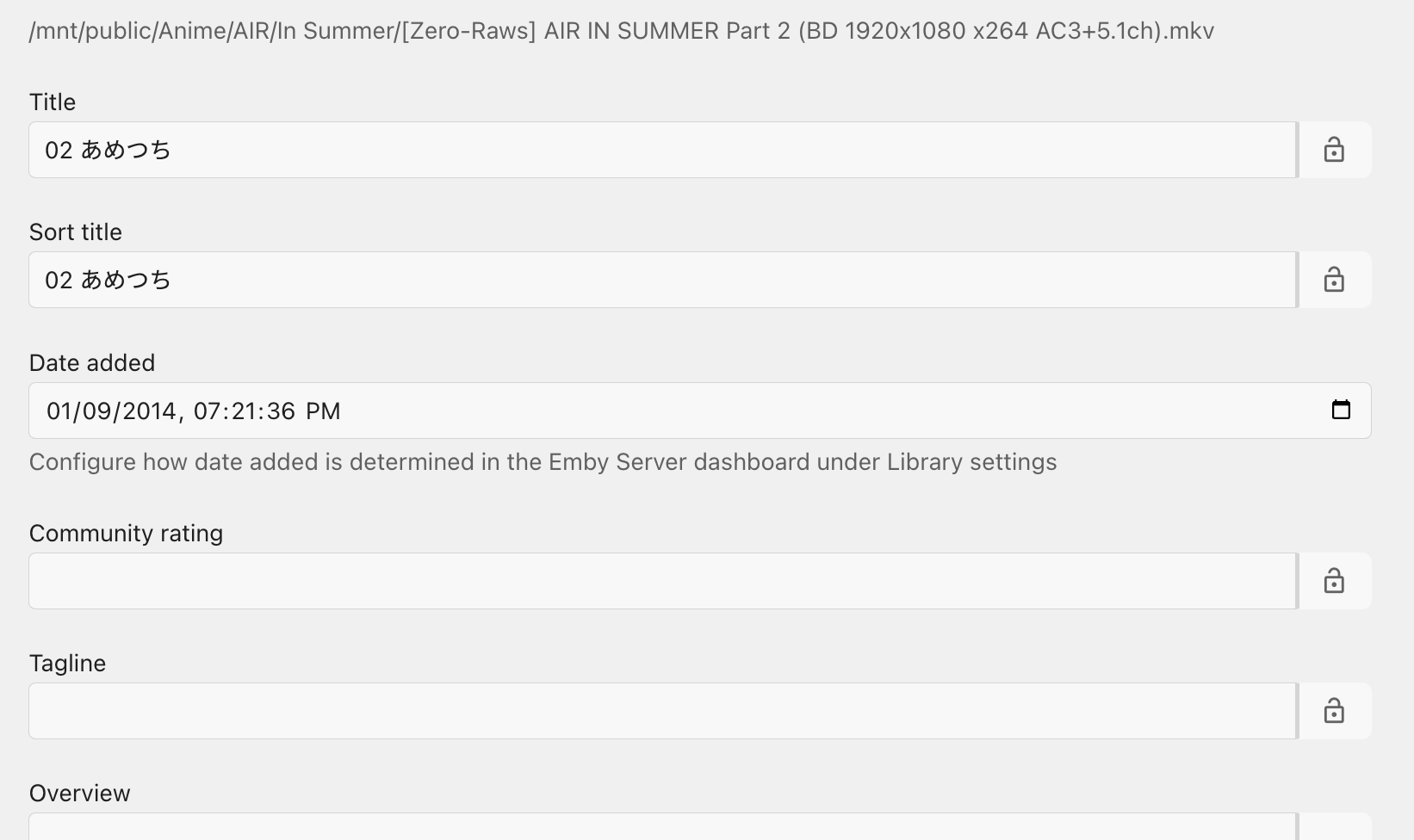

scegg 12 Posted October 17, 2024 Author Posted October 17, 2024 Additional, the metadata of the 1st part in emby: The view of 2nd file: The metadata of the 2nd file:

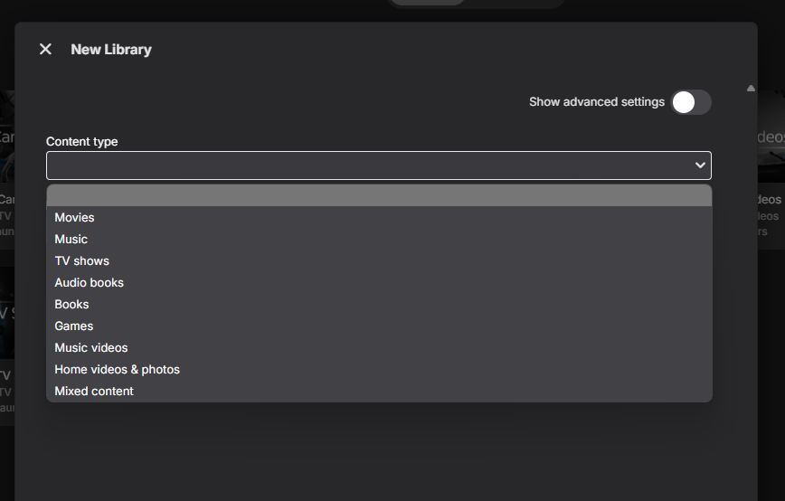

scegg 12 Posted October 17, 2024 Author Posted October 17, 2024 3 minutes ago, Neminem said: What library type is selected ? It’s a mixed content library. And all files are NFO described. Naming problem even cannot be ignored with NFO specified?
Neminem 1592 Posted October 17, 2024 Posted October 17, 2024 No that i know of. With mixed library, naming is even more important. 1

scegg 12 Posted October 18, 2024 Author Posted October 18, 2024 (edited) 11 hours ago, Luke said: Let us know how you get on. Thanks. Just changing the NFO file name and pointing to video files by original_filename wont fix the problem. It seems that Emby list all video files before reading NFO files. Only the NFO file name same as video file will be processed and the original_filename node in NFO is ignored. Edited October 18, 2024 by scegg

Happy2Play 9798 Posted October 20, 2024 Posted October 20, 2024 Issue is how the server treats anything named PART 1 thru 9 per file stacking rule. So you need to modify the naming scheme if they are not actually parts to a single item so ie part one, part two or use capital i instead of 1. But as a Series you also need to look at organization and naming scheme to be considered TV and not Movie.
Luke 42184 Posted October 20, 2024 Posted October 20, 2024 On 10/18/2024 at 12:28 AM, scegg said: Only the NFO file name same as video file will be processed and the original_filename node in NFO is ignored. Hi, yes this is correct. This may change in future updates, but for the best possible experience I would recommend joining the files together.
scegg 12 Posted October 24, 2024 Author Posted October 24, 2024 On 10/21/2024 at 1:52 AM, Luke said: Hi, yes this is correct. This may change in future updates, but for the best possible experience I would recommend joining the files together. Not possible. The part X is some naming rule from the sources. For seeding reason, it cannot be renamed, nor joined. For example: BBC Horizon sometimes separate a topic into several pieces and broadcast them in different months. In this case, they will include part x in the name. Now I wrote a script to make junction files from those original and place them into the right folder structure with the name obeyed Emby rules so far. Waiting for Emby further improvement from reading NFO...
