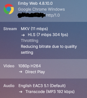

JohnMason1 2 Posted October 15, 2024 Posted October 15, 2024 (edited) I am trying to understand what Emby is doing here and hopefully confirm it's not reducing video quality. My cousin is currently watching an episode, and the dashboard shows me this: His account is set to NOT allow video transcoding, but to allow audio transcoding and container changes. So, the way I understand it is, Emby is changing the container (does Chrome not support MKV?), and also transcoding the Audio (lack of Chrome support for EAC? necessary because he only has 2 speakers and not a 5.1 system?). But, why does it say "reducing bitrate due to quality setting"? The video is direct-playing, and EAC audio is usually less than 1Mbps, so why the reduction by 4Mbps? Edited October 15, 2024 by JohnMason1

JohnMason1 2 Posted October 16, 2024 Author Posted October 16, 2024 18 hours ago, visproduction said: Then if the video mbps from the original media is somewhat high for the connection and user's hardware, than that would be transcoded to fit the throughput and hardware that is tested on connection. Hmm that shouldn't happen though as that user's account is set not to transcode video, and also Emby does indicate that the video is direct-playing. If it's direct playing, there should be no change in the bitrate, right? I understand many (most?) browsers don't support EAC audio and it makes sense for the audio only to be transcoded. Plex does the same thing (and I believe Jellyfin too, but Jellyfin's transcoding/directplaying indications are a mess), and it does not reduce (nor says it reduces) the bitrate. To be clear, I don't think the video bitrate is reduced, and I don't think the video is transcoded. The server load remains very low, nothing like when it's transcoding. I think at this stage it might be that Emby is incorrectly showing this message.
rbjtech 5335 Posted October 16, 2024 Posted October 16, 2024 1 hour ago, JohnMason1 said: Hmm that shouldn't happen though as that user's account is set not to transcode video, and also Emby does indicate that the video is direct-playing. If it's direct playing, there should be no change in the bitrate, right? I understand many (most?) browsers don't support EAC audio and it makes sense for the audio only to be transcoded. Plex does the same thing (and I believe Jellyfin too, but Jellyfin's transcoding/directplaying indications are a mess), and it does not reduce (nor says it reduces) the bitrate. To be clear, I don't think the video bitrate is reduced, and I don't think the video is transcoded. The server load remains very low, nothing like when it's transcoding. I think at this stage it might be that Emby is incorrectly showing this message. Agreed - it's the reason that is incorrect. Technically you are 'transcoding' even if it's just the audio that is being changed - as AV is interleaved - it just means that a 'copy' process is done to video stream, as opposed to re-encode. 1
Solution Luke 42184 Posted October 16, 2024 Solution Posted October 16, 2024 Quote reducing bitrate due to quality setting Actually what's happening here is this label is just incorrect. It's a quirk that's happening with your combination of user restrictions. It's something that needs to be looked at. 2 1
