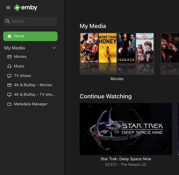

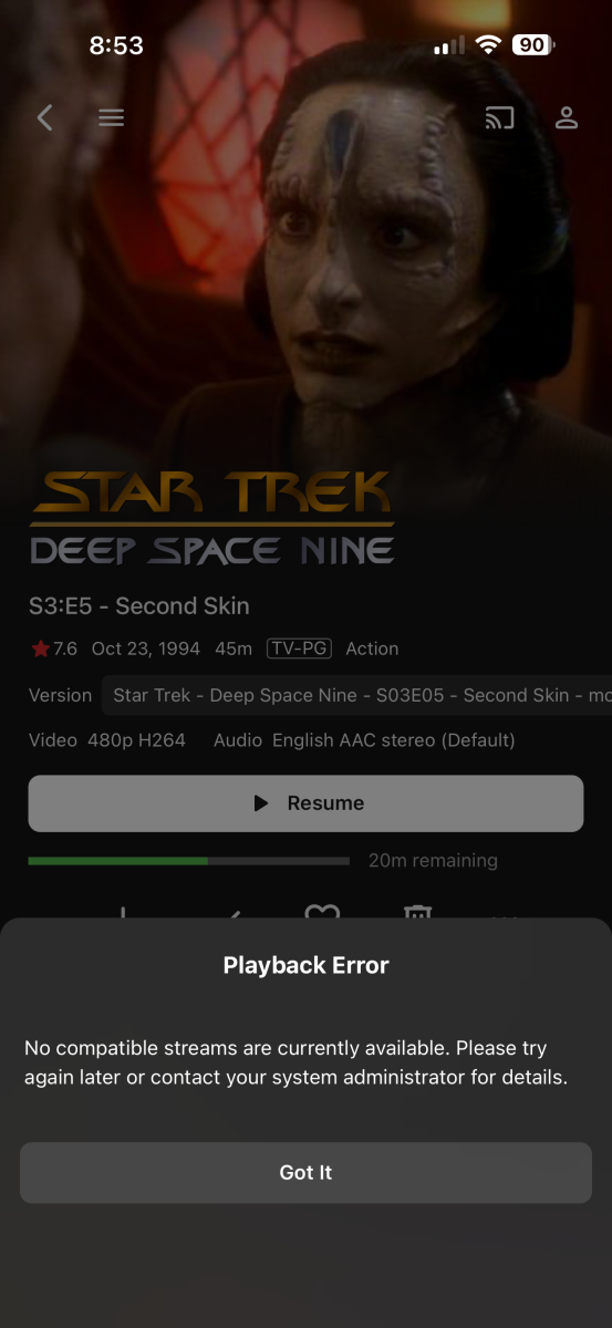

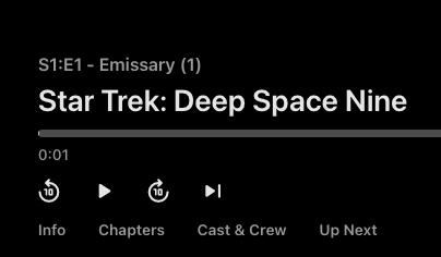

dyecast 6 Posted December 31, 2024 Author Posted December 31, 2024 (edited) Another odd error on the LAN side. If I click on a TV show that is for a specific episode I was watching earlier, it's taking me back to S1E1. See attached. Edited December 31, 2024 by dyecast
dyecast 6 Posted December 31, 2024 Author Posted December 31, 2024 Clearing all browser cache has no impact. The error appears to be server side.

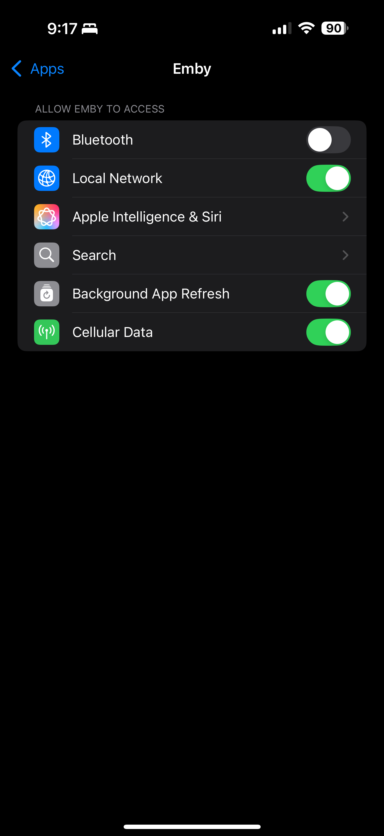

Luke 42239 Posted December 31, 2024 Posted December 31, 2024 3 minutes ago, dyecast said: LAN side. iPhone. Sooo weird I would check that the Emby iOS app is being allowed local network permissions.
dyecast 6 Posted December 31, 2024 Author Posted December 31, 2024 (edited) 1 minute ago, Luke said: I would check that the Emby iOS app is being allowed local network permissions. It does because it can play other shows, music, etc. It's an intermittent problem across all media. I just happen to catch it on this one. It's happened on the WAN side too, but this was a first on the LAN. Edited December 31, 2024 by dyecast
Luke 42239 Posted December 31, 2024 Posted December 31, 2024 Hi, please check it anyway and provide a screenshot of what you find. Thanks.
dyecast 6 Posted December 31, 2024 Author Posted December 31, 2024 4 minutes ago, Luke said: Hi, please check it anyway and provide a screenshot of what you find. Thanks.

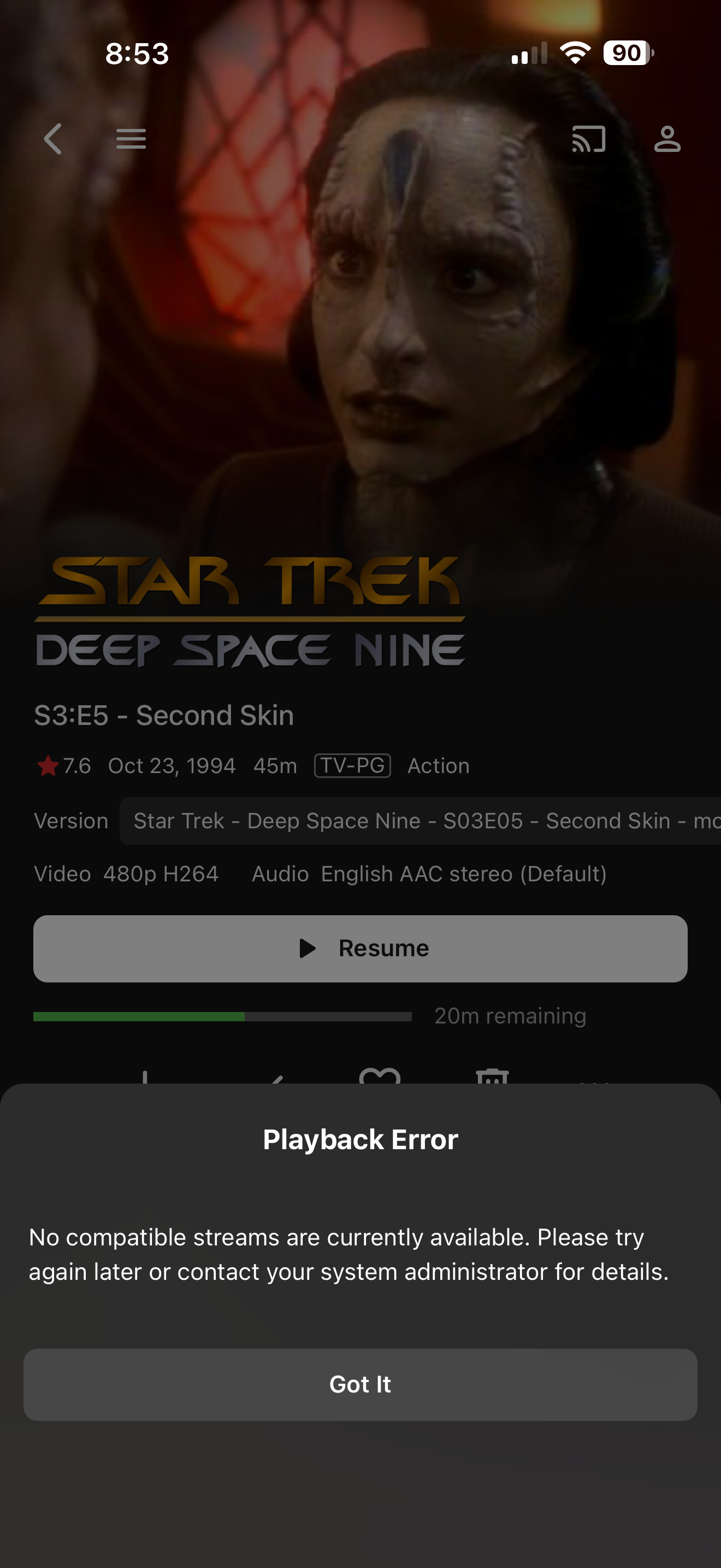

dyecast 6 Posted December 31, 2024 Author Posted December 31, 2024 14 hours ago, Luke said: I would check that the Emby iOS app is being allowed local network permissions. I’m now getting that same error message on the same episode from the WAN side. iPhone.
Carlo 4561 Posted January 3, 2025 Posted January 3, 2025 Hi @dyecast Hi, this only happens on certain files but not all media files, correct? What I've found over the years, is that a resume that fails to start where you left off (or causes strange things) are corrupted or weren't created properly. Often, they can be played if transcoded or remuxed. Try running any problem files through mkclean and see if this fixes the issue. https://www.matroska.org/downloads/mkclean.html Carlo
