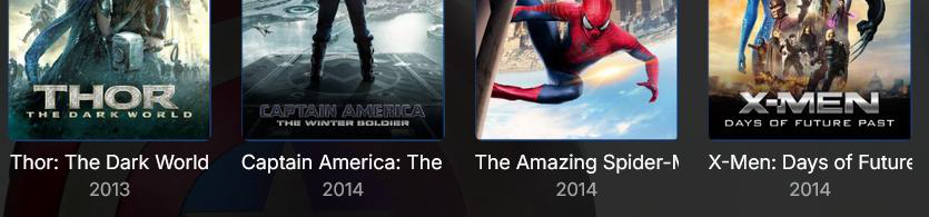

ironspider 1 Posted October 14, 2024 Posted October 14, 2024 so, i finally got my server up and going but, i can't figure out how to modify the font size and word wrapping for the titles under the poster display. My CSS skills are about zero.. can some point me in the right direction as to how i can tweak those? at least i'm assuming that its only thru the custom CSS option..unless there is a setting that can do it for me?

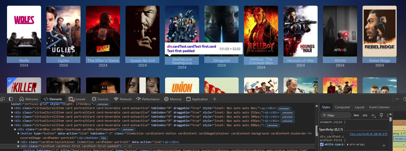

Happy2Play 9811 Posted October 14, 2024 Posted October 14, 2024 (edited) Something like this for card text. div.cardText.cardText-first { white-space: pre-wrap; } As for font size you can play with font-size as this is the overall default. html {font-size: 90.15%} So depends on if you want to adjust font everywhere or just specific areas? But if your bring up the browser debug console (F12) you can navigate the elements or find what is applied to a specific element. Edited October 14, 2024 by Happy2Play 1
Solution ironspider 1 Posted October 14, 2024 Author Solution Posted October 14, 2024 Thank you, Happy2Play. Thats exactly what i was looking for. I appreciate your time on this.
