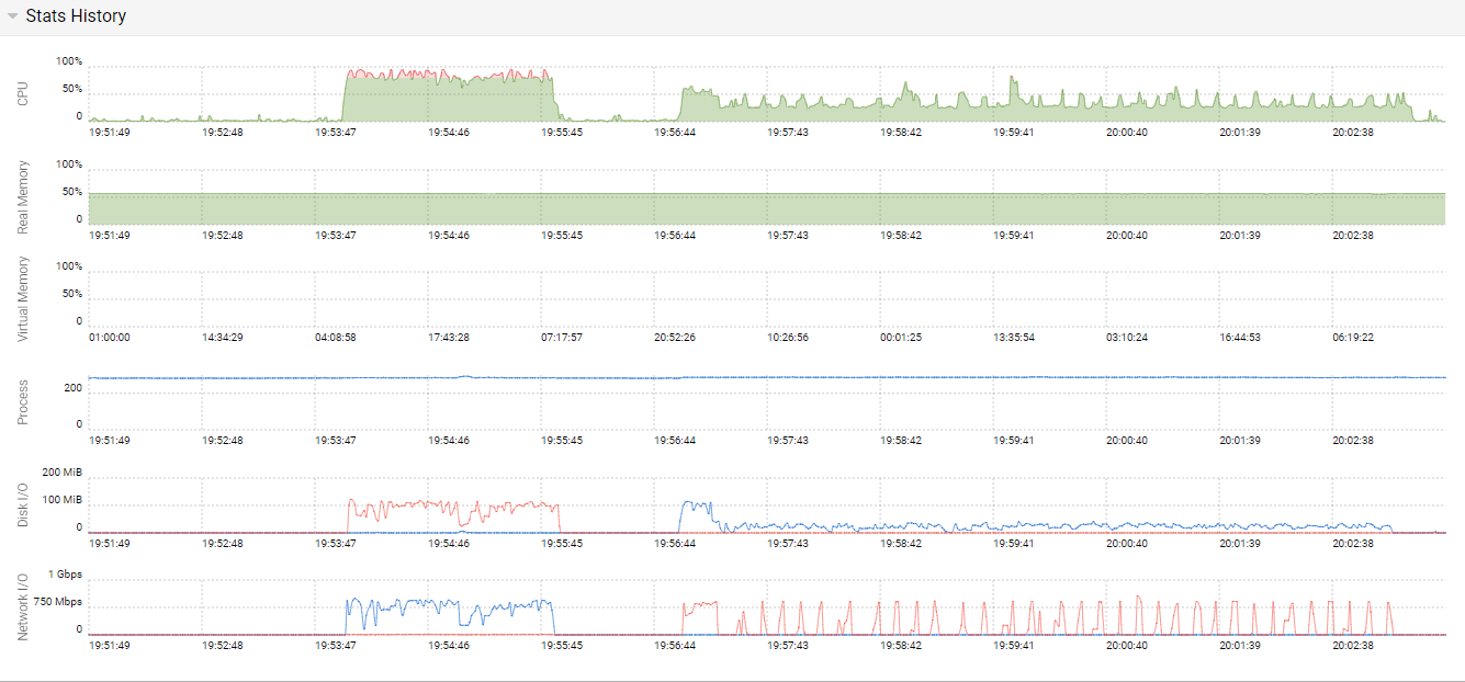

nedge2k 0 Posted October 14, 2024 Author Posted October 14, 2024 (edited) Wondering if this is an issue writing to the Windows Server... Just transferred 10GB from it, decent performance. Transferred the same file back and it's like its buffering constantly? If I copy to my laptop from the windows server I get a sustained ~50MB/s over wifi. If I copy back I get a sustained 30MB/s. So there is a performance drop in writing to the Windows server (might be storage spaces related) but the drop isn't as bad as copying from the RPi to it. Edited October 14, 2024 by nedge2k
