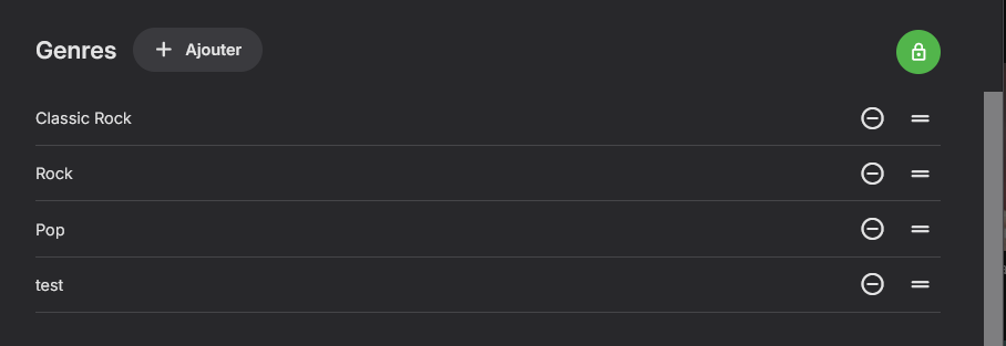

Hello,
On a playlist :
Initial :
I add a genre :
and save

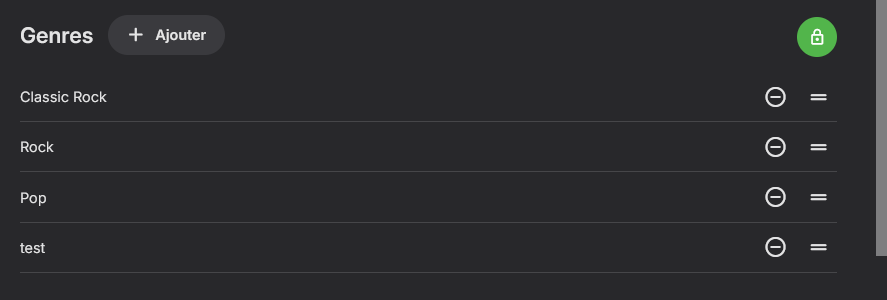

If i reopen the playlist genre is here :
waiting for 5 min approx. without any actions on emby :
genre has disapperred
help :)

That can be an explanation yes. But with the 'lock' activated it should not get deleted ?

Hi, currently playlist genres are automatically set based on the genres of the items in the playlist. We'll update this to not happen when the genres are locked.
I wouldn't recommend it though as you'll be required to manually handle them as you add and remove from the playlist.
