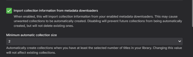

Neminem 1630 Posted October 13, 2024 Posted October 13, 2024 Either you have this enabled in your library. Or Collections are in your nfo files.

Mikexx 1 Posted October 13, 2024 Author Posted October 13, 2024 29 minutes ago, Neminem said: Either you have this enabled in your library. Or Collections are in your nfo files. Many thanks. Now turned off. Where are these nfo files? Can I manually edit or delete them?

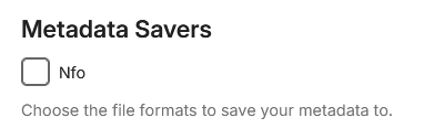

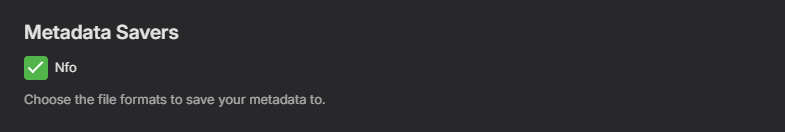

Neminem 1630 Posted October 13, 2024 Posted October 13, 2024 Do you have this enabled in your library ?
Mikexx 1 Posted October 13, 2024 Author Posted October 13, 2024 8 minutes ago, Neminem said: Do you have this enabled in your library ? No, it's unticked.
Neminem 1630 Posted October 13, 2024 Posted October 13, 2024 11 minutes ago, Neminem said: ok what is creating those nfo files ? Just quoting myself here ?

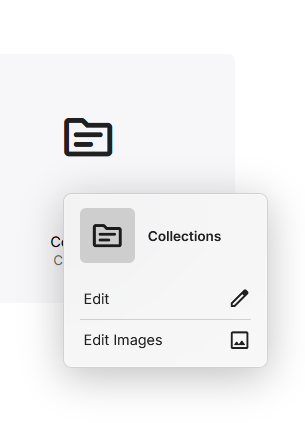

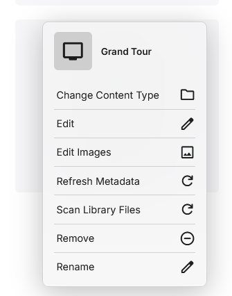

Neminem 1630 Posted October 14, 2024 Posted October 14, 2024 @Happy2Playdo you remember how to remove collection library. @Mikexxwhere do you see the collections, just to be sure where they still are present. Screenshots please
Mikexx 1 Posted October 14, 2024 Author Posted October 14, 2024 This is the normal Home folder Now in Settings > Library Right click on Collections folder Right click on another folder What do you need to see? 1
