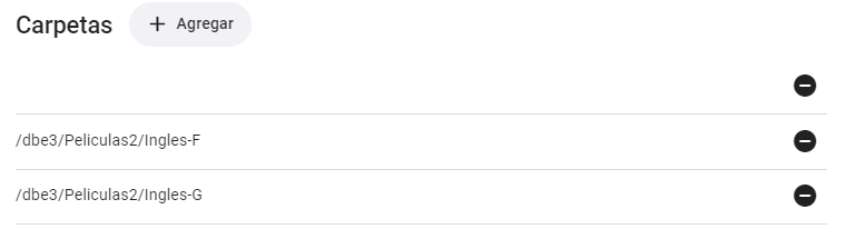

MaxMax 0 Posted October 12, 2024 Posted October 12, 2024 I have library that contains 3 folders. The problem is that I got the first folder without path like the picture and I can't remove from the library. The main problem is that the folder is empty actually it does not exist on the server and the movies keep showing on the emby server, of course cant be played... I won't delete the Library... any way to fix this? I tryied to edit the .xml file on /emby/root/../movies/options.xml but have not succes... thanks in advance

MaxMax 0 Posted October 12, 2024 Author Posted October 12, 2024 <PathInfos> <MediaPathInfo> <Path>/dbe3/Peliculas2/Ingles-G</Path> </MediaPathInfo> <MediaPathInfo> <Path>/dbe3/Peliculas2/Ingles</Path> </MediaPathInfo>
GrimReaper 4843 Posted October 12, 2024 Posted October 12, 2024 Just to confirm, are you positive you're looking at the correct library options.xml? As per your screenshot you have \Ingles-F and \Ingles-G folders as library paths: 19 minutes ago, MaxMax said: Whereas your options.xml file lists different set of folders: \Ingles-G and \Ingles?

Solution MaxMax 0 Posted October 13, 2024 Author Solution Posted October 13, 2024 (edited) I just resolve this issue sending request tru the api.. But the team must check this bug. Ussing python and post to this url: http://server:port/emby/Library/VirtualFolders/LibraryOptions?X-Emby-Token=[EMBY-API-KEY]&reqformat=json Data: {"Id":"4975","LibraryOptions":{"EnableArchiveMediaFiles":false,"EnablePhotos":true,"EnableRealtimeMonitor":false,"EnableMarkerDetection":false,"EnableMarkerDetectionDuringLibraryScan":false,"IntroDetectionFingerprintLength":10,"EnableChapterImageExtraction":false,"ExtractChapterImagesDuringLibraryScan":false,"DownloadImagesInAdvance":false,"CacheImages":false,"PathInfos":[{"Path":"/dbe3/Peliculas2/Ingles-F"},{"Path":"/dbe3/Peliculas2/Ingles-G"}],"IgnoreHiddenFiles":false,"IgnoreFileExtensions":[],"SaveLocalMetadata":false,"SaveMetadataHidden":false,"SaveLocalThumbnailSets":false,"ImportPlaylists":true,"EnableAutomaticSeriesGrouping":true,"ShareEmbeddedMusicAlbumImages":true,"EnableEmbeddedTitles":false,"EnableAudioResume":false,"AutoGenerateChapters":true,"AutomaticRefreshIntervalDays":0,"PlaceholderMetadataRefreshIntervalDays":0,"PreferredMetadataLanguage":"","PreferredImageLanguage":"","ContentType":"movies","MetadataCountryCode":"","MetadataSavers":["Nfo"],"DisabledLocalMetadataReaders":[],"LocalMetadataReaderOrder":["Nfo"],"DisabledLyricsFetchers":[],"SaveLyricsWithMedia":true,"LyricsDownloadMaxAgeDays":"0","LyricsFetcherOrder":[],"LyricsDownloadLanguages":[],"DisabledSubtitleFetchers":["Open Subtitles"],"SubtitleFetcherOrder":["Open Subtitles"],"SkipSubtitlesIfEmbeddedSubtitlesPresent":false,"SkipSubtitlesIfAudioTrackMatches":false,"SubtitleDownloadLanguages":[],"SubtitleDownloadMaxAgeDays":"0","RequirePerfectSubtitleMatch":false,"SaveSubtitlesWithMedia":true,"ForcedSubtitlesOnly":false,"HearingImpairedSubtitlesOnly":false,"TypeOptions":[{"Type":"Movie","ImageFetchers":[],"ImageFetcherOrder":["Image Capture"],"ImageOptions":[]}],"CollapseSingleItemFolders":true,"EnableAdultMetadata":false,"ImportCollections":false,"MinCollectionItems":2,"MinResumePct":"3","MaxResumePct":"90","MinResumeDurationSeconds":"120","ThumbnailImagesIntervalSeconds":"10","SampleIgnoreSize":314572800,"EnableInternetProviders":true,"ImportMissingEpisodes":false,"MusicFolderStructure":null}} Just edit the Json array and delete the "Path": "" that was incorrect... Edited October 13, 2024 by MaxMax

MaxMax 0 Posted October 13, 2024 Author Posted October 13, 2024 Just to inform that the "solution" does not work, I still having the same problem, I have a lot of items what even exist on the server, the Library Settings now shows only 2 paths but the Library still loaded with items that no longer exist...
