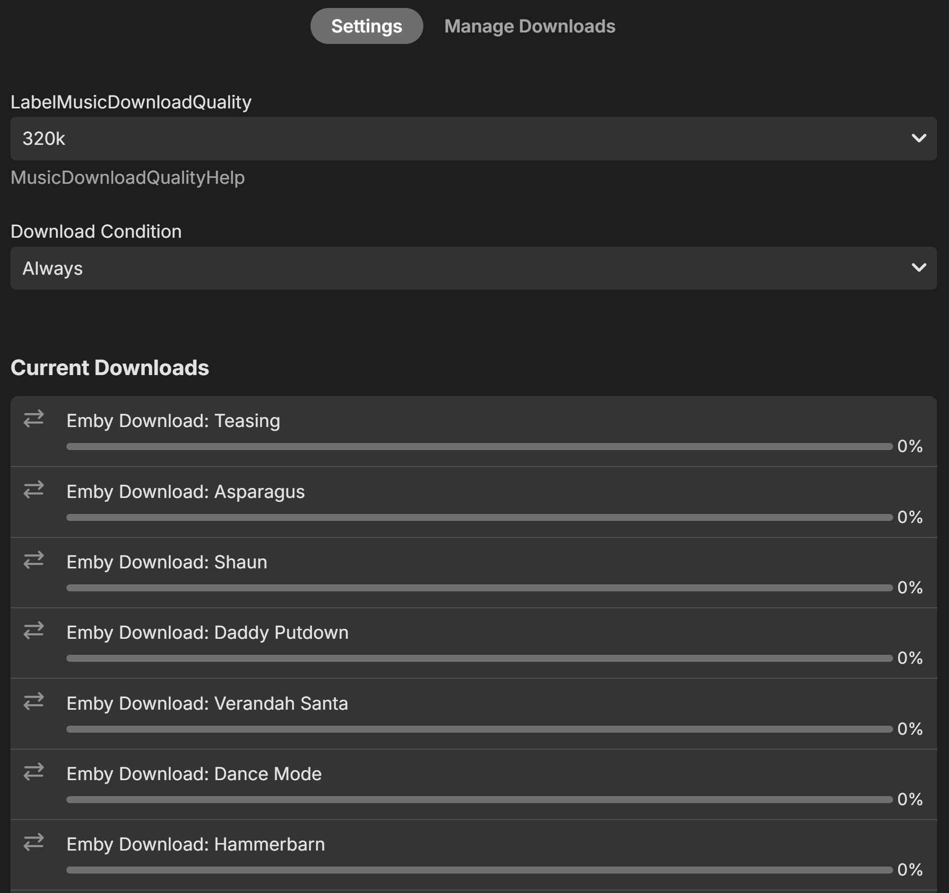

pbathuk 20 Posted October 12, 2024 Posted October 12, 2024 I am using the latest emby beta, however this happened before the beta as well. If I use the download function to have some offline movies / shows etc, when downloading a larger show (I will use Bluey for this, as it has 154 items, across 3 seasons), it will work perfectly, converting & transfering up to a point and then just sit on the "Awaiting Transfer" and does not seem to move on. I have tried leaving for hours and nothing moves forwards, however sometimes it can be 5 minutes and get a little spike of activity, then nothing for ages again, but if I, on the client itself, click into manage downloads, click into the show and click Save it starts the transfer for a little bit longer. Observations from myself : It seems to get "stuck" once all the conversion tasks are completed, but there are a backlog of transfers, in my case the conversions of the 154 does not take long, but the transfer also does not take long (1gbps wifi connection gets saturated when it is working). I have so far tried: Whole show in one go - seems to get "stuck" around the 30% mark for me. Click Save will work to an extent, but is very manual. Every so often some will transfer (Just noticed after 5 minutes I just had a couple more episodes transfer). Downloading each season (50 ish episodes per season) doing all at the same time seems to get "stuck" after season 1 has completed (all conversions have completed as well). Click Save on the next season sparks it off again.. and then it pauses for a minute, but started back up again 1 minute later, then pauses again. Downloading each season but not at the same time - so waiting for season 1 to complete and then doing season 2 etc Season 2 seemed to get stuck... which is weird. After seeing that it was Season 2 getting stuck I then deleted the request for Season 2 and started Season 3 - incase it was a file in Season 2 that was causing this... So I have Season 1 (finished and no restarting / pauses noticed) Season 2 "stuck" - removed request Season 3 "stuck" as well - seemed to follow the same as Season 2 - gets to a few episodes in and then stalls. So I then thought I would try a different show, incase it was just this show that was causing it, so used Cuphead, which is only 36 items, but is split across seasons. For this I started with just downloading the whole show in one go The conversion - per show - did take longer than before, so there were natuaral pauses in transfer 100% completed with zero interventions Extra time taken because of conversions So multiple seasons appears to work Another test I have run - using my android phone, the latest Google Play app & downloading the whole of bluey I watched it transfer 90%+ until it said queued as it was waiting to convert the last 10% 100% converted & transfered without intervention.. infact I moved off the app and used something else while it was doing the last 10% Personally I would like the transfer to keep going until all shows are completed and it seems to be a notification issue from the client to the server.. I can only assume that its setup as a request from the client saying "hey i'm ready for item X" and the message gets lost so just sits there, as the server can't force the download to the client etc. Just sat on the client while doing a season by season check and saw the attached - so it seems like it is transfer alot in one go (when it can). Sorry for the long post - happy to provide logs etc, if someone can point me to where the windows client saves its logs for the beta version? Or if you want other testing completed.

pbathuk 20 Posted October 12, 2024 Author Posted October 12, 2024 So, from what I can whole show in one go is doing the same thing as before, its transfered some, but then because the conversions have finished it is now "stuck".. Going to attempt the open and save to see if that restarts everything and its just a weird one off issue. - It grabbed a few more and then sat on "ready to transfer" again i'm afraid. Happy to share logs if that helps?
