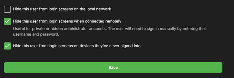

Neminem 1623 Posted November 4, 2024 Posted November 4, 2024 4 hours ago, yocker said: Wouldn't it be easier to just set 0.0.0.0/24 as considered local at that point? That would mess with these settings. 1
yocker 1414 Posted November 4, 2024 Posted November 4, 2024 1 hour ago, Neminem said: That would mess with these settings. It would but smaller problem than having to call all your family and friends you have given access to and explain them to set max quality. Something that's a problem to do to start with anyway. It was also meant more as a joke than any thing else, sorry i didn't communicate that properly. With that said though... I did actually test with that in my settings just for one day, didn't have one single complaint so i at least know now my users can handle what ever the server can trow at them, certainly more than "auto". For any one reading this: Use at your own risk, it will make it so that admin account is accessible from the internet no matter what settings you have, 1
ebr 16336 Posted November 4, 2024 Posted November 4, 2024 3 hours ago, Neminem said: That would mess with these settings. The only one of those that is really necessary/useful anymore is the third one. It covers both remote and local and makes no distinction - which is really the proper approach since we know local can be spoofed.
Jeryd 1 Posted November 5, 2024 Posted November 5, 2024 7 hours ago, ebr said: The only one of those that is really necessary/useful anymore is the third one. It covers both remote and local and makes no distinction - which is really the proper approach since we know local can be spoofed. Then can we get rid of the 1st 2 options?
