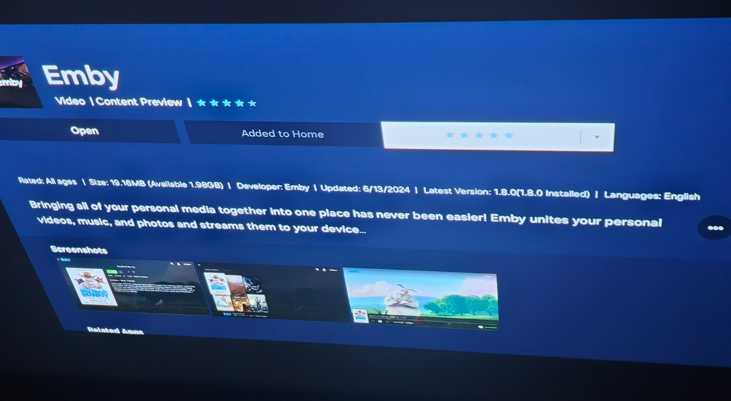

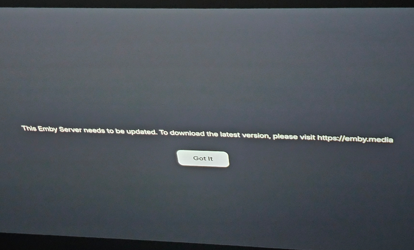

strikerdanny 1 Posted October 11, 2024 Posted October 11, 2024 i cant connect to my server or know how to install different version on it to work keeps saying server needs updating and to update app the app stores uses the tizen operating system and there is no update
Luke 42239 Posted October 11, 2024 Posted October 11, 2024 Hi there, what version of the Emby app do you have installed on it? What version of Emby Server do you have?
strikerdanny 1 Posted October 12, 2024 Author Posted October 12, 2024 this is what i have https://www.samsung.com/au/projectors/the-freestyle/lff3c-the-freestyle-2023-sp-lff3claxxxy/ there arent many apps on the app store and that app in picture is the only one thats available i have same issue on my samsung mobile phone s23 ultra i had to download version 3.3.56 to work or ill get the unable to connect the server needs to be updated please download the latest version then visit emby site obviously it wont work as im using the projectors samsung app store . i really need emby app to work . what do you mean what version of the server? i installed my server from my nas device wd pr2100 and the web page popped up on my windows browser and i added my library there it says Version 4.7.11.0
Luke 42239 Posted October 12, 2024 Posted October 12, 2024 Hi, are you able to update to Emby server 4.8?
jelica 0 Posted October 12, 2024 Posted October 12, 2024 (edited) How can u update i cant update mine also says 4.7.11.0 Edited October 12, 2024 by jelica Wrong
strikerdanny 1 Posted October 12, 2024 Author Posted October 12, 2024 How do i update it says its up go date
strikerdanny 1 Posted October 12, 2024 Author Posted October 12, 2024 ive done manual update on my nas pr2100 to version 4.9.0.30 now i cant login to my server on the webpage at all wtf why
Luke 42239 Posted October 12, 2024 Posted October 12, 2024 7 hours ago, strikerdanny said: ive done manual update on my nas pr2100 to version 4.9.0.30 now i cant login to my server on the webpage at all wtf why Hi there @strikerdanny We're sorry to hear about this. Happy to help. what exactly happens when you try to login?
strikerdanny 1 Posted November 7, 2024 Author Posted November 7, 2024 i updated software version and fixed it as you said 1
