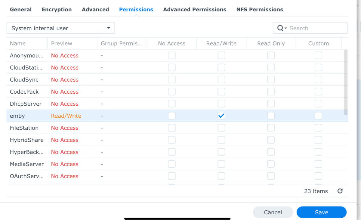

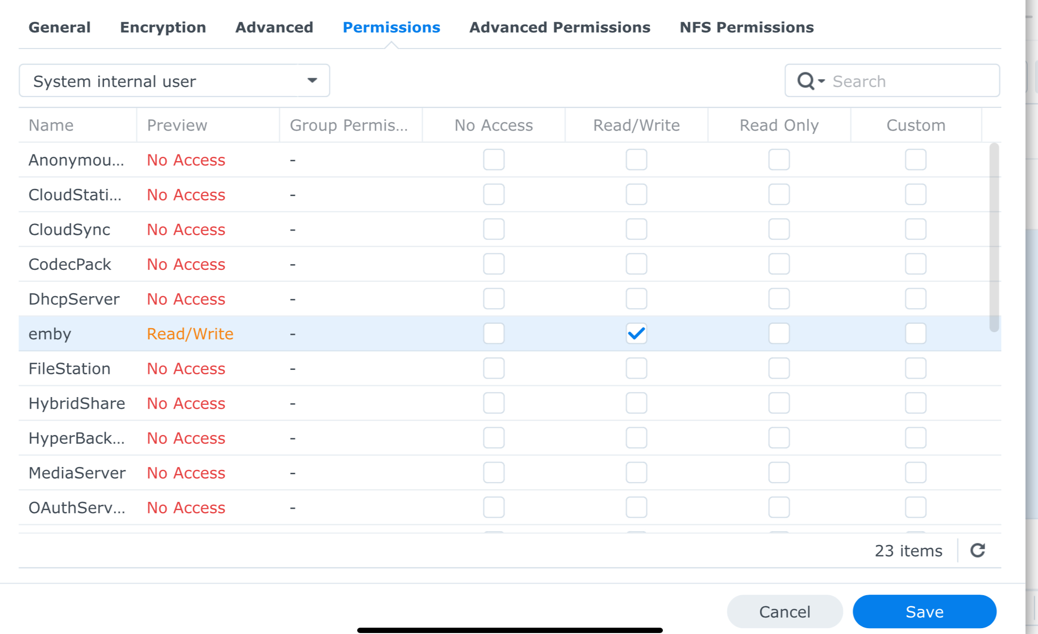

Carlo 4561 Posted October 11, 2024 Posted October 11, 2024 Hi, Have you set proper permissions on the library folders? https://emby.media/support/articles/Synology-Set-Permissions.html
Saberoz 4 Posted October 11, 2024 Author Posted October 11, 2024 @CarloYep, confirmed again to be sure and Emby has read/write access I even doubled checked by going to file manager and checking the permissions of a folder that had photos in it and Emby has R/W access. I also don't have Synology Photos installed either.

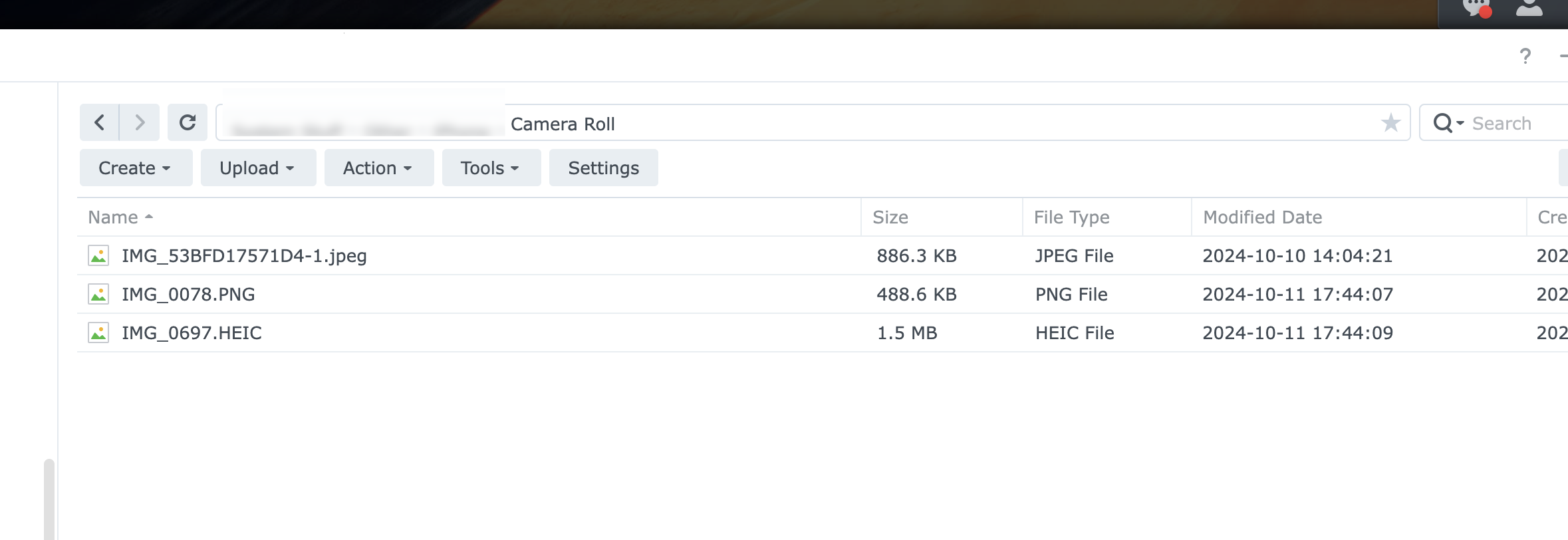

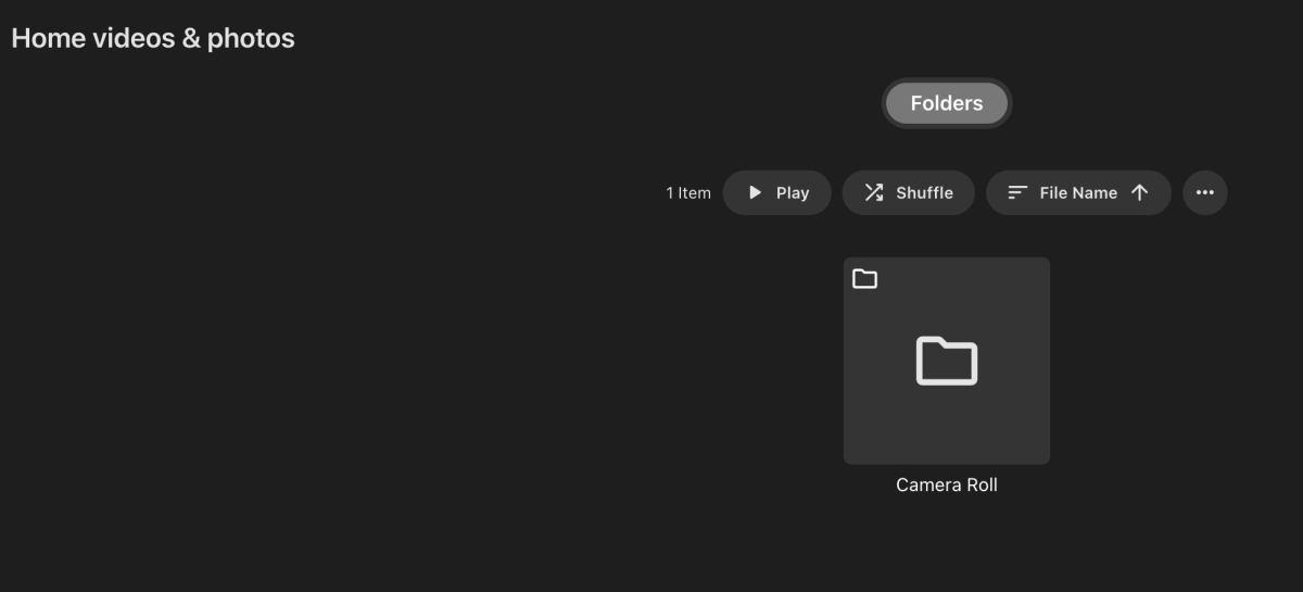

Luke 42241 Posted October 12, 2024 Posted October 12, 2024 Hi, can you show screenshot examples of what you see in the Emby web app? Thanks.

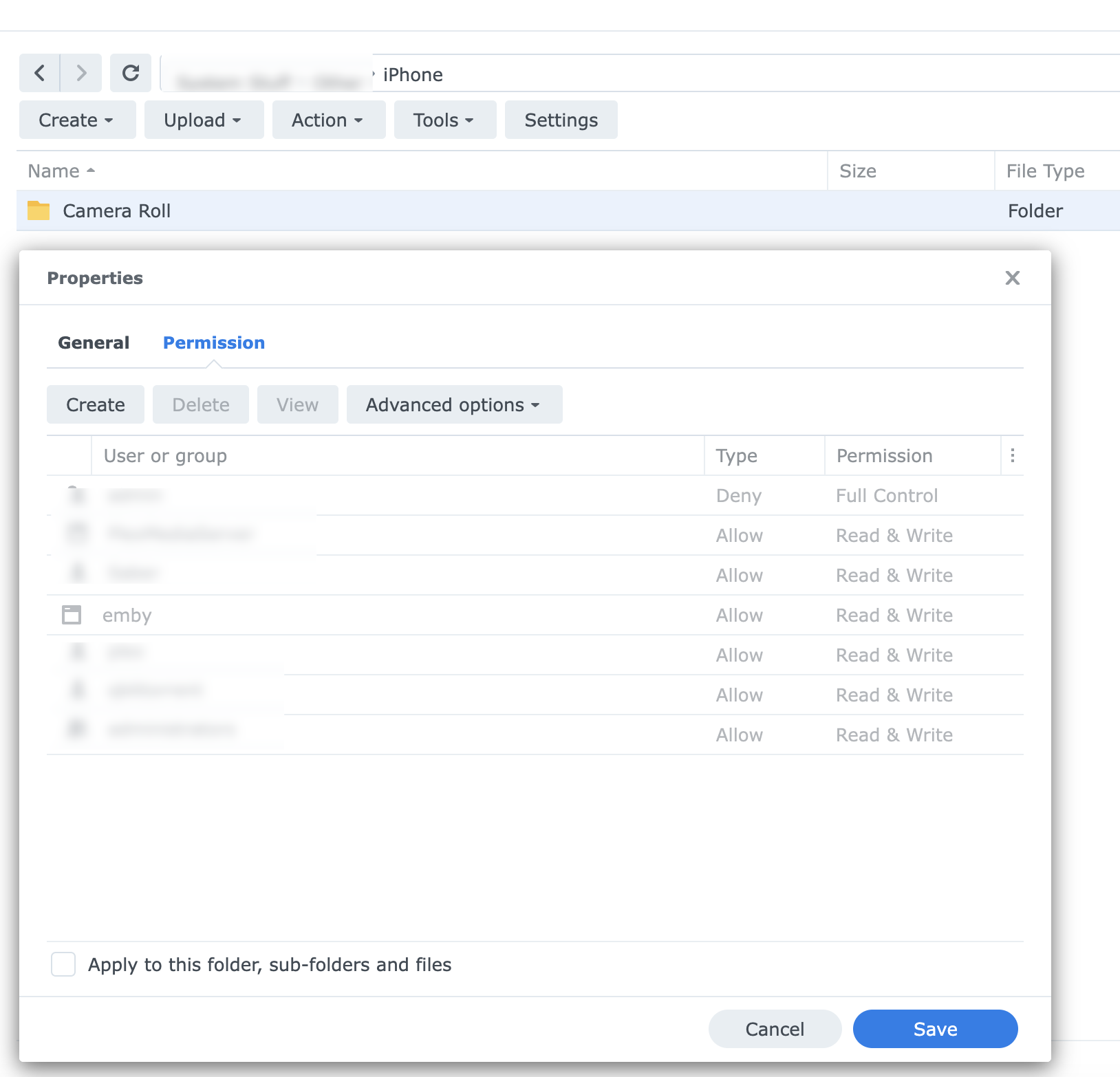

Saberoz 4 Posted October 12, 2024 Author Posted October 12, 2024 Here is the folder from the scan. It is one I am using to do my testing on. Here is the folder in the Synology Nas And just confirmed Emby has R/W permission. Let me know if that helps.
Carlo 4561 Posted October 13, 2024 Posted October 13, 2024 "Camera Roll" almost got me, as there is a feature in Emby to automatically upload pics from some clients. Please enable the check box above "Apply to this folder, sub-folders and files" then do a library refresh. The files themselves might not have proper permissions. Synology is picky about file & group ownership as well as access rights. If the media still doesn't show up go the Logs menu, then settings tab and enable debug logging. Do another library refresh and upload the server log file again. You can turn debug logging off again.
Saberoz 4 Posted October 13, 2024 Author Posted October 13, 2024 Your not going crazy. This was originally done via the camera upload on the iphone app. I have other directories that were just normal ones with jpgs in them, nothing was working so I gave this a go to see if the pictures were showing up. Let me reset all the permission and I will try again. 1

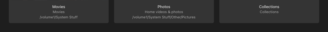

Luke 42241 Posted October 16, 2024 Posted October 16, 2024 9 hours ago, Saberoz said: yea that seemed odd to me also. I am going to Library and clicking the 3 dots and hitting scan library files Could the san not be working for this library type. I have created the library a few times now but it never populates with anything. Hi, what folder paths are added to each of the 4 libraries?
Saberoz 4 Posted October 17, 2024 Author Posted October 17, 2024 @Luke I had a couple of other test libraries in there. So I have removed them now so that it is clean. There is now 2 libraries and one collection I have one for movies that I am testing and this one I am using to see if I can get images will show. Everything sits under my test folder System Stuff
Solution Luke 42241 Posted October 17, 2024 Solution Posted October 17, 2024 1 hour ago, Saberoz said: @Luke I had a couple of other test libraries in there. So I have removed them now so that it is clean. There is now 2 libraries and one collection I have one for movies that I am testing and this one I am using to see if I can get images will show. Everything sits under my test folder System Stuff OK this type of setup is not supported. You’ve got a parent folder setup with the movies content type and a subfolder as home videos. This is the reason for the issue.
Saberoz 4 Posted October 17, 2024 Author Posted October 17, 2024 @Luke so I can't have all my content in one folder structure , I have to break up different parent folders for different content?
Luke 42241 Posted October 17, 2024 Posted October 17, 2024 1 minute ago, Saberoz said: @Luke so I can't have all my content in one folder structure , I have to break up different parent folders for different content? For different content types, yes. The easiest thing to do would be /system stuff/movies 1
Saberoz 4 Posted October 17, 2024 Author Posted October 17, 2024 .. ok let me move a few things around and try again. 1
Carlo 4561 Posted October 17, 2024 Posted October 17, 2024 13 hours ago, Saberoz said: @Luke so I can't have all my content in one folder structure , I have to break up different parent folders for different content? You could have something like: /Volume1/Media /Volume1/Media/Movies /Volume1/Media/TV /Volume1/Media/Photos /Volume1/Media/Music You could then use each of the subfolder for the proper corresponding library. What you can't do is use /Volume1/Media in any library because it would have subfolders under it that are part of another library. Make sense? Carlo 1
