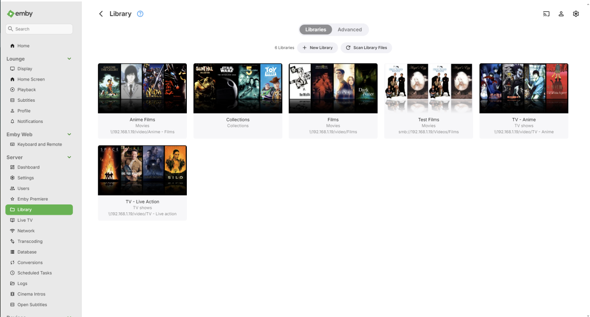

66LUX 6 Posted October 13, 2024 Author Posted October 13, 2024 20 hours ago, Carlo said: Please upload a screen shot of the library configuration showing all folders paths. Hi Carlo. Sorry for the slow response. Busy day yesterday. I very much appreciate your help. Screenshot attached. I created a new shared folder with Synology File Station and called it "Videos" (as opposed to the old "Video"). Gave Emby read/write permissions in System Internal User and Local Users. I created a new library and called it "Test Films". As you can see, this new path is displayed differently in the library view, with smb and the slashes the other way around. I don't know why, because I don't think I did anything differently (although the older libraries have been there for a long time). I put a couple of media folders in that shared folder. Ran the Scan Media Library scheduled task. Both movies now show up in Emby client with the correct information, but the media folders themselves only contain the media video file. No other files in the folder. The log still shows the FILE_DOES_NOT_EXIST error Pardon my ignorance, but it seems that the GET function is finding the correct image file. The file listed actually exists on the web. Is the server supposed to "save as" a friendly name like "clearlogo.png? Is the issue that the file is not being created, or is the issue that it isn't being moved to my media folder? TIA embyserver (1).txt

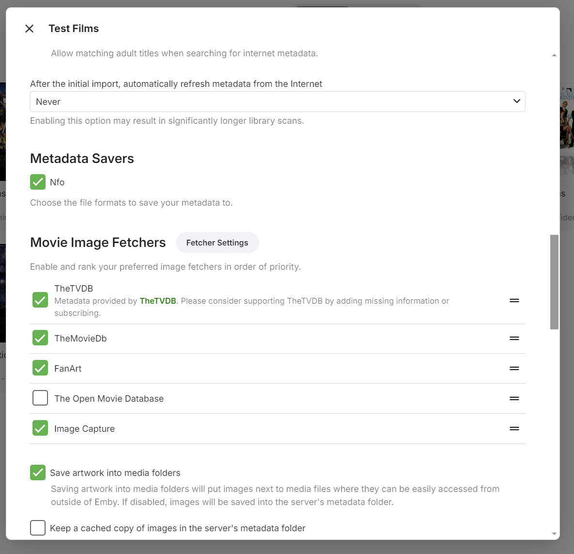

Carlo 4561 Posted October 14, 2024 Posted October 14, 2024 Check the configuration of the library you just setup. You'll see options to read/write NFO files as well as saving images to the media folder.
Carlo 4561 Posted October 14, 2024 Posted October 14, 2024 Looking at your logs it appears you are still using SMB for Test Films. 2024-10-13 09:35:59.518 Info Server: http/1.1 POST http://192.168.1.19:8096/emby/Library/VirtualFolders?collectionType=movies&refreshLibrary=true&name=Test Films&X-Emby-Client=Emby Web&X-Emby-Device-Name=Chrome Windows&X-Emby-Device-Id=9515d3bc-258c-4565-b80d-66506f8538aa&X-Emby-Client-Version=4.8.8.0&X-Emby-Token=x_secret1_x&X-Emby-Language=en-gb&reqformat=json. UserAgent: Mozilla/5.0 (Windows NT 10.0; Win64; x64) AppleWebKit/537.36 (KHTML, like Gecko) Chrome/129.0.0.0 Safari/537.36 2024-10-13 09:35:59.759 Info App: Creating folder in database Films - smb://192.168.1.19/Videos/Films 2024-10-13 09:35:59.774 Info App: Created folder in database Films 64866 - smb://192.168.1.19/Videos/Films 2024-10-13 09:35:59.789 Info Server: http/1.1 Response 204 to host1. Time: 271ms. POST http://192.168.1.19:8096/emby/Library/VirtualFolders?collectionType=movies&refreshLibrary=true&name=Test Films&X-Emby-Client=Emby Web&X-Emby-Device-Name=Chrome Windows&X-Emby-Device-Id=9515d3bc-258c-4565-b80d-66506f8538aa&X-Emby-Client-Version=4.8.8.0&X-Emby-Token=x_secret1_x&X-Emby-Language=en-gb&reqformat=json 2024-10-13 09:35:59.793 Info TaskManager: Attempting to cancel Scheduled Task Scan media library 2024-10-13 09:35:59.793 Info TaskManager: Queueing task RefreshMediaLibraryTask 2024-10-13 09:36:00.010 Error ProviderManager: Error in metadata saver *** Error Report *** Version: 4.8.8.0 Command line: /volume1/@appstore/EmbyServer/system/EmbyServer.dll -programdata /var/packages/EmbyServer/var -ffdetect /var/packages/EmbyServer/target/bin/ffdetect -ffmpeg /var/packages/EmbyServer/target/bin/ffmpeg -ffprobe /var/packages/EmbyServer/target/bin/ffprobe -nolocalportconfig -ignore_vaapi_enabled_flag -pidfile /var/packages/EmbyServer/var/EmbyServer.pid -defaultdirectory /volume1/Public -updatepackage emby-server-synology7_{version}_x86_64.spk -noautorunwebapp Operating system: Linux version 3.10.108 (root@build8) (gcc version 8.5.0 (GCC) ) #42962 SMP Fri Mar 24 12:30:20 CST 2023 Framework: .NET 6.0.25 OS/Process: x64/x64 Runtime: volume1/@appstore/EmbyServer/system/System.Private.CoreLib.dll Processor count: 4 Data path: /var/packages/EmbyServer/var Application path: /volume1/@appstore/EmbyServer/system System.IO.IOException: System.IO.IOException: Create Handle Failed: Films\Kenny Everett's Naughty Bits (1989). NTStatus: FILE_DOES_NOT_EXIST at EzSmb.Transports.Shares.Handlers.Bases.HandlerBase..ctor(SmbType smbType, ISMBFileStore store, String path, HandleType handleType, NodeType nodeType, HandleArgs args) at EzSmb.Transports.Shares.Smb2Share.GetHandler(String path, HandleType handleType, NodeType nodeType, HandleArgs args) at EzSmb.Transports.Shares.Bases.ShareBase.CreateFolder(Node node, String folderName) at EzSmb.Node.CreateFolder(String folderName, String relatedPath) at Emby.Server.Implementations.IO.SmbFileSystem.CreateDirectory(String path) at NfoMetadata.Savers.BaseNfoSaver.SaveToFile(Stream stream, String path, LibraryOptions libraryOptions, CancellationToken cancellationToken) at NfoMetadata.Savers.BaseNfoSaver.Save(BaseItem item, LibraryOptions libraryOptions, CancellationToken cancellationToken) at Emby.Providers.Manager.ProviderManager.SaveMetadata(BaseItem item, LibraryOptions libraryOptions, ItemUpdateType updateType, IMetadataSaver[] savers, CancellationToken cancellationToken) Source: Emby.Server.Implementations TargetSite: Void .ctor(EzSmb.Params.Enums.SmbType, SMBLibrary.Client.ISMBFileStore, System.String, EzSmb.Transports.Shares.Handlers.Enums.HandleType, EzSmb.NodeType, EzSmb.Transports.Shares.Handlers.HandleArgs)

66LUX 6 Posted October 14, 2024 Author Posted October 14, 2024 6 hours ago, Carlo said: Check the configuration of the library you just setup. You'll see options to read/write NFO files as well as saving images to the media folder. I have the save to media folders option ticked.

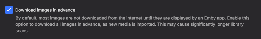

Happy2Play 9811 Posted October 15, 2024 Posted October 15, 2024 13 minutes ago, 66LUX said: Anyway, next thing was that the artwork wasn't saved into the same folder, even though I have that option checked. Once I viewed the individual film on the client side, it populated the images into the corresponding folder. Yes the "download in advance option will apply to media image otherwise the will be gotten on demand via navigation. enable show advances settings per library config. 1
