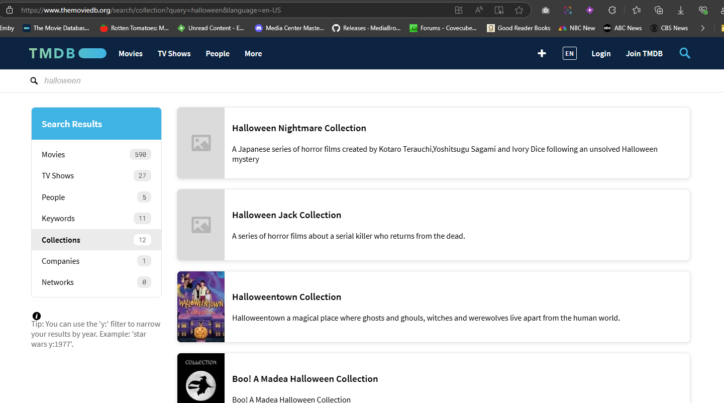

tommy793 0 Posted October 9, 2024 Author Posted October 9, 2024 Actually, one thing I just notice. This is a custom collection, so where did this collection description come from? https://i.imgur.com/hWjcg4l.png
Happy2Play 9798 Posted October 9, 2024 Posted October 9, 2024 1 hour ago, tommy793 said: Actually, one thing I just notice. This is a custom collection, so where did this collection description come from? https://i.imgur.com/hWjcg4l.png TMDB in this case a Wrong by Name lookup for a Custom Collection.
Happy2Play 9798 Posted October 9, 2024 Posted October 9, 2024 But a wrong lookup will not remove said item from a custom collection as they are linked per your custom Name. Since you don't write nfo files you would need to monitor logs for items being removed.
