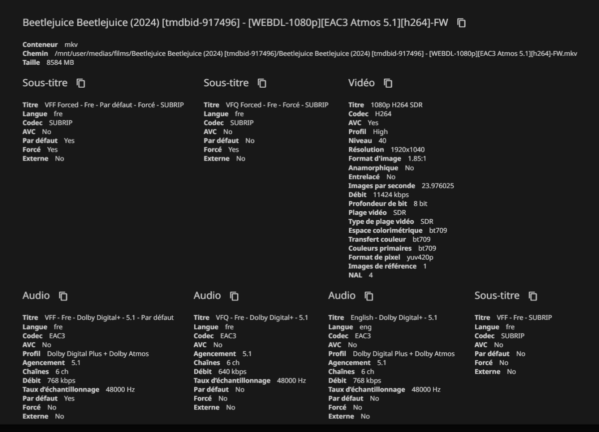

Guest Posted October 8, 2024 Posted October 8, 2024 (edited) Hello, I'm experiencing an issue when I start playing a movie that requires transcoding. Sometimes the playback stops and then resumes, but this happens quite frequently. I don't understand why this is occurring. I've tested this on an iPhone, and my server has an i7-14700 CPU, but I'm using the integrated GPU (iGPU) for transcoding. Here are the relevant logs: (It should be noted that this test was carried out specifically with the film “Beetlejuice” (2024).) ffmpeg-transcode-3e089ea0-77db-479b-bcdf-4659ee06419e_1.txt embyserver (1).txt Edited October 8, 2024 by Dydhzo film name

Guest Posted October 10, 2024 Posted October 10, 2024 21 hours ago, Happy2Play said: I would probably deactivate but it is really doesn't matter. At a minimum you would do HEVC decoder and H264 encoder. But all codecs you are doing to test you will need to ensure those decoders are set also. HEVC encoder is not being used in this scenario do it does not matter. I think I've found the problem, but I don't know how to fix it. When I deactivate forced subtitles, it works without any issues. Even with normal subtitles, it works fine. But when forced subtitles are activated, it bugs out... I don't understand why this happens or how to solve this problem. The subtitles are in SubRip format.

Guest Posted October 11, 2024 Posted October 11, 2024 10 hours ago, Carlo said: Hi, The log file you sent doesn't appear to be using any subs. It also appeared to be transcoding fine. It only happens with forced subtitles, even if they don't appear. For example, it happens with the movie Beetlejuice 2024: at 3 minutes, it stops and then resumes. But when I deactivate the forced subtitles, there's no problem at all. ffmpeg transcode Beetlejuice 2024 : ffmpeg-transcode-9aa89ce9-c76f-49f5-958b-25a93edb9320_1.txt
