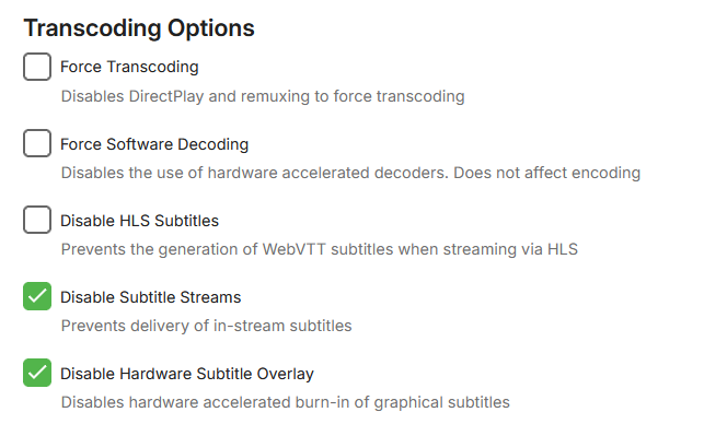

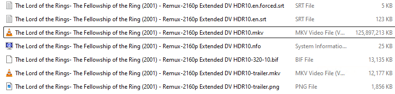

Statick 15 Posted October 25, 2024 Author Posted October 25, 2024 my external subs are correctly named as far as I know, but they never get selected over the embedded subs Quote tv episode.mkv tv episode.en.forced.srt the embedded forced subs are what get selected. I've tried both "default" and "smart" sub selection, and clearing previous selections, and it's the same every time. the embedded subs can be the same identical srt track (which was extracted to produce the external file which I then name as above), they can also be something entirely different such as a PGS sub (some of my rips still contain these), doesn't seem to make a difference, whatever the embedded sub is it still gets chosen over the external sub
Statick 15 Posted October 25, 2024 Author Posted October 25, 2024 On 24/10/2024 at 17:44, rbjtech said: Sure - but I think you are missing the important point here - what will emby select if there are embedded subtitles of the same type ? A classic example is if the embedded subtitle - lets say Eng - it may have a Default flag in the MKV. If I download an external file - name it according to your link above - movie.en.srt - the internal sub will STILL be the one used by Default. Only if you name it movie.en.default.srt will it then use it as the Default. Alternatively of course, you could just remove the 'Default' flag in the MKV, and then it would use the external SRT as a preference. That is not explained in the wiki ... My personal opinion is an external file named movie.en.srt should be used as priority over any embedded sub for en - default or not. If the admin has bothered to download/extract it - then it's probably the one they want to use. oh it's THIS the embedded subs are flagged as default, my external subs are not, because I've named them the way the documentation explains, and the way every forum post I've seen on it explains as well. this is the first time I've seen anything that mentions putting "default" in the name as well 1
Carlo 4561 Posted October 27, 2024 Posted October 27, 2024 On 10/25/2024 at 6:00 PM, Statick said: my external subs are correctly named as far as I know, but they never get selected over the embedded subs the embedded forced subs are what get selected. I've tried both "default" and "smart" sub selection, and clearing previous selections, and it's the same every time. the embedded subs can be the same identical srt track (which was extracted to produce the external file which I then name as above), they can also be something entirely different such as a PGS sub (some of my rips still contain these), doesn't seem to make a difference, whatever the embedded sub is it still gets chosen over the external sub On 10/25/2024 at 6:15 AM, rbjtech said: This is for transcoding only - the whole idea of this thread is to NOT use transcoding in the first place .. ? tbh - I'm a little confused as you are repeating what I said above. All the external progs that do the extraction will NOT name the file using 'default' thus embedded wins every time. IMO this is Emby that is at fault - if nobody else does it that way, then it's Emby that need to change - not enforce an illogical name standard. I'm suggesting you put something like your first paragraph in the wiki, with examples, so at least people will realise they need to name their subs with an extra 'default' in there to superseed the Default flag on the embedded sub... I don't want to update the knowledge base yet, because I think the behavior has changed if it's favoring embedded subs over external. I just did it in tdarr so I k know it can do it, but it has a bit of a learning curve. ffmpeg can extract both graphical and txt subtitles. Subtitle Edit has a CLI that could be used as well.This is a very powerful subtitle program that can even convert graphical subs to txt based ones as well as fix errors in subtitles. I need to check to see if it can automatically pull the subtitles out, saving them with the track name. Either of them could be wrapped in a script or C# program. We really shouldn't need to extract the subs to keep the server from using them. A far simpler solution would be adding a couple new config options to the server so we could have: Disable use of internal graphic subtitles Disable use of all internal subtitles With internal subtitle use disabled, the file names of subtitles downloaded from Open Subtitles or other sources would not conflict or matter. The downside might be that no client would get a direct play file if it contained internal subtitles. Remuxing the video is not CPU intensive and would actually save bandwidth, especially on a lot of ripped content having 40+ subtitles in it. What do you think?
