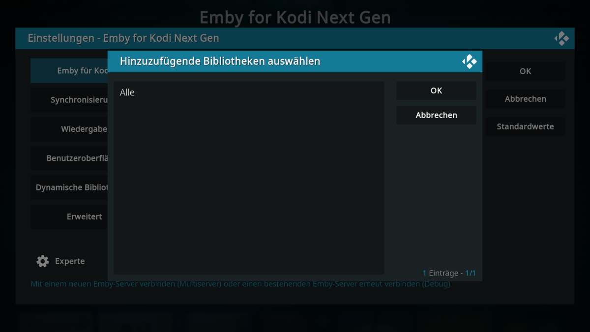

Tenker 6 Posted October 9, 2024 Posted October 9, 2024 (edited) I have the same symptoms ... As you recommended, I have deleted the PC from the GUI devices. Logged out of Kode and logged back in. Unfortunately it does not list any libraries, so you cannot access them (as in the picture). I back up my Windows OS with Acronis and have an older version with Kodi + Emby 10.0.38 = same problem! So it remains Emby-Server emby-server-synology7_4.9.0.30_x86_64.spk on my Synology with DSM 7.1.1-42962 Update 6 to blame, because I did the update 2 weeks ago! Where can I find older versions of emby-server-synology7_4.9.0.**_x86_64.spk ? Can I uninstall as a trial and then downgrade? Thanks for your help Tenker Edited October 9, 2024 by Tenker

quickmic 1709 Posted October 9, 2024 Posted October 9, 2024 Are the libraries accessible for the (Emby) user account you use in the plugin?
Tenker 6 Posted October 9, 2024 Posted October 9, 2024 Under http://192.168.0.15:8096/web/index.html#!/home all visible, with Kodi there is no access to the libraries.
quickmic 1709 Posted October 9, 2024 Posted October 9, 2024 Does the user have admin permissions? If not, you could try assign admin previlegies.
Tenker 6 Posted October 9, 2024 Posted October 9, 2024 (edited) Yes, the PC user is Admin and therefore has all rights... Edited October 9, 2024 by Tenker
quickmic 1709 Posted October 9, 2024 Posted October 9, 2024 Then please send me a debug-log (via PM) when you open the library selection in the plugin.
Tenker 6 Posted October 9, 2024 Posted October 9, 2024 Do you mean from the Emby server on Synology, when on the PC Kodi -> embyforkodi -> Libraries on the PC? https://emby.media/support/articles/Log-Files.html If so, then tomorrow I have to somehow gain access to the ROOT of the DSM and thus to Emby Server data...
