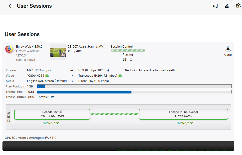

MBDino 2 Posted October 7, 2024 Posted October 7, 2024 I'm resuming playback of a 2 hour-long movie on my Chromecast. Emby will need to seek to the time where I left off and resume playback. However, it never starts playback, or at least not within 30 minutes of waiting. This happens with a lot of movies. I believe it only happens if Emby decides it's necessary to transcode the audio track (no doubt, rightly so). If I resume the same movie on my desktop then it works fine and there is no Emby transcoding. If I use Handbrake to transcode the movie, the transcoded movie works fine on Chromecast. Playing from the start works fine. However, if I seek then it will similarly just stop playing back. Attached is an image of the session. I believe the red bar indicates it's finished the Emby transcoding. This is with Emby v 4.8.10.0, though I had the same problem with v 4.7.14.0.

Carlo 4561 Posted October 10, 2024 Posted October 10, 2024 44 minutes ago, iiiJoe said: Following. I too have experienced a similiar issue with watching recordings in progress on a client device (Shield). In my case, when trying to seek the stream will freeze completely or go back to the very first frame of the recording and freeze there. Sometimes if I wait long enough it will restart, other times I have to restart the stream. I've found that if I FF through large chunks of video it happens almost every time whereas if I seek slowly it happens less frequently. Hi, Are these recordings being transcoded while watching by any chance? If you look at the server dashboard for the user playback of the transcode, is the server having to transcode the file and play catch up to where you FF to? Carlo PS If you install the Diagnostic Plugin from the catalog you will have a new menu option called User Sessions which gives you a nice view of playback information. 2 hours ago, MBSki said: @CarloIt would be great if you were taking over as point on this issue. You've seen all the other traffic regarding seeking live recordings right? I'm watching and asking for information I think might be useful to aid the devs, but this is something the devs needs to look at and diagnose/fix. Carlo 1

iiiJoe 62 Posted October 10, 2024 Posted October 10, 2024 (edited) 1 hour ago, Carlo said: Hi, Are these recordings being transcoded while watching by any chance? If you look at the server dashboard for the user playback of the transcode, is the server having to transcode the file and play catch up to where you FF to? Carlo PS If you install the Diagnostic Plugin from the catalog you will have a new menu option called User Sessions which gives you a nice view of playback information. I'm watching and asking for information I think might be useful to aid the devs, but this is something the devs needs to look at and diagnose/fix. Carlo Really nice plug in! Ty. Tried several devices and they're all direct play. Question: Looks like I'm decoding and encoding with software. Could the seek issue be mitigated through hardware decoding/encoding? Can you please advise how I would change the decoding/encoding options? Edited October 10, 2024 by iiiJoe update
iiiJoe 62 Posted October 10, 2024 Posted October 10, 2024 1 hour ago, iiiJoe said: Really nice plug in! Ty. Tried several devices and they're all direct play. Question: Looks like I'm decoding and encoding with software. Could the seek issue be mitigated through hardware decoding/encoding? Can you please advise how I would change the decoding/encoding options? Or force hardware use instead of software.
Carlo 4561 Posted October 10, 2024 Posted October 10, 2024 (edited) 2 hours ago, iiiJoe said: Really nice plug in! Ty. Tried several devices and they're all direct play. Question: Looks like I'm decoding and encoding with software. Could the seek issue be mitigated through hardware decoding/encoding? Can you please advise how I would change the decoding/encoding options? Check the Transcode Menu in the Dashboard. https://emby.media/support/articles/Transcoding.html What client are you using? Edited October 10, 2024 by Carlo 1

MBDino 2 Posted October 11, 2024 Author Posted October 11, 2024 I figured out the User Sessions thing. Attached is a screen shot in case it helps (excluding my name and info). You can see that audio transcoding was necessary and it's complete. The screen is still frozen. The Play Position time continues to increase even though the screen is still frozen. You'll see from my embyserver.txt that it's getting reports of increasing play position even though the screen is frozen.
