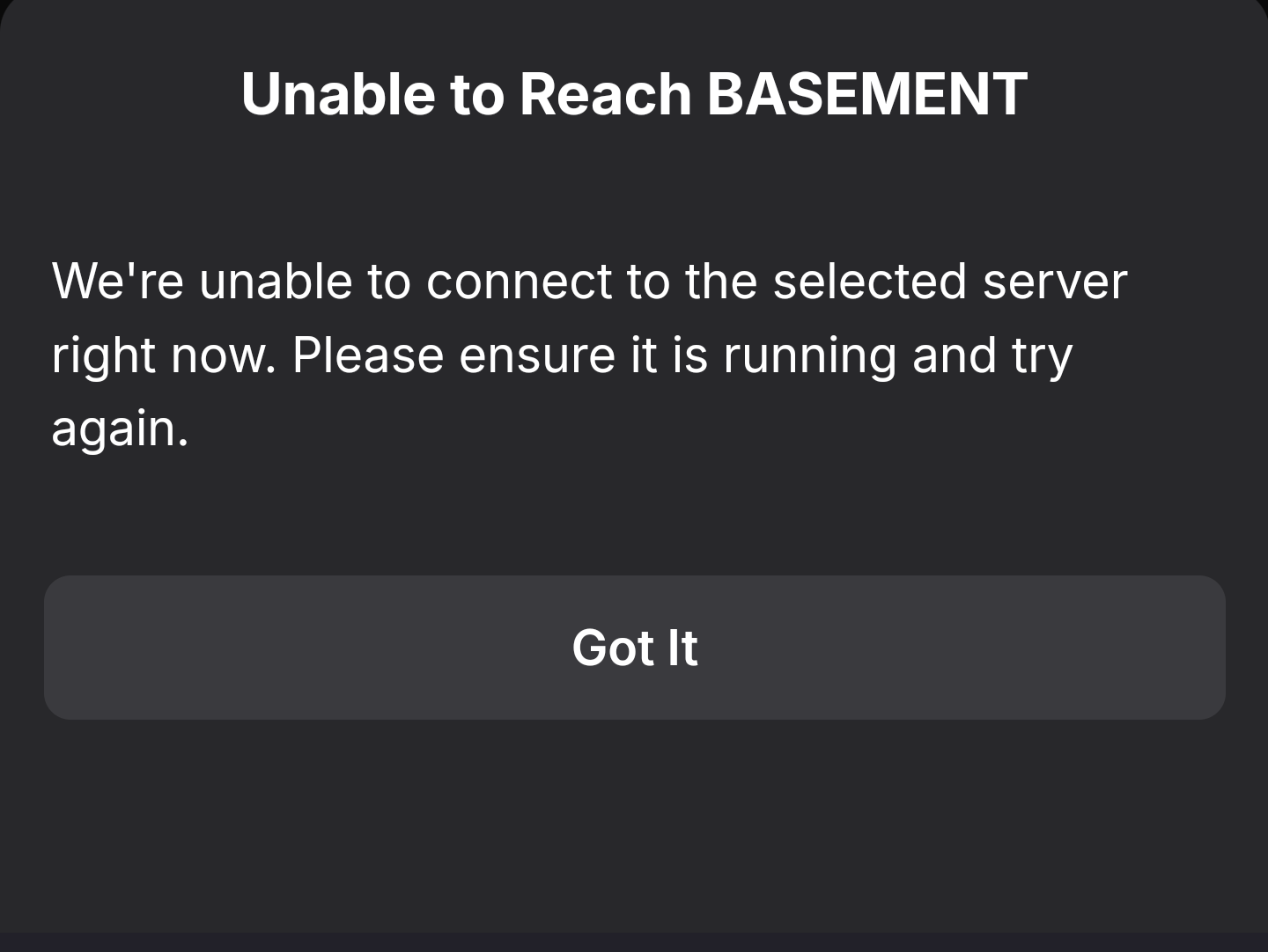

tp546 41 Posted October 8, 2024 Author Posted October 8, 2024 Can't get emby connect working now. I put my username in under my user settings and it was accepted but I can't connect outside my network.
tp546 41 Posted October 8, 2024 Author Posted October 8, 2024 I see my server in the list, but it won't connect to it.
Luke 42184 Posted October 9, 2024 Posted October 9, 2024 7 hours ago, tp546 said: I see my server in the list, but it won't connect to it. Hi, what exactly happens when you try?
tp546 41 Posted October 9, 2024 Author Posted October 9, 2024 2 minutes ago, Luke said: Hi, what exactly happens when you try? I get this error message
Carlo 4561 Posted October 9, 2024 Posted October 9, 2024 19 hours ago, tp546 said: I'm just going to the system tray and going to the settings, then copying and pasting that url What is this URL you're copying and pasting? What happens if you manually type the URL in a browser, like this: http://IP:Port For example, if your Emby Server IP is 192.168.0.60 and you're using the standard Emby port of 8096 you would enter http://192.168.9.60:8096 Does this allow you to login normally? 19 hours ago, tp546 said: Can't get emby connect working now. I put my username in under my user settings and it was accepted but I can't connect outside my network. Are you trying to access your Emby Server from your home network where the Emby Server is? If so, you don't need to use Emby Connect as you can log in directly using the format above in a browser or by specifying the IP and Port in an Emby client app.
tp546 41 Posted October 11, 2024 Author Posted October 11, 2024 On 10/9/2024 at 12:24 PM, Carlo said: What is this URL you're copying and pasting? What happens if you manually type the URL in a browser, like this: http://IP:Port For example, if your Emby Server IP is 192.168.0.60 and you're using the standard Emby port of 8096 you would enter http://192.168.9.60:8096 Does this allow you to login normally? Are you trying to access your Emby Server from your home network where the Emby Server is? If so, you don't need to use Emby Connect as you can log in directly using the format above in a browser or by specifying the IP and Port in an Emby client app. Logging in that way works. No, I'm trying to test it at home by turning off my wifi and using my cell network but it won't connect.
pwhodges 2023 Posted October 11, 2024 Posted October 11, 2024 Have you set up the requirements for access from outside your network? https://emby.media/support/articles/Remote-Setup.html Paul
tp546 41 Posted October 11, 2024 Author Posted October 11, 2024 On 10/9/2024 at 12:24 PM, Carlo said: What is this URL you're copying and pasting? What happens if you manually type the URL in a browser, like this: http://IP:Port For example, if your Emby Server IP is 192.168.0.60 and you're using the standard Emby port of 8096 you would enter http://192.168.9.60:8096 Does this allow you to login normally? Are you trying to access your Emby Server from your home network where the Emby Server is? If so, you don't need to use Emby Connect as you can log in directly using the format above in a browser or by specifying the IP and Port in an Emby client app. Logging in that way works. No, I'm trying to test it at home by turning off my wifi and using my cell network but it won't connect. 8 minutes ago, pwhodges said: Have you set up the requirements for access from outside your network? https://emby.media/support/articles/Remote-Setup.html Paul Yes, I double checked those yesterday. I'll try to add some screenshots from my router and my emby settings in a few minutes
Carlo 4561 Posted October 11, 2024 Posted October 11, 2024 5 hours ago, tp546 said: Logging in that way works. No, I'm trying to test it at home by turning off my wifi and using my cell network but it won't connect. Yes, I double checked those yesterday. I'll try to add some screenshots from my router and my emby settings in a few minutes Make sure to read and check the info under "Verify Public IP and Port" in the above knowledge base article. It's important to check this to make sure your external IP is available on the Internet and not behind a CG-NAT.
