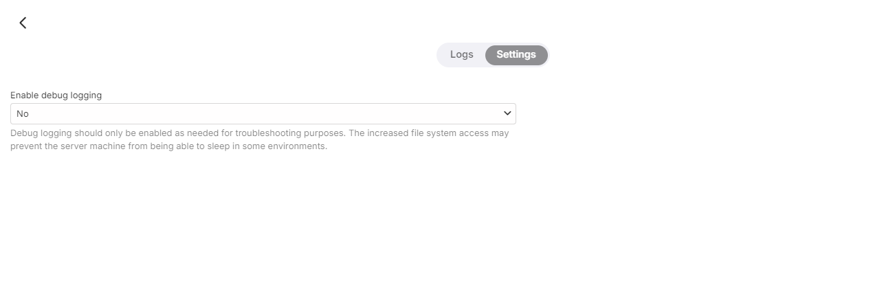

mammt 5 Posted October 8, 2024 Author Posted October 8, 2024 2 hours ago, Carlo said: OK so it's a new install still doing a lot of background work gathering metadata. You can turn off debug logging which wis only needed by support when asked, otherwise it's logging everything it's doing, spamming the log file which makes overall reading of the server log file harder and uses more IO as well. A dev will need to look at this to see why the transcoding is being ended with a quit command. Can you get a picture of what the Live TV settings are set to on the Samsubg Emby Client? Carlo the debugging logs were already off as i can see, i have never enabled them. i'll get the live tv settings of the samsung emby client asap; but i had left them default if that changes anything

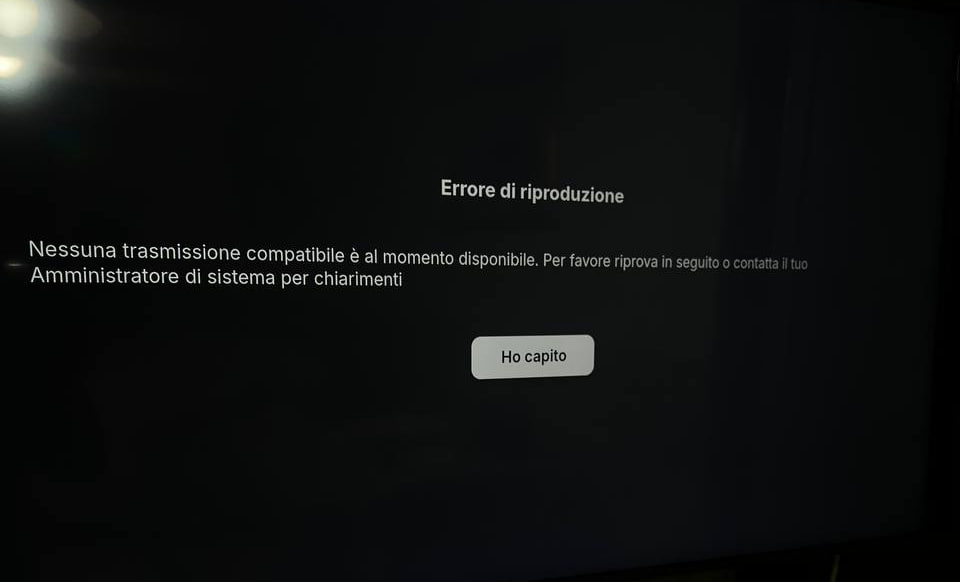

mammt 5 Posted October 8, 2024 Author Posted October 8, 2024 I just checked the Samsung Emby client, but I don't see any "Live TV" settings. The only option available is "Playback," and none of the settings there mention anything about live TV (even though they are set to auto). As for the issue on the smart TV, any TV channels that work fine on other TVs, the website, and the iPhone app show an error message. The error on the smart TV translates to: "No compatible streams are currently available." I've also attached some new logs since I retried again just now. embyserver.txt ffmpeg-directstream-bcc02cab-bc03-4c46-b40d-ba061d86f16b_1.txt ffmpeg-transcode-e7286805-781f-44a2-b2ca-7a32091f630b_1.txt ffmpeg-transcode-9971528b-3c15-438a-9b6b-0c54ba31d654_1.txt
