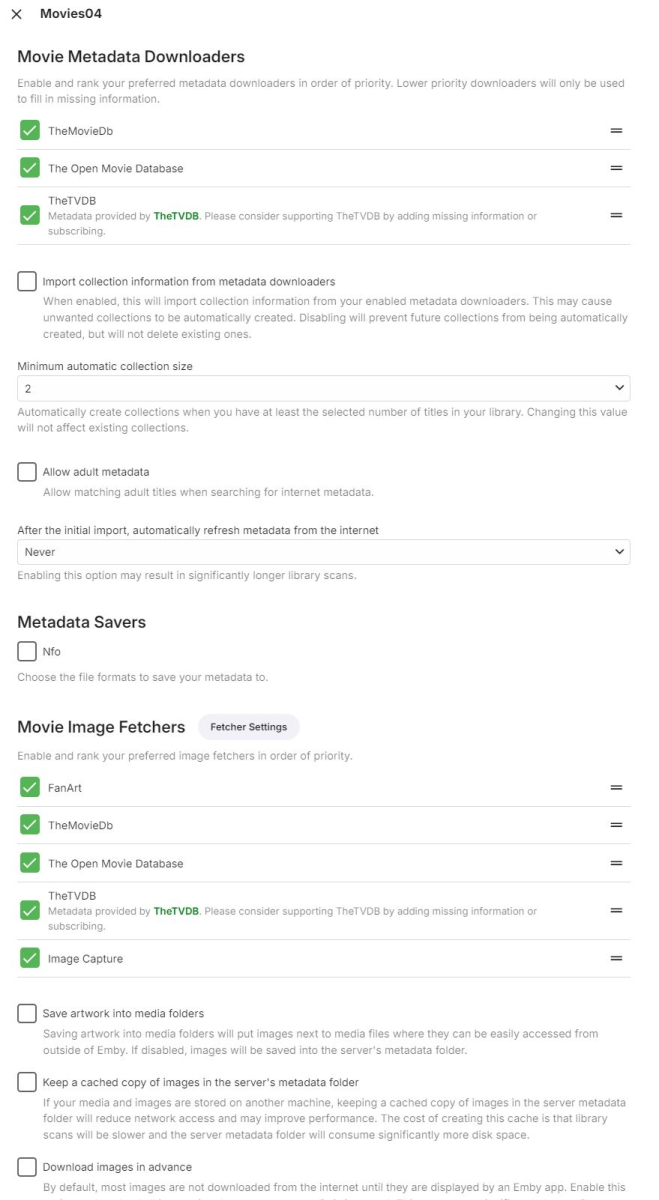

Happy2Play 9812 Posted October 6, 2024 Posted October 6, 2024 To a point specific examples are needed along with enabled metadata provider order on the library. 1
ulrick65 30 Posted October 6, 2024 Author Posted October 6, 2024 54 minutes ago, mickle026 said: Refresh metadata next to scan library files from the ... 3 dot menu popup on the library thumbnail, the selection box has two options, replace metadata or search for missing metadata. You can do either. The 'missing' option should be all you need. I cannot show a screenshot because I'm reply with my phone from my workplace. Thanks, I saw that after I posted above and then edited my post. I tried it, same thing. 26 minutes ago, Happy2Play said: To a point specific examples are needed along with enabled metadata provider order on the library. Here's the library settings, not sure what else I should provide. Let me know and I will do it. I am going to set DEBUG log on now and run a metadata refresh and see what it shows. In the current log, it does not seem to show anything about searching for people (that I could decipher anyway). Thanks for the help...I appreciate it.

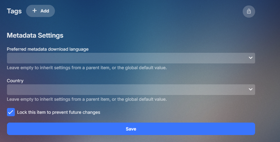

ulrick65 30 Posted October 6, 2024 Author Posted October 6, 2024 Ok, I made some progress...but I don't quite understand it. Something that I saw by luck in another post that @Lukemade: On 3/31/2023 at 11:26 AM, Luke said: Actually check the bottom of the metadata editor on some of your titles. I think you may have locked metadata on some or all of your items. All of my media has this "check box" checked. I am not sure where that setting comes from or how to change it on a global scale. However, I went into one movie and unchecked it, then saved. Then I did the Metadata Refresh and it worked! However, when I go back into that Movie the checkbox is checked again. I save all my metadata (except the People Images) in my local media folder (backdrops, folder images, etc.). I don't want Emby to mess with anything there. I thought that it would download the People Images regardless because the People Images are stored in the metadata/people folder. However, this setting seems to affect that. Can someone explain what this setting does (seems intuitive I know) and how to set it properly for my situation? I don't want anything changed from what I have in the media folders, but I do want the People Images downloaded. I checked the library setup and I don't see where this "Lock Metadata" is referrenced in there anywhere, so I am not sure how it is even set (other than movie by movie manually). Thoughts? Thanks for the help.

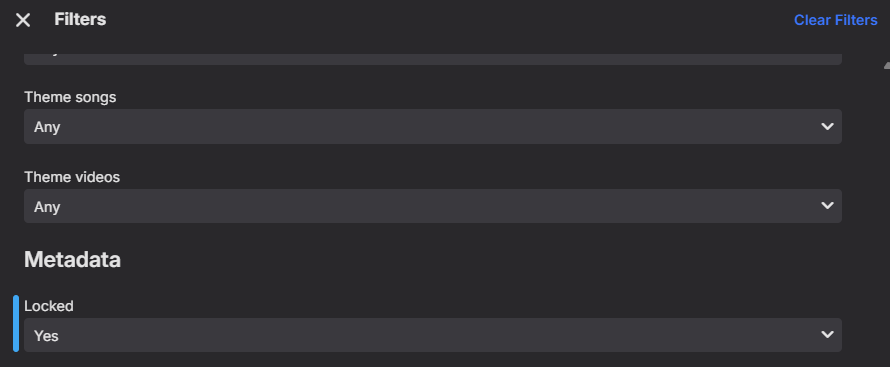

Happy2Play 9812 Posted October 6, 2024 Posted October 6, 2024 8 minutes ago, ulrick65 said: I checked the library setup and I don't see where this "Lock Metadata" is referrenced in there anywhere, so I am not sure how it is even set (other than movie by movie manually). Thoughts? You can alway filter per library to check for locked metadata. Use to be able to see in Metadata Manager but that was removed so I think filtering is your only options. And you will see at the bottom of item metadata. 1

Solution Happy2Play 9812 Posted October 6, 2024 Solution Posted October 6, 2024 11 minutes ago, ulrick65 said: Is there any way to get Emby to update the people's pictures with this "lock" setting checked? I am assuming not...but worth asking. Not that I know of. 13 minutes ago, ulrick65 said: If I could "mass change" the setting in Emby, and then do the metadata refresh, it would download the pics and then reset the "lock" setting (after it reads it from the .nfo). This works as I wanted for a single movie (as I mentioned above) but I have no idea how to "mass update" that checkbox in Emby. Within Emby I believe you only option is the Bulky plugin to mass change the metadata. Or if you use another metadata tool like TMM to mass edit all metadata or even a txt editor change the <lockdata>true</lockdata> to <lockdata>false</lockdata> then Emby should see the files as no longer locked and refresh metadata or just search for missing should work also then relock afterwards. 10 minutes ago, ulrick65 said: If I turn off that Lock in the .nfo files, then I assume Emby "may" download other things that I don't want (backdrops, folders, etc.) into the library. Is that correct? It should only download anything that is missing that Emby uses assuming you are only searching for missing. As for images it will be per your settings but everything local take priority. Still probably need to see a nfo file as I will assume people are not written with all the proper providerid data. 1
