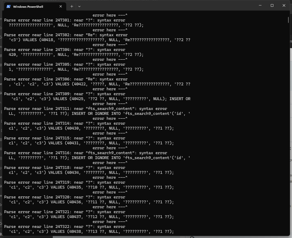

KizunerE 0 Posted October 5, 2024 Posted October 5, 2024 My media library is not displaying any images, and the logs show some errors like 'SQLitePCL.pretty.SQLiteException.' I tried to follow the tutorial to repair the database, but the sqlite3 tool reports some error like: "Parse error near line 320596: near "UserDataKeys2": syntax error ES (53610, 'Person-?????); INSERT OR IGNORE INTO 'UserDataKeys2'('Id', 'UserDa error here ---^" How can I fix this? I also found that the new episodes added to my media library are not having their Episode Intros added. Even when I manually execute the scan task, it always returns 0 seconds. Is this also an issue caused by database corruption?
