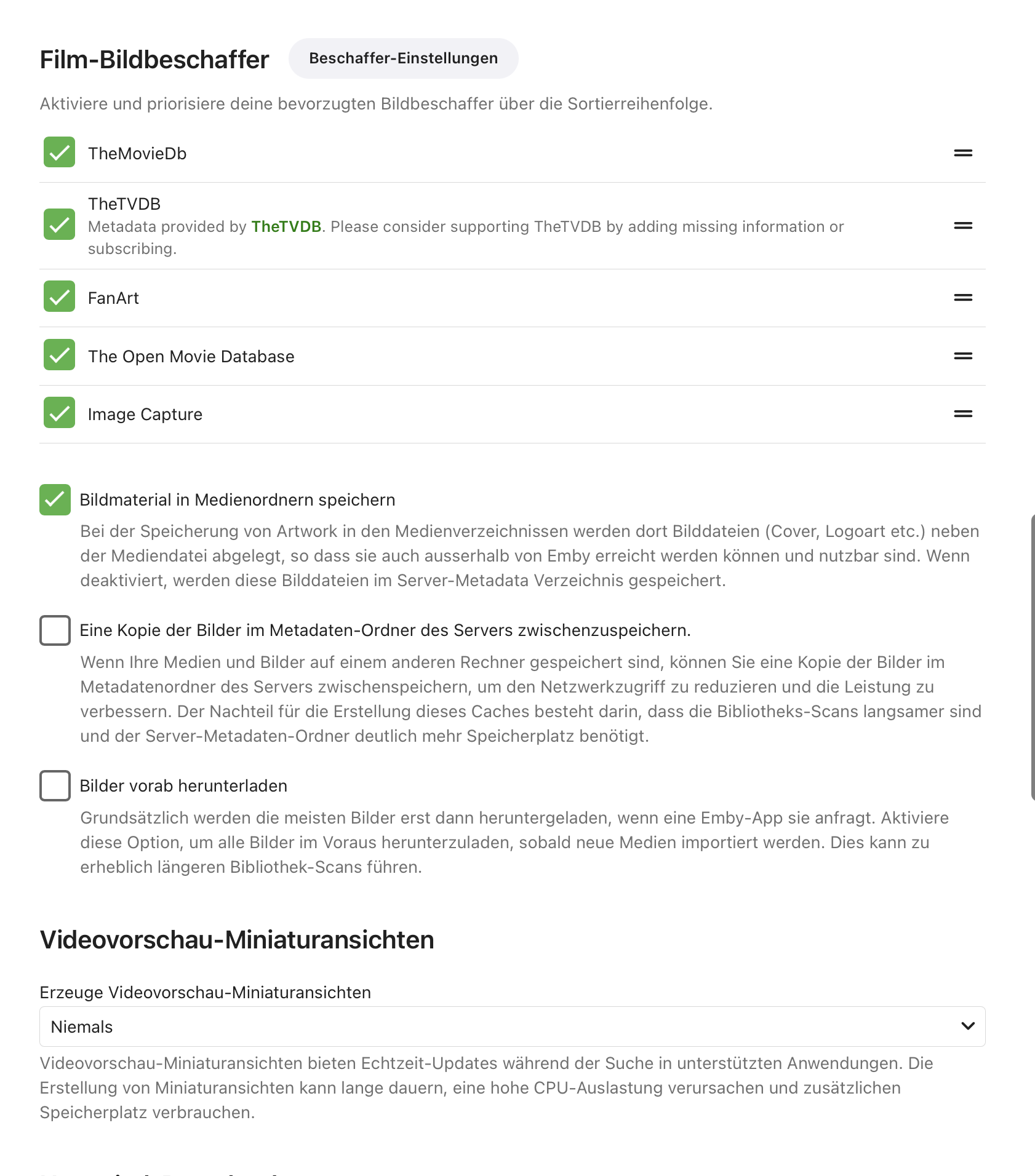

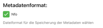

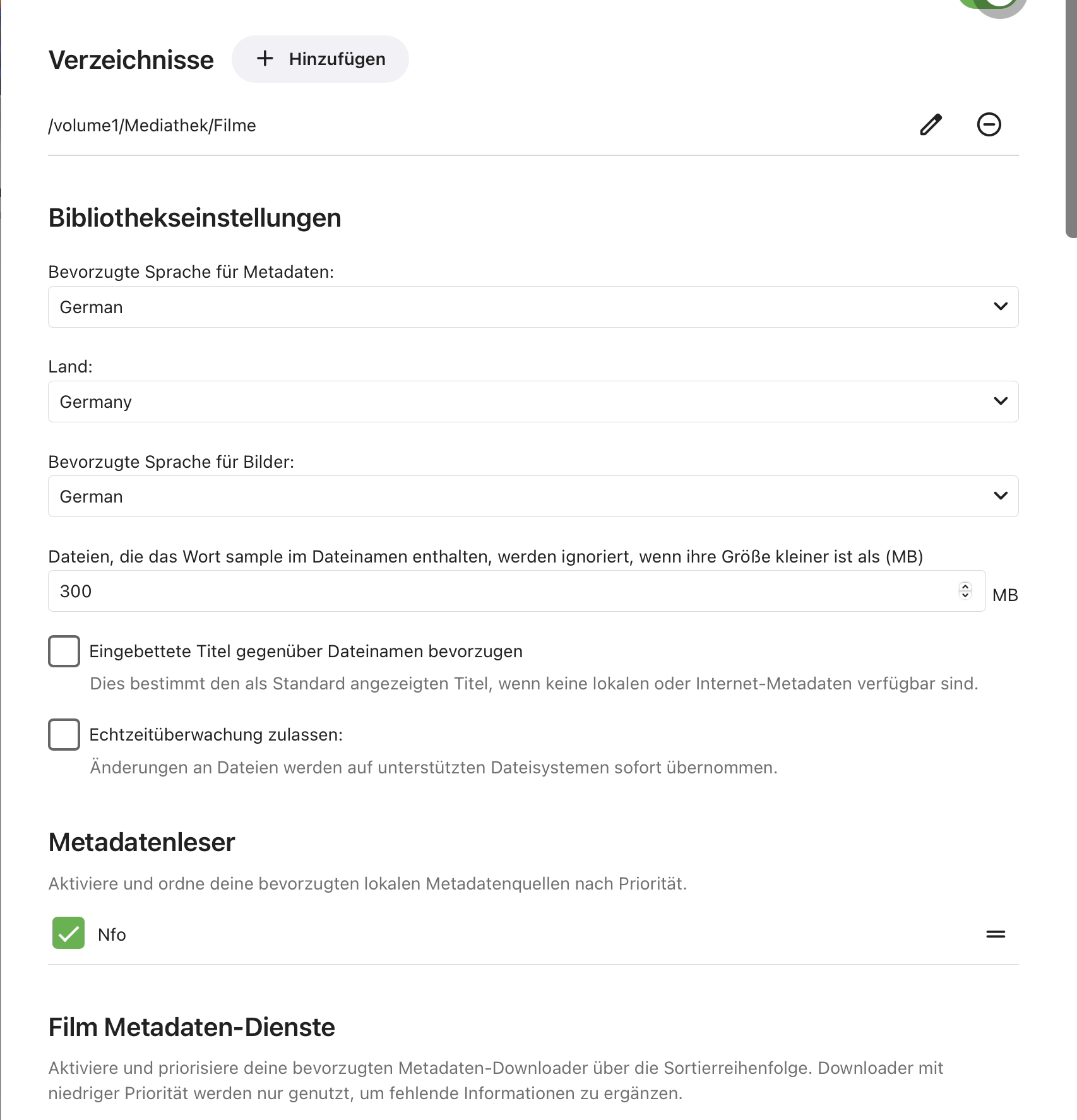

Hello everyone,

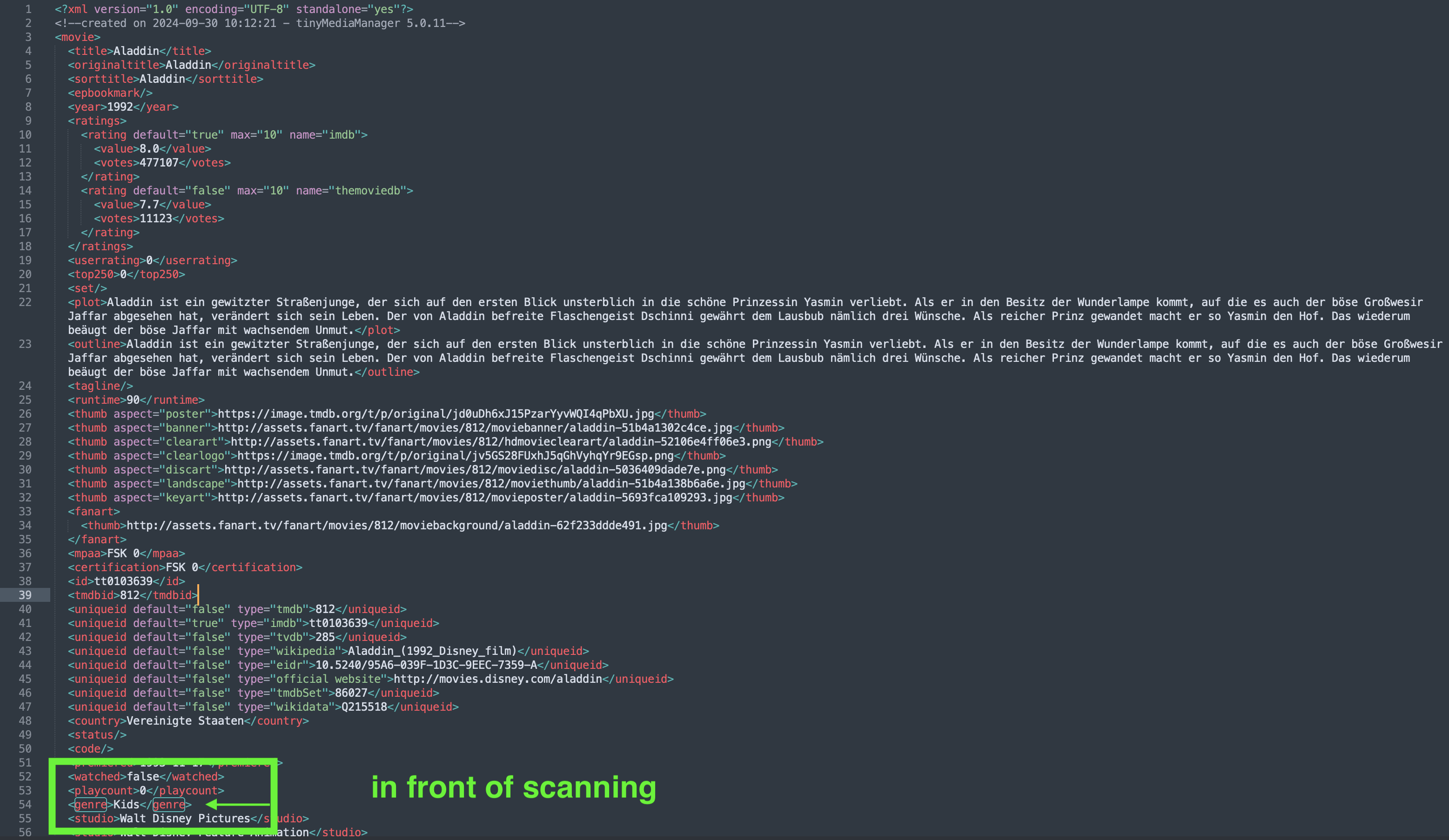

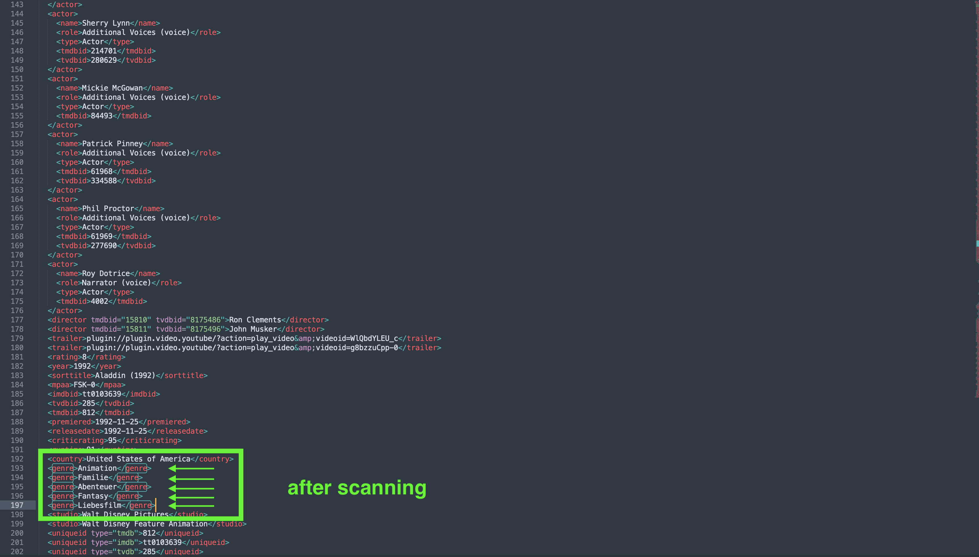

I have the problem that after updating the library my NFO is changed.
I have set my data so that I only have 1 genre per movie, but when I update the library, this is overwritten.
Is this a bug or have I set it wrong?

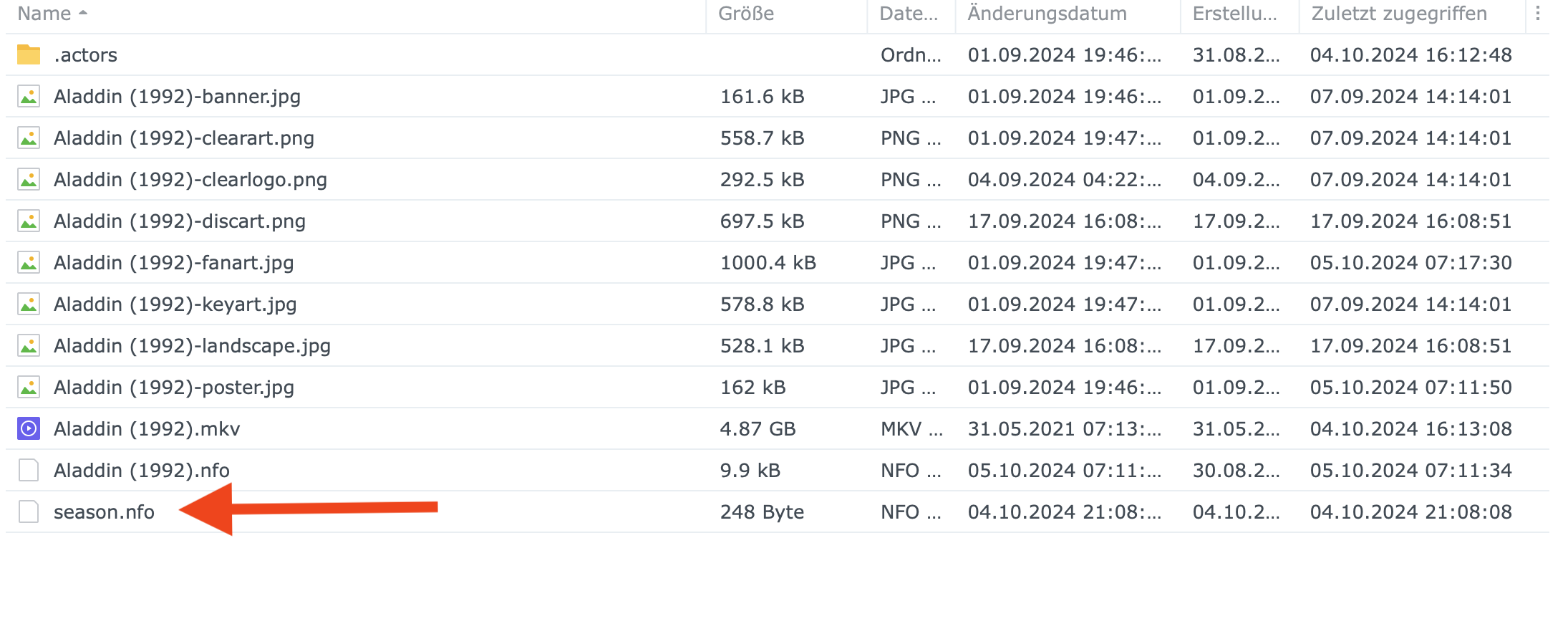

Also, I noticed that all my movies have a “Season.nfo” even though the movies were all recognized correctly.

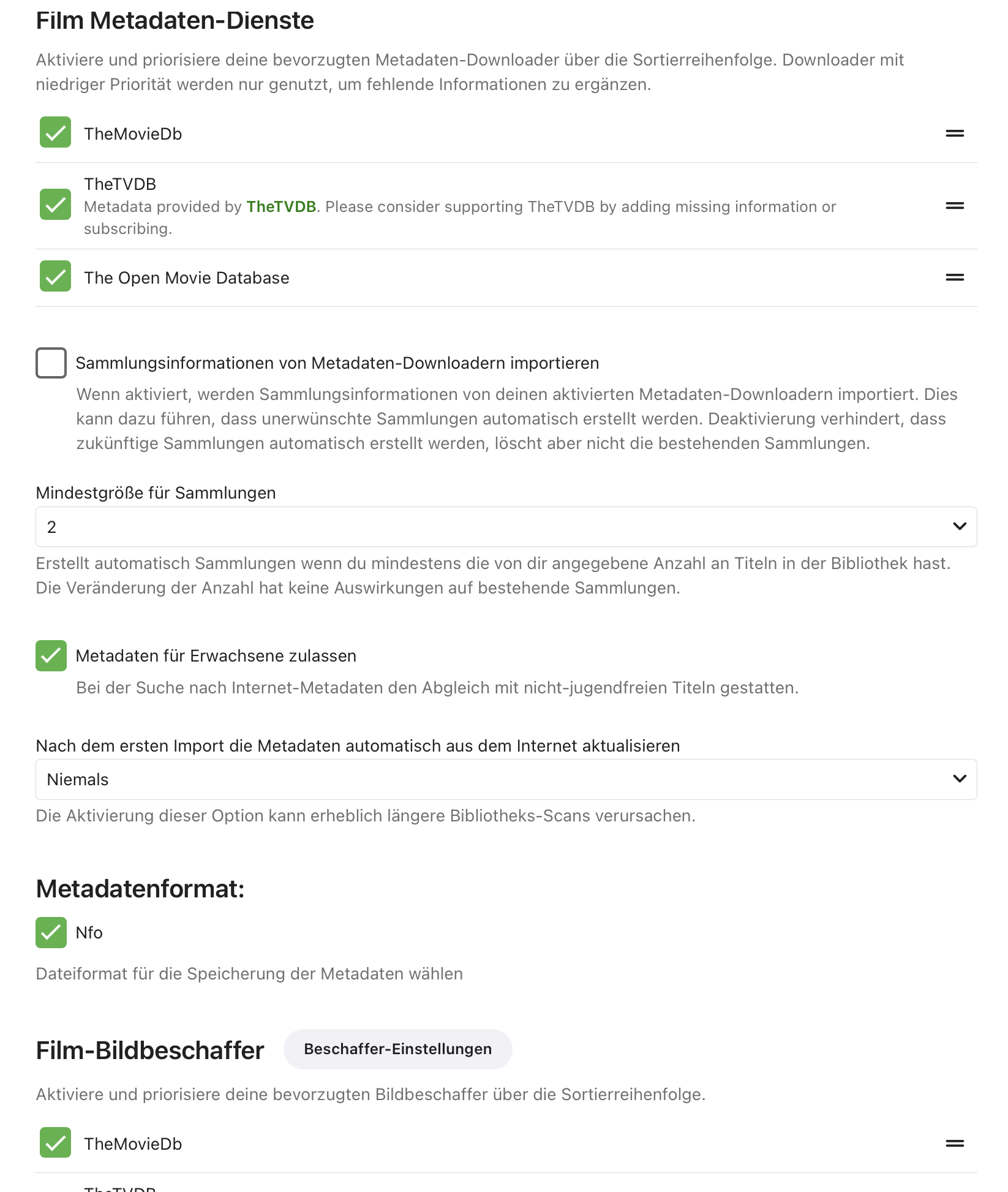

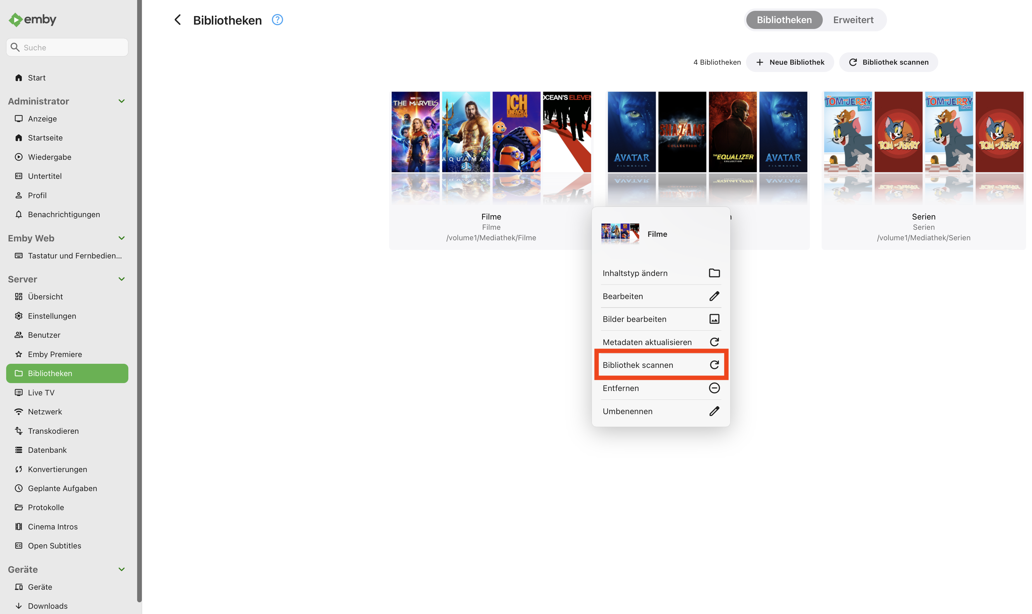

Bildschirmfoto2024-10-05um07_23_37.thumb.png.615492ca0e473ae657cd6b84b182cae9.pngBildschirmfoto2024-10-05um07_24_56.thumb.png.3d56d0794e84444a1e70464d2513e673.pngBildschirmfoto2024-10-05um07_25_08.thumb.png.9f4ca7bcb8e1513da1c9677a0bb4a0d7.pngBildschirmfoto2024-10-05um07_25_19.thumb.png.769398b7ef710cc52bc0dcec1b9465a6.png
Bildschirmfoto2024-10-05um07_31_21.thumb.png.da01912fd3caa3c31b1e04ac95fdc1c2.pngBildschirmfoto2024-10-05um07_32_06.thumb.png.6a946d4760ce8960563750e81d5e332d.pngBildschirmfoto2024-10-05um07_30_24.thumb.png.70f9a9221eb33a4459c900de6711fd37.png
Edited by Workstation
Neminem
You have this activated.
That will alter your nfo files, when you update metadata.
  • Like 1

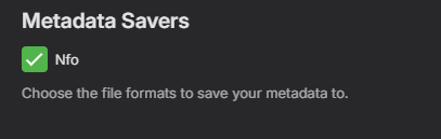

Neminem
You can't do that with Emby, as fare as I know.
If save to Metadata Savers "nfo" i enabled it will save changes.
You would need to make the nfo files in another program, that supports emby.
And disable emby Metadata Savers "nfo"
But you could set nfo files to read only, but that would give you errors in your logs, that would fill up your log drive.

Neminem
Disable this option and try again.

Also keep in mind that enabling nfo reading but not nfo saving can lead to other quirks, such as changes made in Emby getting lost later because they're not written anywhere. I would generally suggest keeping those two values the same.
  • Agree 1

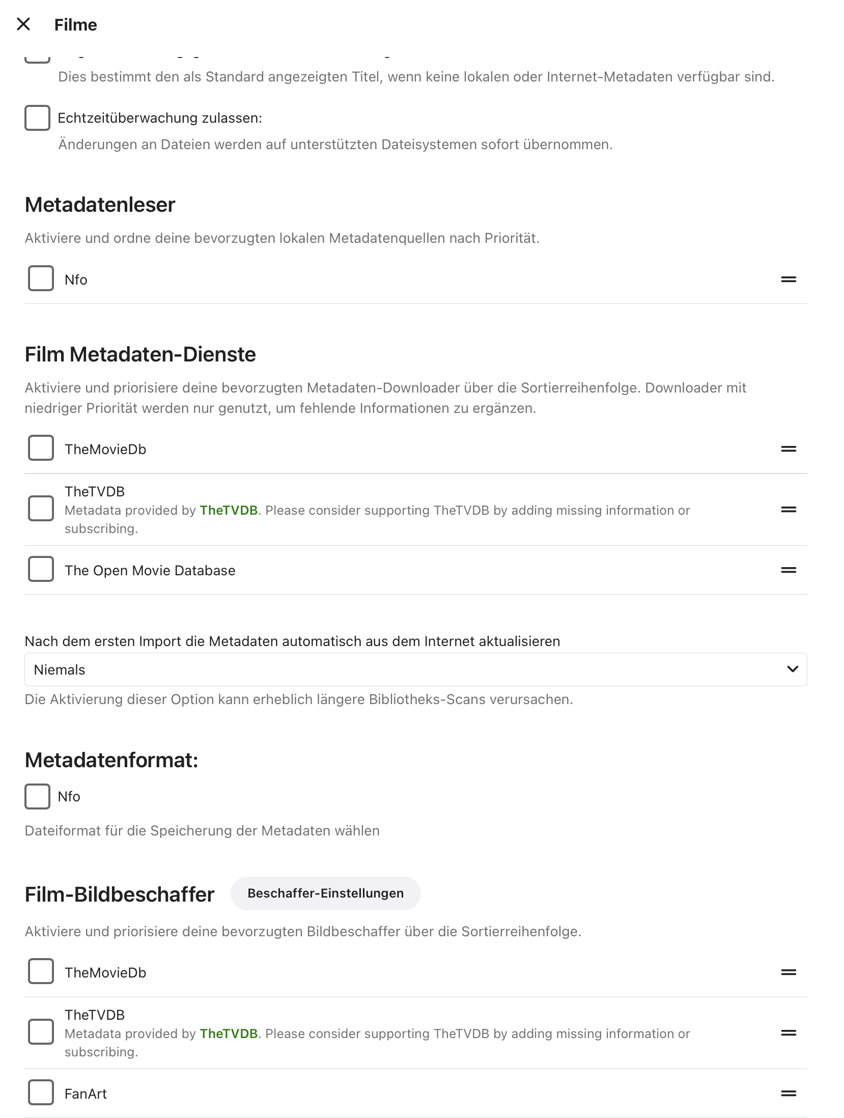

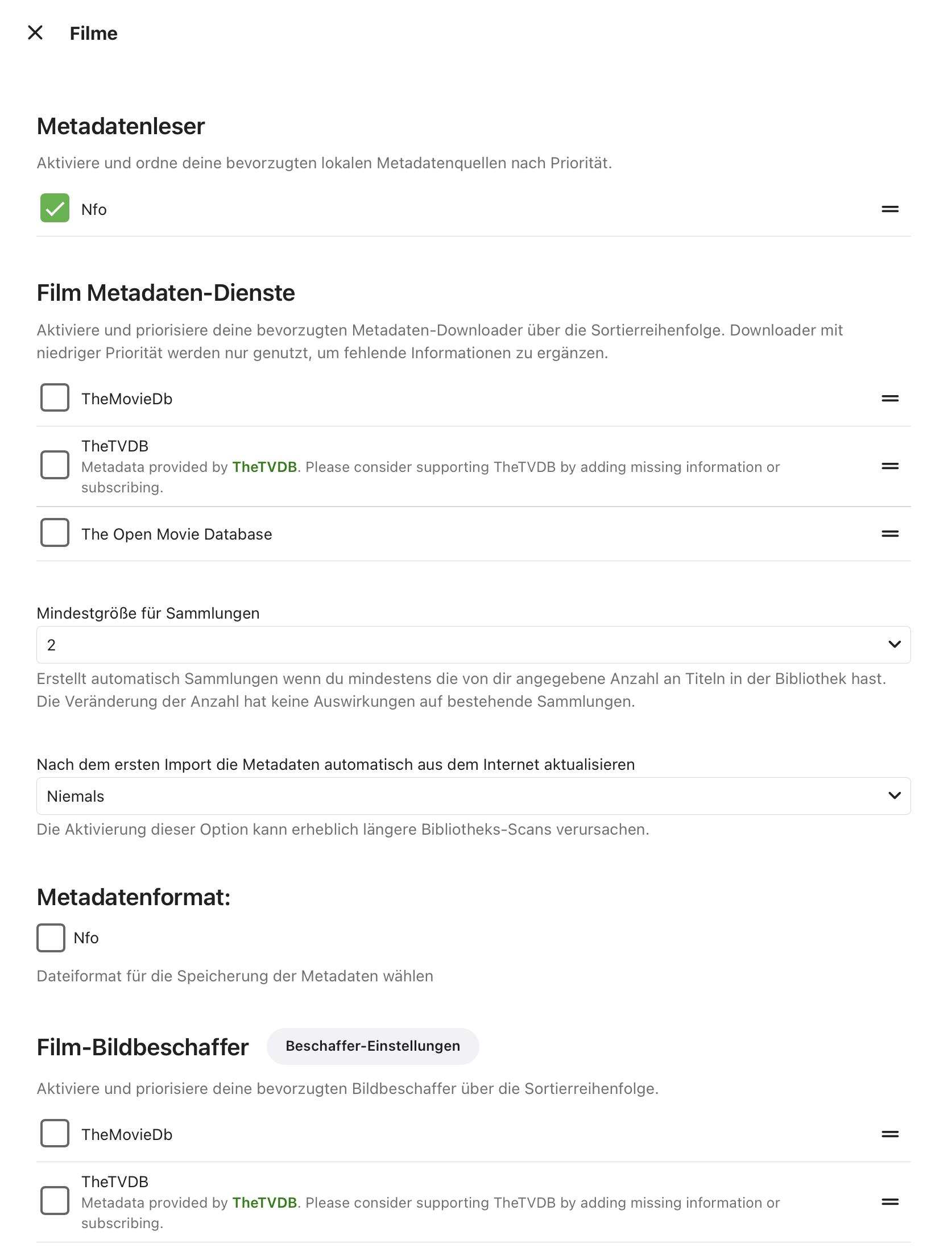

Workstation
I have now set it like this.

And with everything disabled what would you like Emby to do as it can not read any existing metadata or get any metadata?
Workstation
Sorry, then I misunderstood.
With the setting he found the movie and the pictures, but no genre, for example.
Now I've set it that way and it looks like everything worked.
It has recognized all the data from TinyMediamanager and so far has not destroyed my database.

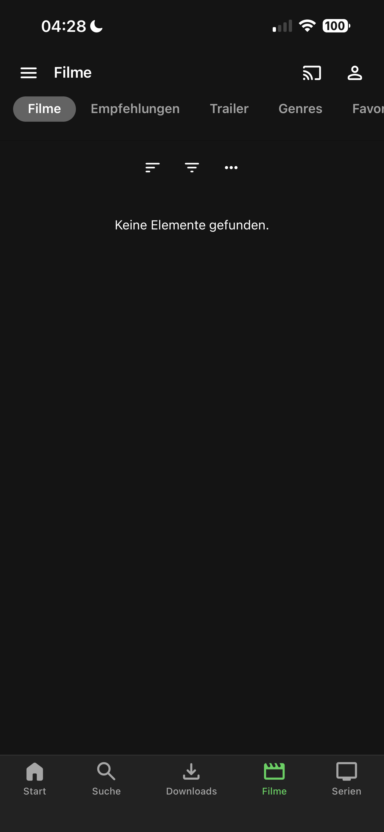

Now my entire media library is gone again overnight even though I haven't changed anything. It was the same yesterday. The Same also like the picture Is on Mac and Apple TV.
Something is going wrong here.
There must be a way to just scan my library and not change anything.
This is the simplest function that every other programme can do.
But it would also be fine if Emby scanned everything, but then kept my genre. I only ever use 1 genre per film. I don't have this problem with series.
