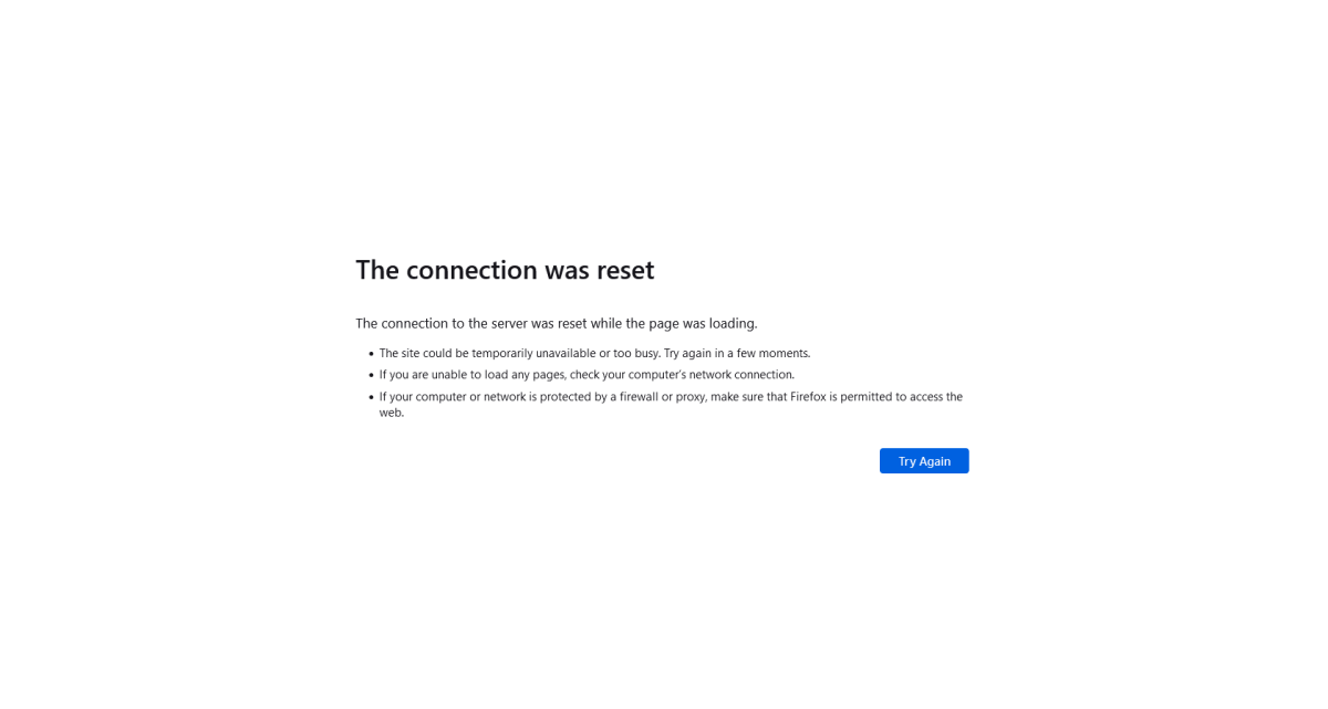

AmyB0001 1 Posted October 4, 2024 Author Posted October 4, 2024 Sorry I'm unfamiliar with Curl language. Do I need to download software? I have uninstalled pretty much everything except emby now. Still the same. Also this is the error message I'm getting:
rbjtech 5335 Posted October 4, 2024 Posted October 4, 2024 curl is just a command line executable - it's built into Windows 10 & 11. It's a utility to send http requests - GET or POST for example - so you can send Emby API tasks etc. In the above example - it's just sending Emby a 'hello' and Emby should reply with a HTTP/1.1 302 Found
