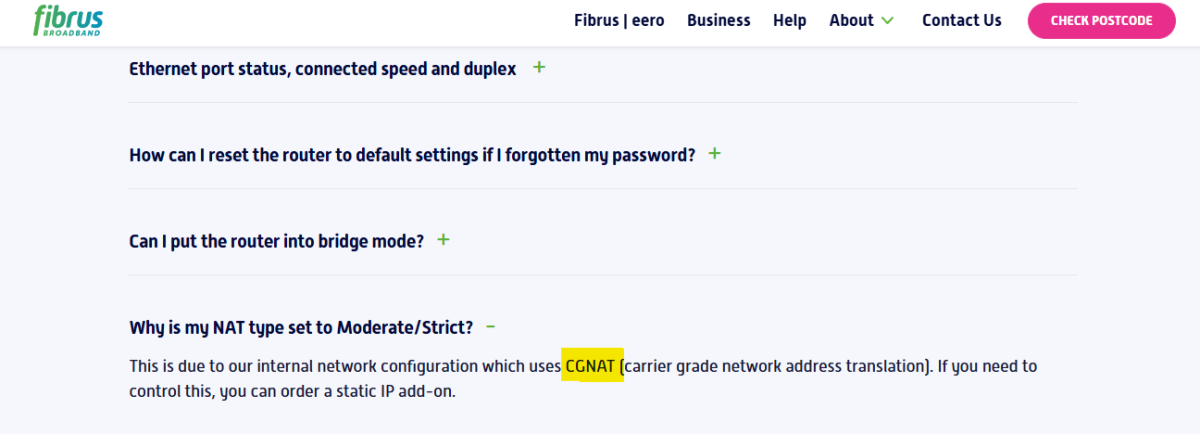

rcsnoopdog 17 Posted October 4, 2024 Author Posted October 4, 2024 3 hours ago, rbjtech said: Yes - you are now using CGNAT .. I was talking to Fibrus & it seems i am & i would have to pay £5 FOR A STATIC IP address, so was wondering is there any other way around this for cheaper?

rcsnoopdog 17 Posted October 4, 2024 Author Posted October 4, 2024 9 hours ago, Carlo said: https://emby.media/support/articles/Remote-Setup.html Check the section "Verify Public IP and Port". Carlo I was talking to Fibrus & it seems i am & i would have to pay £5 FOR A STATIC IP address, so was wondering is there any other way around this for cheaper?

Solution Carlo 4564 Posted October 4, 2024 Solution Posted October 4, 2024 2 hours ago, rcsnoopdog said: Yes thanks I'm trying to read everything & understand but, would a free account on here work for me it says limited to 3 users but i don't really know what this means, i have about 5 different households i want to give remote access to with probably 4 or 5 tv's in each & maybe loads of phones & tablets, will i be able to do that with a free account Hi, Save yourself the headaches of trying to make this work as Tailscale isn't going to work with a lot of devices. Pay the £5 FOR A STATIC IP address and be happy that's all they charge. Carlo 1
rcsnoopdog 17 Posted October 4, 2024 Author Posted October 4, 2024 1 minute ago, Carlo said: Hi, Save yourself the headaches of trying to make this work as Tailscale isn't going to work with a lot of devices. Pay the £5 FOR A STATIC IP address and be happy that's all they charge. Carlo I think your right because i have been checking all the other ISP'S in my area & it would still be cheaper with the extra £5 1
