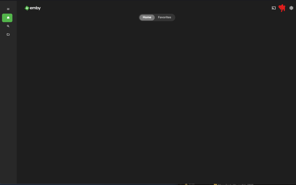

mammt 5 Posted October 3, 2024 Posted October 3, 2024 Hello, I have been using Emby for a while, and it was working fine. However, I recently switched from the Emby Beta to the normal Emby build with the same configuration. I had Emby rebuild the whole library by deleting library.db, library.db-shm, and library.db-wal. After remaking the entire library and scanning it again, the process took around 10-12 hours to complete. However, my Emby home screen is now empty for some reason. I tried accessing it on the web version, iOS version, and smart TV, and it’s empty on all of them. embyserver.txt

mammt 5 Posted October 3, 2024 Author Posted October 3, 2024 (edited) forgot to attach a screen showing the empty home screen for reference, here is it. Edited October 3, 2024 by mammt

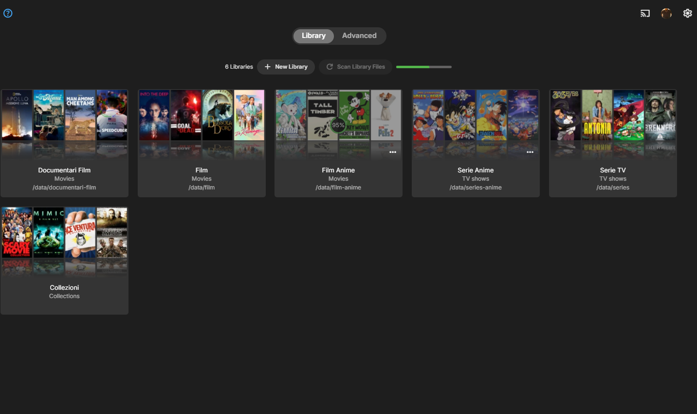

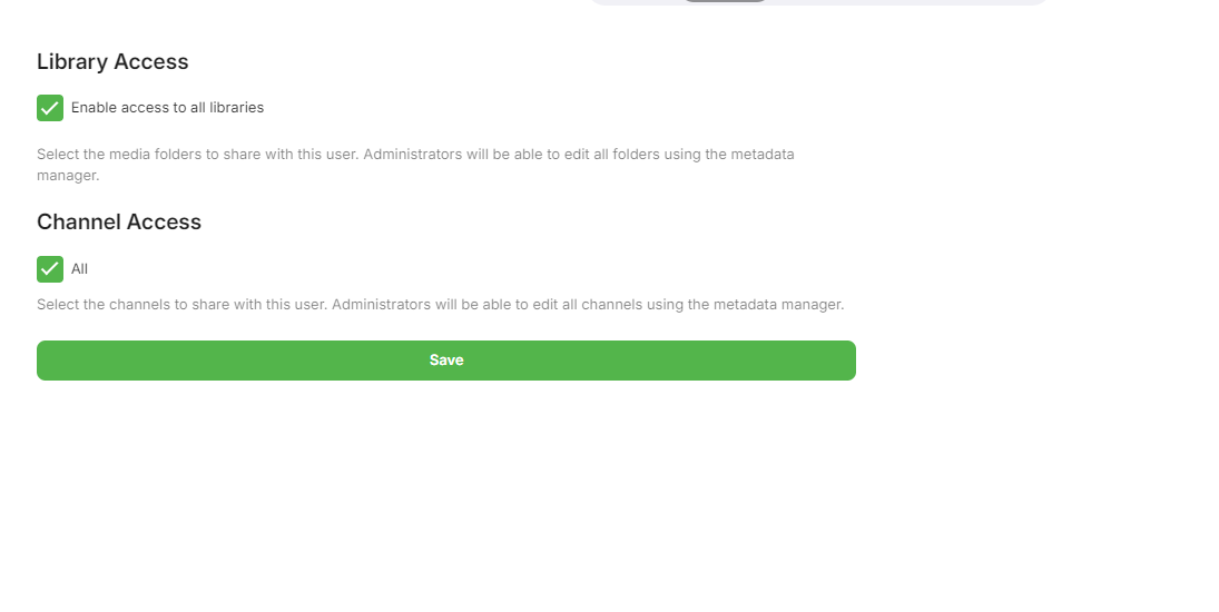

GrimReaper 4843 Posted October 3, 2024 Posted October 3, 2024 (edited) Does your user have permissions to view those libraries (Settings>Users tab in the sidebar>edit desired user>Access tab)? Edited October 3, 2024 by GrimReaper
mammt 5 Posted October 3, 2024 Author Posted October 3, 2024 31 minutes ago, GrimReaper said: Does your user have permissions to view those libraries (Settings>Users tab in the sidebar>edit desired user>Access tab)? yes,
ebr 16306 Posted October 3, 2024 Posted October 3, 2024 Hi. Something is very broken as your log is full of these: ResourceNotFoundException: Resource not found. Type: LibraryItem, Id: 164764 Probably related to your attempt to move from beta and only replacing the library.db. There must've been some other components that changed. I would suggest a full fresh install.

Happy2Play 9798 Posted October 3, 2024 Posted October 3, 2024 Yep there were/are permissions issues when adding only the users.db as the library.db usershares table will have issues also. But toggling Access and Parental Controls on each user corrected the no displayed libraries on Home screen but shows in library setup in my testing. This is one reason there needs to be a reliable way to export and import users on a NEW setup. But don't think a reliable way can exist with how user permissions exist. 1
