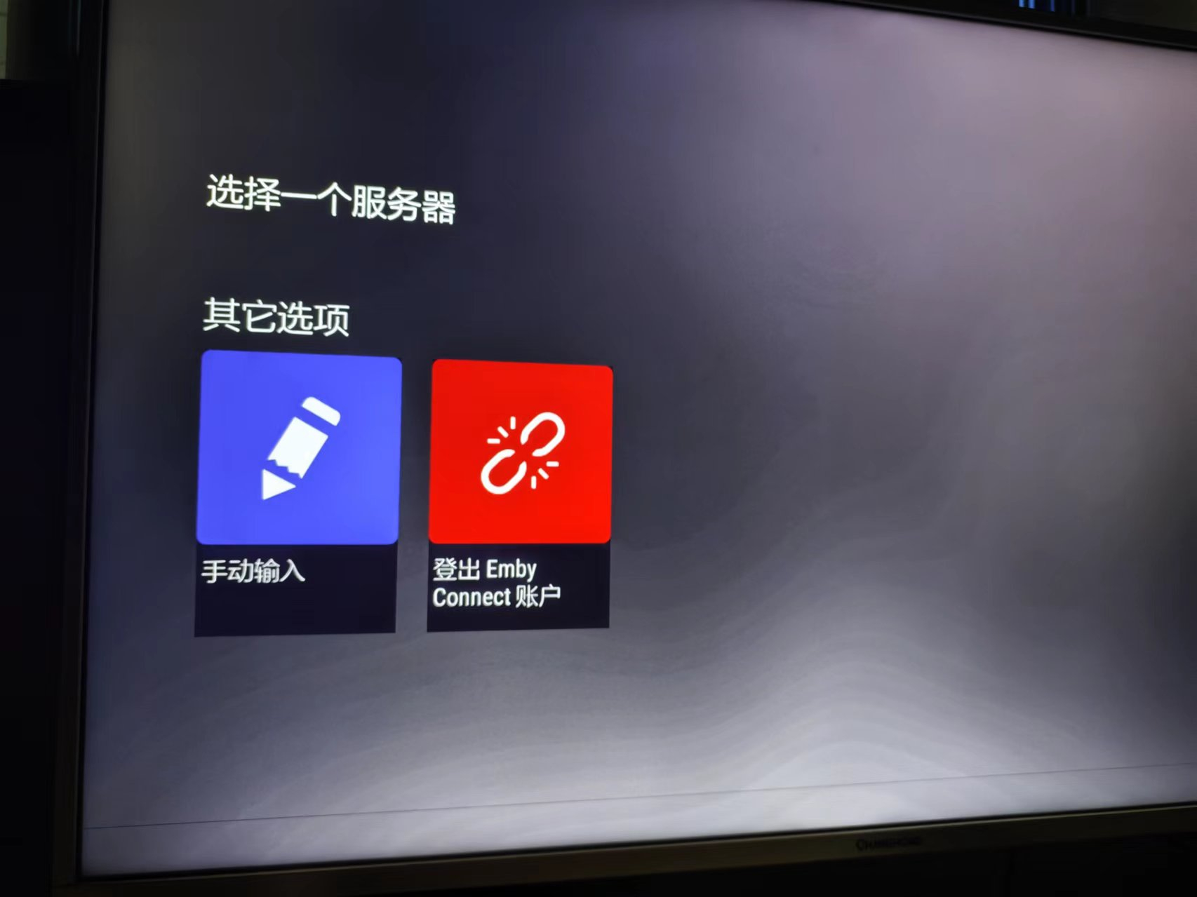

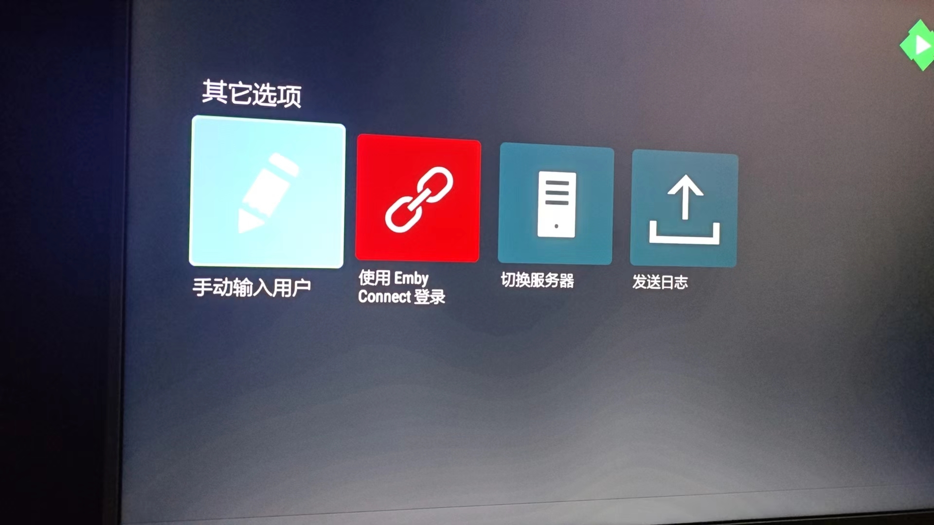

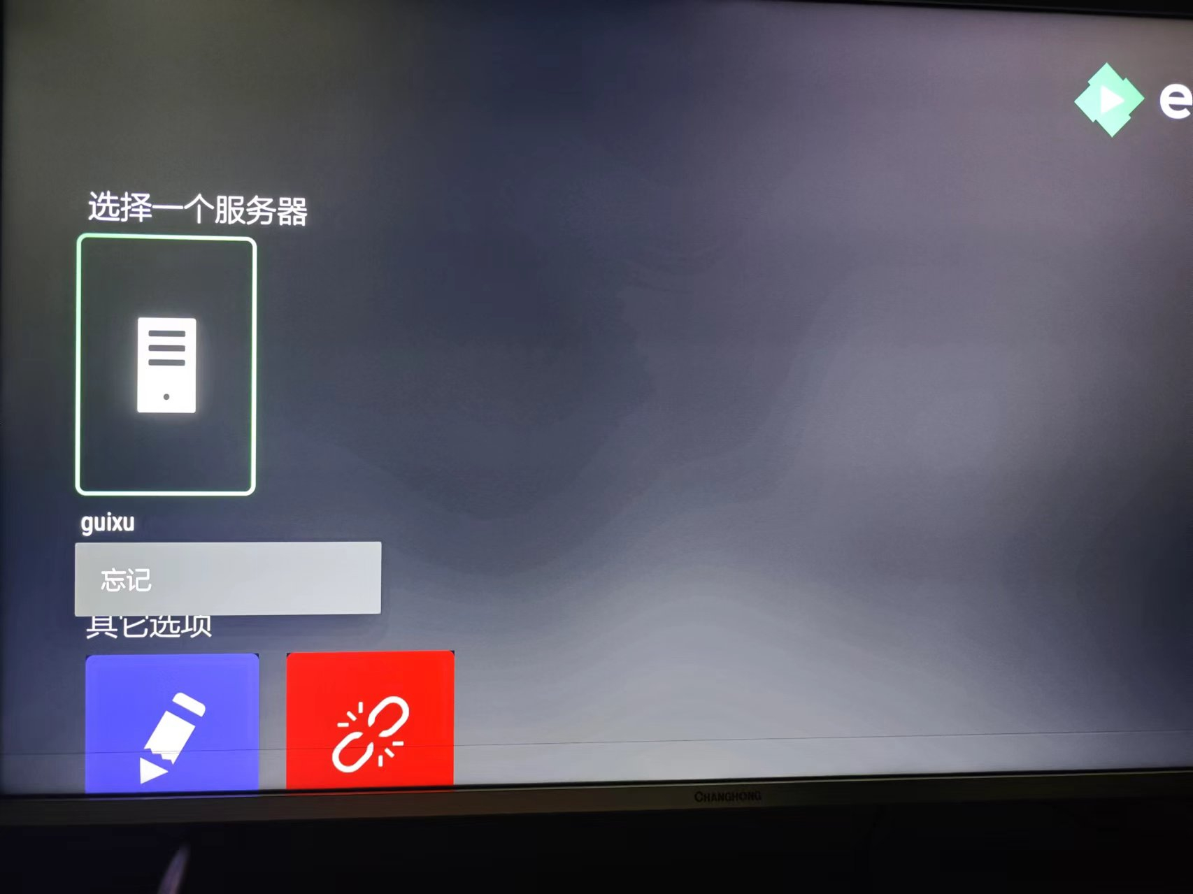

kirota 0 Posted October 2, 2024 Author Posted October 2, 2024 at first, The way enter the user manually and the way emby connect work well , but when select the server option for the first picture - forget (忘记), neither of these will work. Manually enter the user's way, will enter the interface of the second picture, infinite loop, can not display the media library. In the emby connect mode, will enter the screen of the third image, without showing the server. I can guarantee that the ip address, port number, user name and password I input are correct, because I changed a mobile emby app and it can enter the server normally, but this Android TV app cannot work properly. I feel that you did not read the details I wrote above, but just extracted the keywords with ai and simply replied, and this keyword is still wrong.
