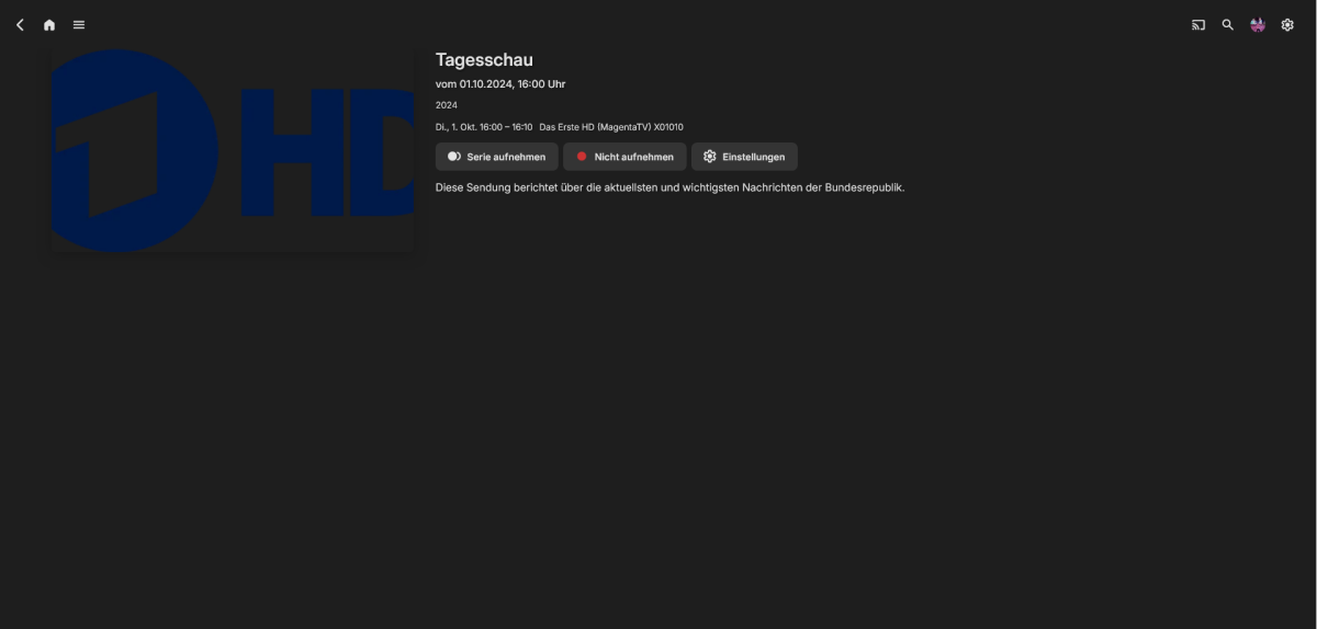

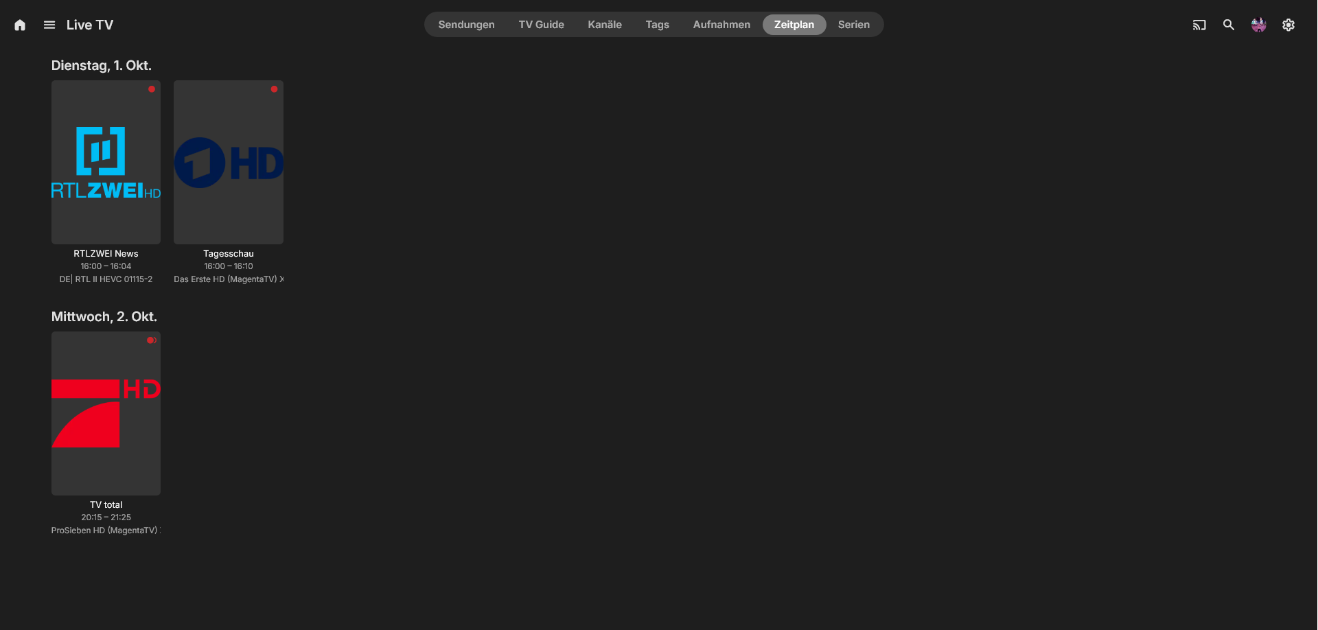

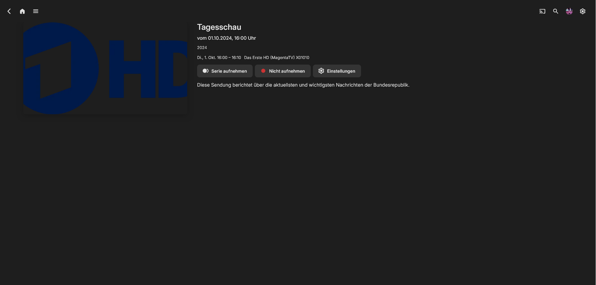

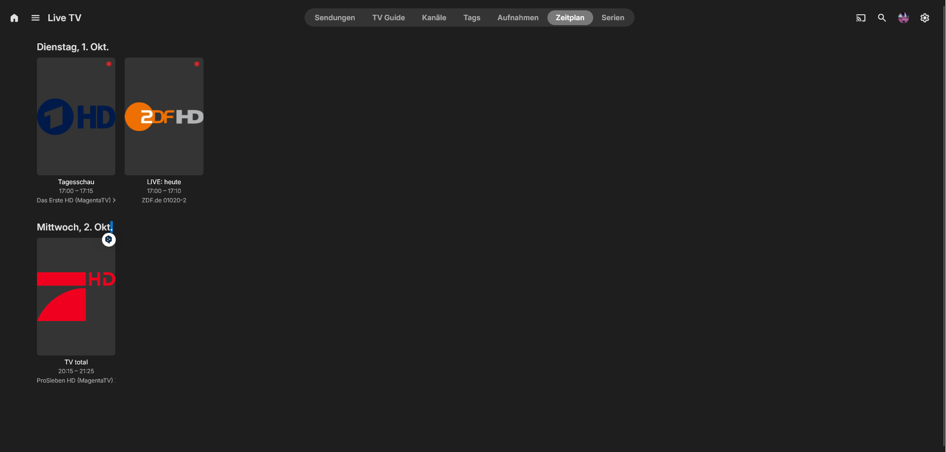

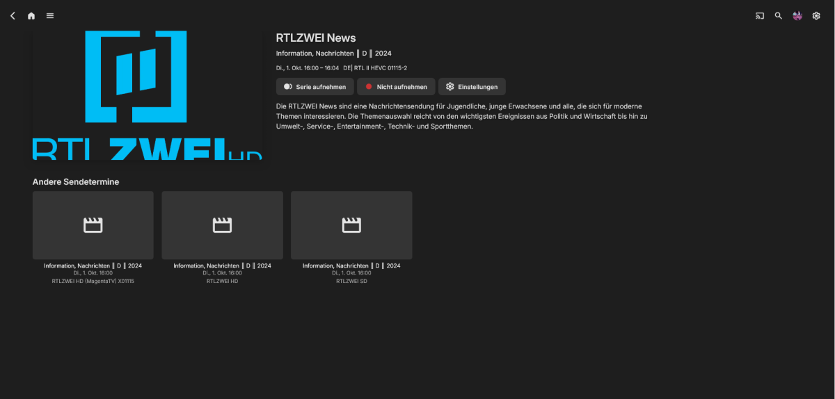

tomadick 8 Posted October 1, 2024 Posted October 1, 2024 (edited) Hello, unfortunately, I'm having a problem with Emby again. I’ve scheduled multiple recordings, but they didn’t start in the end. As a test, I scheduled several short recordings today, but only one of them started. What could be causing this issue? The recordings that worked: RTLZWEI News 2024_10_01_16_00_00 Information, Nachrichten und LIVE today 2024_10_01_17_00_00 - from 01.10.2024 at 5:00 PM. No worked: Picture 2, picture 4 and the first recording on picture 5 What I suspect: I have divided the channels into multiple tags. The recordings I programmed directly from the TV guide under "All" seemed to work, but when I schedule recordings from the "Live TV Backup" tag, they don't seem to start. Maybe this helps in troubleshooting the issue. Images and log attached. embyserver.zip Edited October 1, 2024 by tomadick
