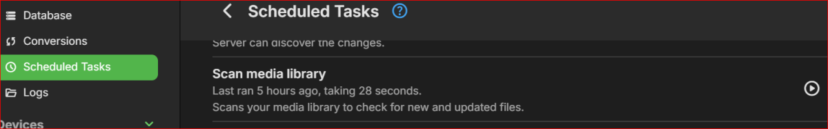

TMCsw 260 Posted November 7, 2024 Posted November 7, 2024 (edited) 3 hours ago, mrsmithb said: Well the thing is....it worked, flawlessly. For YEARS. Then I started having problems. And it still works SOMETIMES, but it doesn't seem to last long. Perhaps, you disabled/changed the schedule for this? at some time in those YEARS? Edited November 7, 2024 by TMCsw added in
mrsmithb 11 Posted November 7, 2024 Author Posted November 7, 2024 9 hours ago, TMCsw said: Perhaps, you disabled/changed the schedule for this? at some time in those YEARS? Confused as to what you mean by this. I have changed the SCHEDULED media library scan, but that's because I want Real Time Monitoring to do the work, so that a scheduled scan is not necessary. RTM should be completely independent of this setting??
