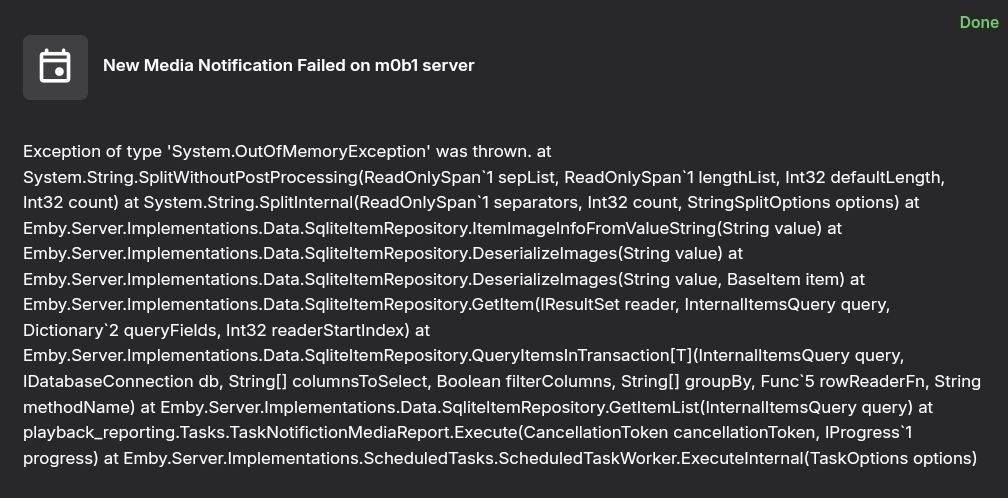

mrsmithb 11 Posted November 4, 2024 Author Posted November 4, 2024 What I've noticed over the past week is that RTM works sometimes, but often doesn't. I finally got around to turning on debugging, reseting the server, adding new content. And of course, RTM worked this time. Does it maybe work for some time after a server reset? Not sure. I did notice something new. There was an alert that I had never seen before, from 11/2. I know that RTM was not functioning before I reset the server, so I'm wondering if this may be related. I've attached a copy of the screenshot below (tried to copy and paste the text, it wouldn't let me). Searching back through the alerts, I found maybe one or two more examples of this going back several months.
kbeck 64 Posted November 4, 2024 Posted November 4, 2024 13 minutes ago, mrsmithb said: What I've noticed over the past week is that RTM works sometimes, but often doesn't. I finally got around to turning on debugging, reseting the server, adding new content. And of course, RTM worked this time. Does it maybe work for some time after a server reset? Not sure. I did notice something new. There was an alert that I had never seen before, from 11/2. I know that RTM was not functioning before I reset the server, so I'm wondering if this may be related. I've attached a copy of the screenshot below (tried to copy and paste the text, it wouldn't let me). Searching back through the alerts, I found maybe one or two more examples of this going back several months. Mine also started working about an hour after restarting. Will see how long it lasts.

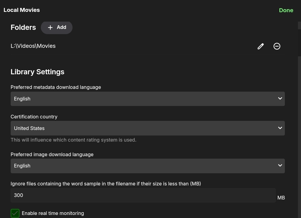

Luke 42289 Posted November 6, 2024 Posted November 6, 2024 5 hours ago, mrsmithb said: Alright @Luke, @Carlo...giving this another try. Yesterday as I mentioned, I made sure that debugging logging was turned on, then rebooted the server. Shortly after I added a new piece of media to the folder that houses my movie library, and RTM immediately picked it up and added it to the emby server.. Last night I noticed that RTM appeared to be not working again. So this morning I added the following .mp4 at 09:06 L:\Videos\Movies\Breaking.Away.1979\Breaking.Away.1979.mp4 Waited an hour. RTM did not pick up anything. So at 10:06 I ran a manual scan of the movie library. The movie was then added to the library as expected. I've attached the log. embyserver (2).txt 1.83 MB · 0 downloads HI, are you sure you have the realtime monitor enabled on that library? Can you show us what your library options look like?
mrsmithb 11 Posted November 6, 2024 Author Posted November 6, 2024 It's a HDD on my NAS. The server is on a separate min-PC.
Carlo 4561 Posted November 6, 2024 Posted November 6, 2024 1 hour ago, mrsmithb said: It's a HDD on my NAS. The server is on a separate min-PC. There's the answer. Realtime update depends on the OS making a notification that programs can respond to. The OS only sends this notification for files on disk that it manages. This doesn't work for network attached storage.
Luke 42289 Posted November 6, 2024 Posted November 6, 2024 One thing you could try is using the original network location with Emby Server, rather than the mapped drive. Maybe it will work without having that extra layer.
