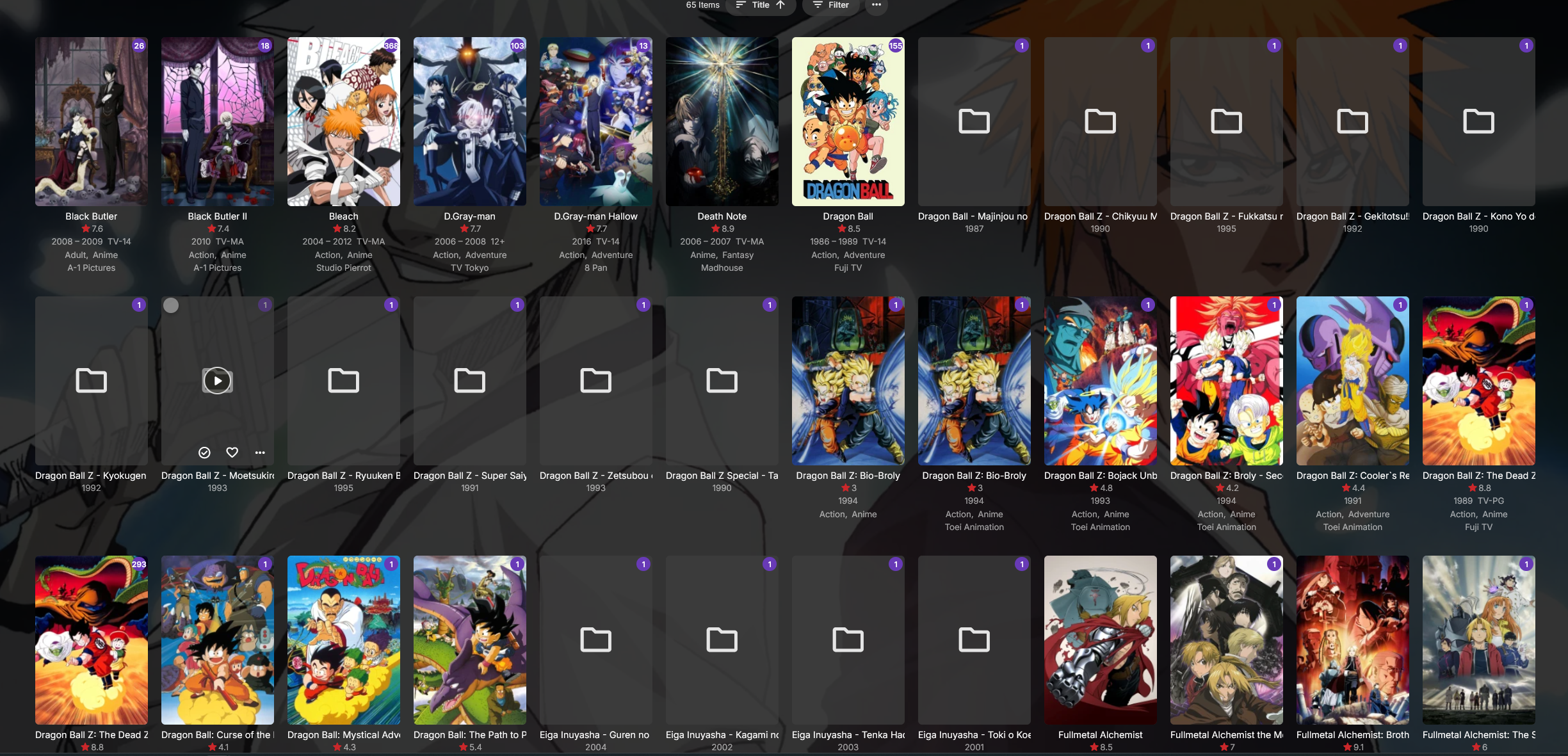

CheshireKitten 1 Posted October 1, 2024 Posted October 1, 2024 Anime DB Tiles are not being matched correctly or at all despite the AniDB ID being in the name of the movies and the name of the film being in its original language matching AniDB. Is there any way to fix this otherwise I have to go into each title and fix it manually... Unfortunately, it's like it was NOT made for anime as it only does half the work for me and even creates more work for me. i did not find anything on this subject when I did a quick search. I attached one example although it's not a good one as I fixed most of the issues and afraid to reset the metadata at this point as I manually matched 20+ titles.

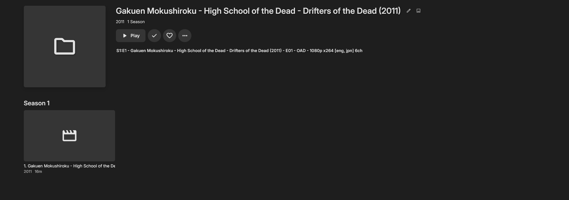

CheshireKitten 1 Posted October 1, 2024 Author Posted October 1, 2024 (edited) a better example. it didn't match it at all despite everything being there. Edited October 1, 2024 by CheshireKitten lack of info

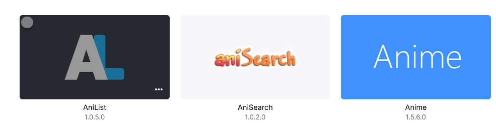

CheshireKitten 1 Posted October 22, 2024 Author Posted October 22, 2024 I tried all sorts of arrangements of the metadata fetchers but this is the current arrangement and this is what my library looks like.

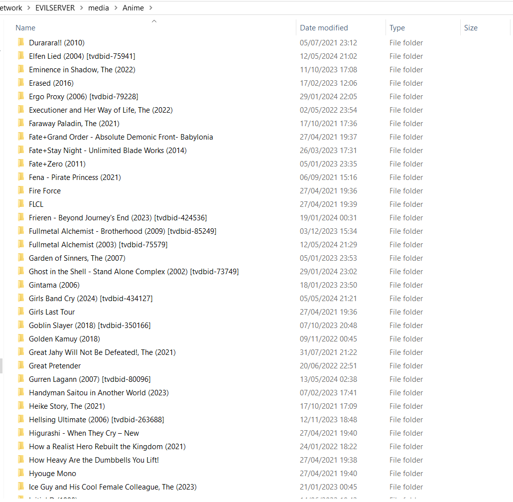

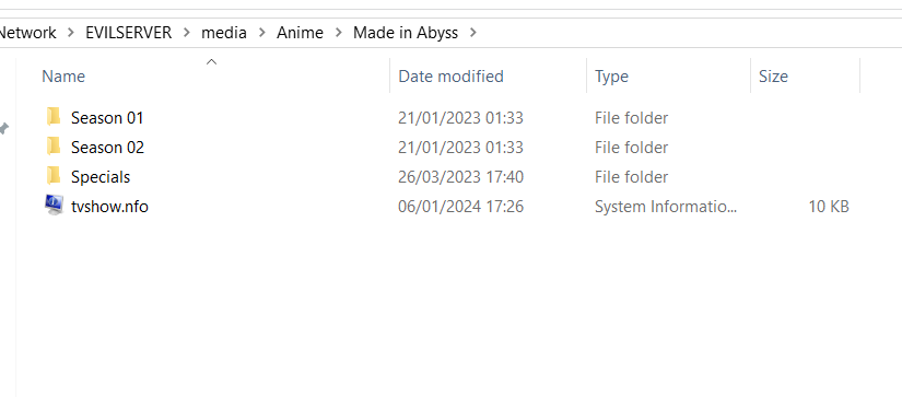

evil_crab 23 Posted October 23, 2024 Posted October 23, 2024 Here's my config and folder structure if it helps 1
Solution pwhodges 2036 Posted October 23, 2024 Solution Posted October 23, 2024 I found it best to ignore the anime providers added by the plugins and just use TVDB. I have over 450 anime series (some little known) and 200 anime films, and TVDB/TMDB recognises every one of them. Maybe a couple of dozen I had to tweak the naming to match or add the tvdbid/tmdbid to the folder name, but that ensures correct recognition remains for any future rescans (except for the non-zero series that TVDB has renumbered between the times I've needed to rescan!). Paul
