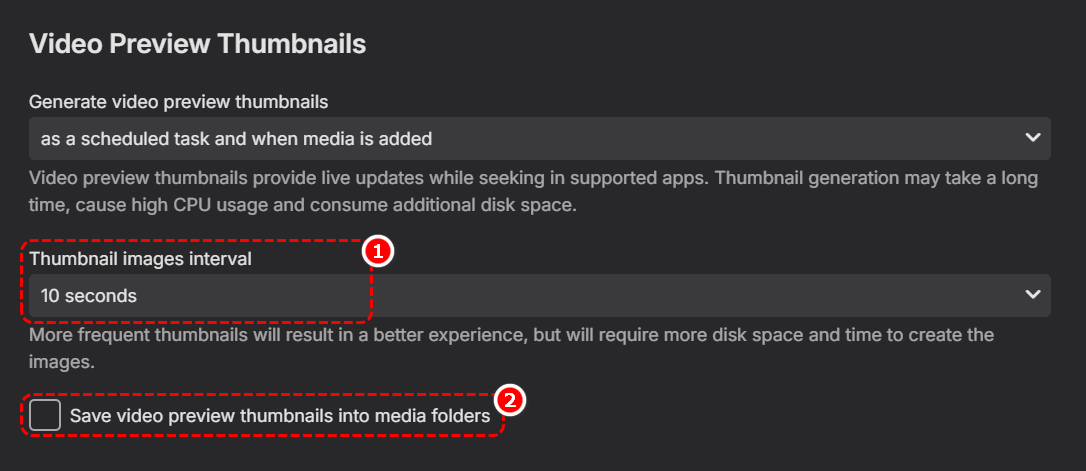

rcsnoopdog 17 Posted October 1, 2024 Posted October 1, 2024 Hello my name is Richard I have been doing video preview thumbnail extraction & have checked Save video preview thumbnails into media folders.So i was under the impression that these bif files would be filling up my external drives & not the SSD 220GB c/ Drive where inside the metadata library folder i have found bif files. I have 2 gb left on c/ drive & the video preview thumbnail extraction has not been finished, what should i do ? Emby Server on windows 10 pc wired directly to the router with 10 external hdds with 29gb of media, 19gb of the 29gb are tv shows & the rest Movies Please help Thank you
Statick 15 Posted October 1, 2024 Posted October 1, 2024 the option you've checked is to save artwork into media folders, which means downloaded artwork when scraping. there's no option to save video preview thumbnails into media folders, they just go into metadata
rcsnoopdog 17 Posted October 1, 2024 Author Posted October 1, 2024 19 minutes ago, Statick said: the option you've checked is to save artwork into media folders, which means downloaded artwork when scraping. there's no option to save video preview thumbnails into media folders, they just go into metadata No your wrong as there is 2 options & i have both checked 1. Save video preview thumbnails into media folders 2. Save artwork into media folders also a third in a sense which i have checked also & i am aware it saves jpgs in metadata folder on C/ Drive not bif files 3. Keep a cached copy of images in the server's metadata folder
Gilgamesh_48 1252 Posted October 1, 2024 Posted October 1, 2024 (edited) 33 minutes ago, Statick said: the option you've checked is to save artwork into media folders, which means downloaded artwork when scraping. there's no option to save video preview thumbnails into media folders, they just go into metadata That is not correct there is a separate check box for that but it only appears if you enable the create option and you may have to have advanced options enabled. I do not know for sure about the advanced options. These are the rows that show on my server: Video Preview Thumbnails Generate video preview thumbnails Never as a scheduled task as a scheduled task and when media is added Video preview thumbnails provide live updates while seeking in supported apps. Thumbnail generation may take a long time, cause high CPU usage, and consume additional disk space. Thumbnail images interval 10 secondsChapter markers More frequent thumbnails will result in a better experience, but will require more disk space and time to create the images. Save video preview thumbnails into media folders Playback My bif files get saved into media folders just as the settings imply. There are possible reasons that it fails but the developers will need to see logs to know exactly why. Edited October 1, 2024 by Gilgamesh_48 Improper formatting

seanbuff 1440 Posted October 1, 2024 Posted October 1, 2024 @rcsnoopdogif Gilgamesh's text example wasn't clear, you only get an additional check box after you have selected '10 seconds' as the interval, tick the box that appears below for BIF files to be stored alongside their media files:

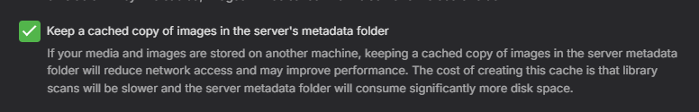

Happy2Play 9840 Posted October 1, 2024 Posted October 1, 2024 (edited) 2 hours ago, rcsnoopdog said: 3. Keep a cached copy of images in the server's metadata folder This is what is filling your C drive as you are doubling everything ie images and bif files. So with media and Emby cache. example 2024-09-30 01:08:18.330 Info ChapterImagesTask: Caching file from Q:\DOCUMENTARIES\War Game (2024)\War Game (2024)-320-10.bif to C:\Users\rcsno\AppData\Roaming\Emby-Server\programdata\metadata\library\00\00ebc9de82832fc3a8fa2357961e04d2\thumbnailcache\War Game (2024)-320-10.bif Edited October 1, 2024 by Happy2Play added image 1 1
rcsnoopdog 17 Posted October 1, 2024 Author Posted October 1, 2024 8 hours ago, seanbuff said: @rcsnoopdogif Gilgamesh's text example wasn't clear, you only get an additional check box after you have selected '10 seconds' as the interval, tick the box that appears below for BIF files to be stored alongside their media files: I have all these boxes checked 1. Save video preview thumbnails into media folders 2. Save artwork into media folders also a third in a sense which i have checked also & i am aware it saves jpgs in metadata folder on C/ Drive not bif files 3. Keep a cached copy of images in the server's metadata folder
rcsnoopdog 17 Posted October 1, 2024 Author Posted October 1, 2024 7 hours ago, Happy2Play said: This is what is filling your C drive as you are doubling everything ie images and bif files. So with media and Emby cache. example 2024-09-30 01:08:18.330 Info ChapterImagesTask: Caching file from Q:\DOCUMENTARIES\War Game (2024)\War Game (2024)-320-10.bif to C:\Users\rcsno\AppData\Roaming\Emby-Server\programdata\metadata\library\00\00ebc9de82832fc3a8fa2357961e04d2\thumbnailcache\War Game (2024)-320-10.bif I understand that keeping a cached copy of images fills my C/ Drive which is what i want as i presume it makes it easier to scroll through when accessing remotely but why is it doubling the bif files as i have the option checked to save in media folder was it because it ran out of room on the external hdd the media was placed in & started filling up my C/ Drive. So i want to know is that what Emby does & if so can i just delete them and make sure the extra room is there on the external hdd's & start again

Solution Happy2Play 9840 Posted October 1, 2024 Solution Posted October 1, 2024 (edited) The caching option will occupy both with media and in cache if the options are enabled. Yes you can delete bif files whenever you want but per library configured options they will be regenerated. If your drives are local preemptive caching is somewhat useless. Edited October 1, 2024 by Happy2Play
rcsnoopdog 17 Posted October 1, 2024 Author Posted October 1, 2024 20 minutes ago, Happy2Play said: The caching option will occupy both with media and in cache if the options are enabled. Yes you can delete bif files whenever you want but per library configured options they will be regenerated. If your drives are local preemptive caching is somewhat useless. But just for images not video preview bif files if i have enough room on external Drives to hold them I have all these boxes checked 1. Save video preview thumbnails into media folders 2. Save artwork into media folders 3. Keep a cached copy of images in the server's metadata folder ( I am aware it saves jpgs in metadata folder on C/ Drive which is what i want not bif files So when i delete bif files from metadata folder C/ Drive & i have enough room on external hdd's to hold all bif files required for media on that drive, then the bif files should not show up in metadata folder C/ Drive Correct.
Happy2Play 9840 Posted October 1, 2024 Posted October 1, 2024 (edited) Bif are cached also for all those network media user that want the best of both worlds. So if you save with media it will save with cache also. Edited October 1, 2024 by Happy2Play 1

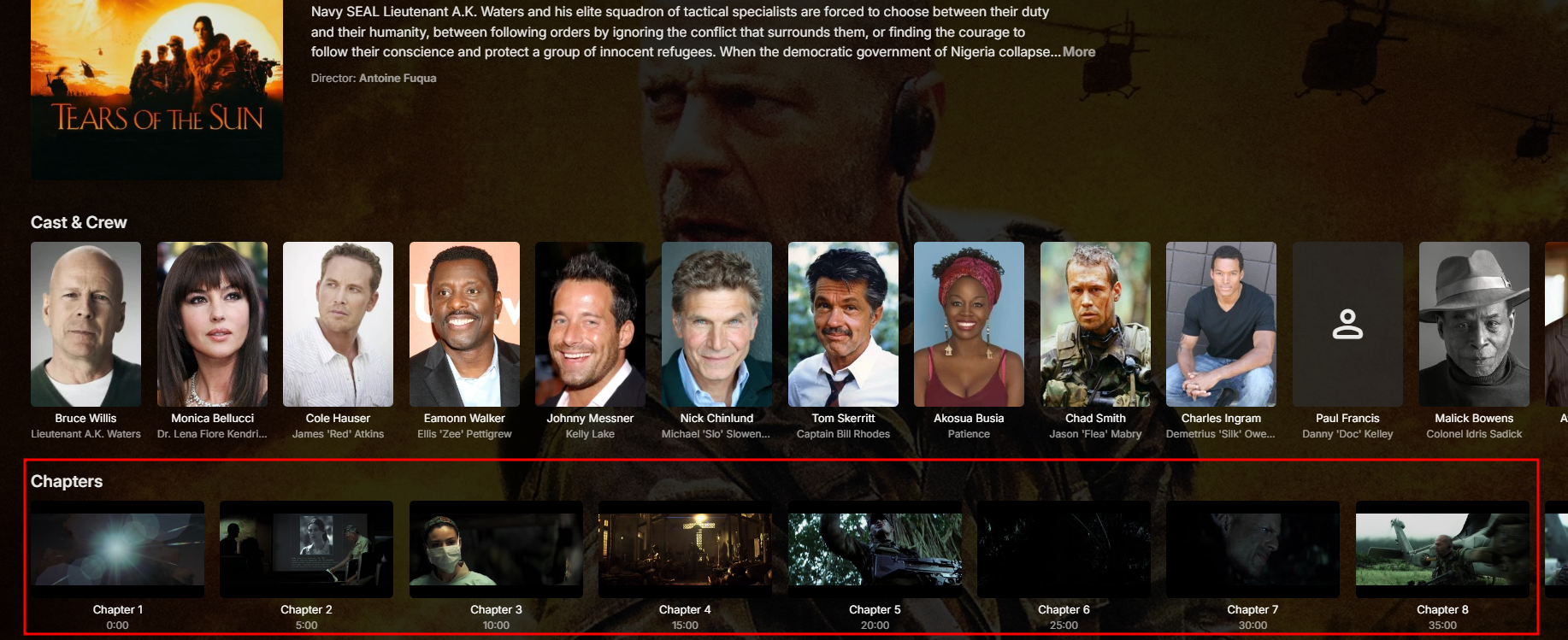

Happy2Play 9840 Posted October 1, 2024 Posted October 1, 2024 (edited) I guess if you want to get technical bif files are used for display also as your Chapter image do come from that bif file if you write them. So that can be just as important as a normal jpg. Edited October 1, 2024 by Happy2Play 1
Neminem 1960 Posted October 1, 2024 Posted October 1, 2024 (edited) @Happy2Play is right. I would hate it if my diskes started to spin, if users browsing into a movie to see details. And here is where BIF files are shown, as chapters. If understand this correctly ? Edited October 1, 2024 by Neminem 1
