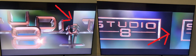

Hispanico957 23 Posted September 30, 2024 Posted September 30, 2024 I have a Nviida Shiel Pro and EMBY has compatibility problems with mkv movie with HDR+ and Dolby. As you can see from the 2 images the screen is double, while with hdr video this does not happen. I try also aoothers playe as VLC or others and this problem not appear. There a way to solve it without recoding movie ?? Thank Hispa

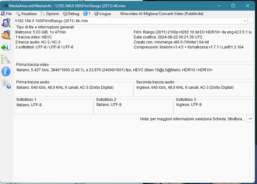

Hispanico957 23 Posted October 4, 2024 Author Posted October 4, 2024 (edited) Here there is log, playing these movies on my FireTV 4K MAX 2° gen: Deadpool & Wolverine (2024) 4K.mkv Rango (2011) 4K.mkv Blink Twice (2024) 4K ...always black screen, with sound and no navigation. I try both version Emby Android and Emby TV PLS help me Thank hardware_detection-63863647632.txt embyserver (1).txt Edited October 4, 2024 by Hispanico957
Solution rbjtech 5335 Posted October 4, 2024 Solution Posted October 4, 2024 (edited) It's a known issue on any hardware using that chipset (SoC) - the issue is because of the HDR10+ and DV combo. The way around it is to remove the HDR10+ and just use HDR10/DV or HDR10+ only. Google is your friend on ways to do this - but it's a quick process. I believe Kodi have implemeted a workaround where it dynamically remuxes the file to remove the HDR10+ metadata.. https://forum.kodi.tv/showthread.php?tid=371557 Edited October 4, 2024 by rbjtech 2
