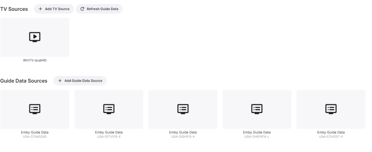

Kpizzle 3 Posted September 25, 2024 Posted September 25, 2024 Hello all I purchased an Emby subscription this morning and I was able to get my live tv functioning so that’s awesome. My issues is I can’t get the guide to populate I just have an error saying no program data. I’m using the Emby guide over the air with my zip code. I’ve reason some where about creating an m3u file, support asked me if I have mapped my channels? What am I missing ?

Kpizzle 3 Posted September 25, 2024 Author Posted September 25, 2024 I added about 5 Tuner's and try to do a refresh guide and nothing seems to populate. When I do hit refresh guide it acts like its not getting anything like its not even a second and it just drops out.

Luke 42184 Posted September 25, 2024 Posted September 25, 2024 Hi, do you have Emby premiere? If so, have you checked the channel mappings on the channel management screen?
Kpizzle 3 Posted September 25, 2024 Author Posted September 25, 2024 5 minutes ago, Luke said: Hi, do you have Emby premiere? If so, have you checked the channel mappings on the channel management screen? Yes I do have premier. I can access live tv without issues I just don’t have data in my guide. I don’t know about the channel mappings maybe that’s where I’m falling short.
Luke 42184 Posted September 26, 2024 Posted September 26, 2024 Try clicking on the channels tab in live TV setup. You may need to map them manually.
