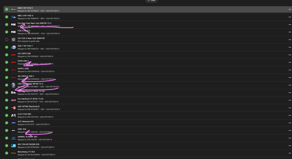

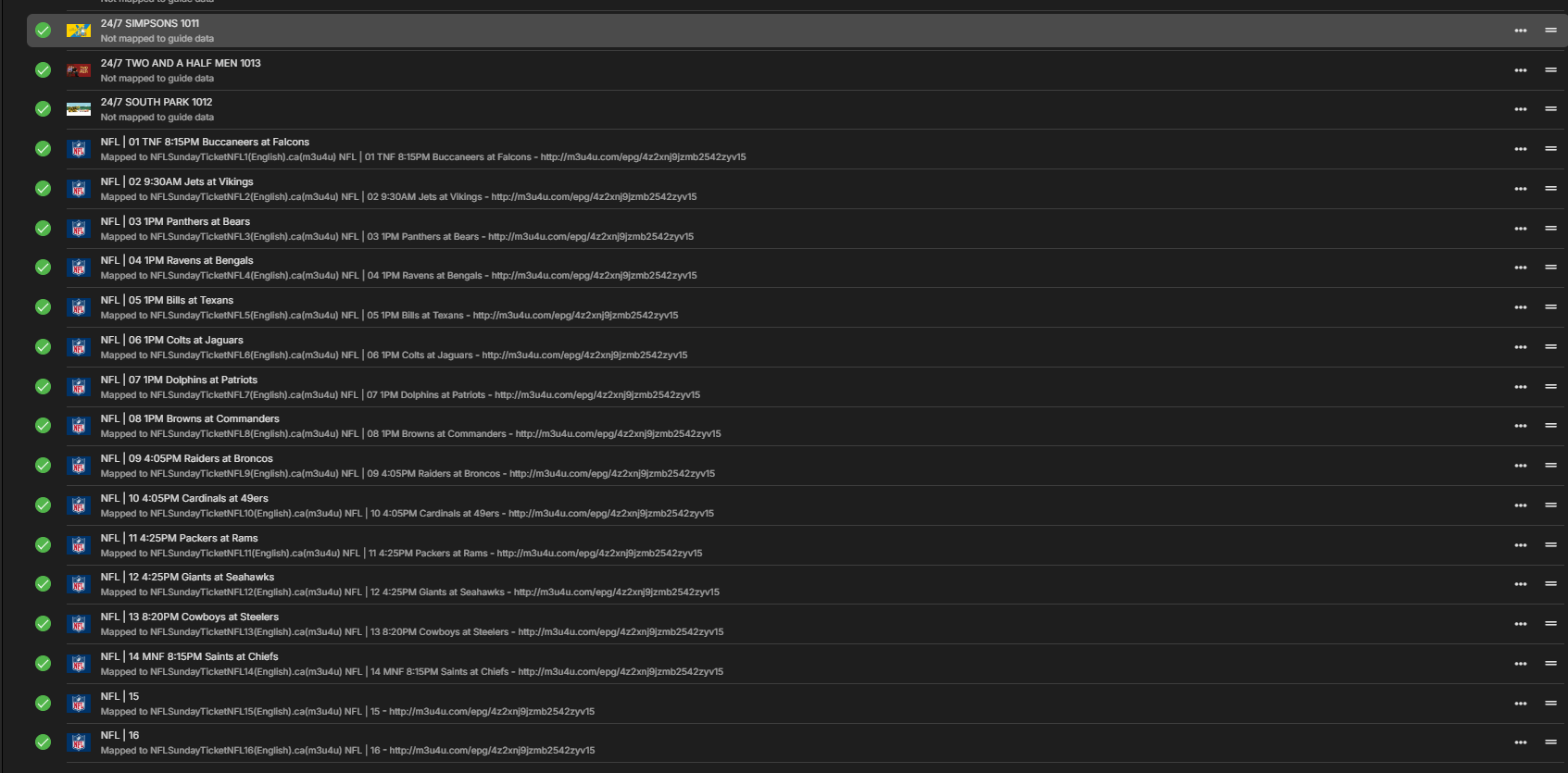

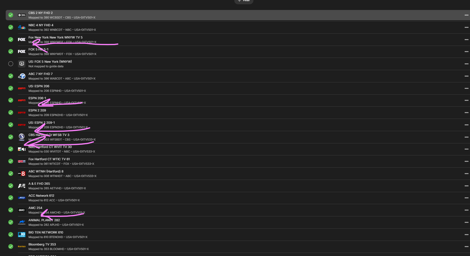

CharlesF 37 Posted October 3, 2024 Author Posted October 3, 2024 (edited) So unfortunately, because I am so type A, as soon as it happens (the random reordering) i manually put it back, but hopefully this gives you an idea.... All of those NFL channels I have manually placed at the bottom of the list...when the channel names change, and i come back in to this view (or the guide), the NFL channels are randomly inserted in the existing channel lineup throughout, there is no rhyme or reason, so the arrows represent where the NFL channels get re-ordered, although not exactly because each week its different, and they get placed randomly throughout the channel list....there has never been a case where one of the NFL channels stayed at the bottom of the list...the second screenshot shows how I place the NFL channels at the bottom of the list each week after the randomization occurs Edited October 3, 2024 by CharlesF
Luke 42241 Posted October 3, 2024 Posted October 3, 2024 This is probably the issue right here: #EXTINF:-1 tvg-id="" tvg-name="NFL | 02 " tvg-logo="http://apk.eternaltv.net/icons/nfl-logo.jpg" group-title="NFL",NFL | 02 Notice the empty tvg-id. Without that value, how does the server know it's the same channel as before? So what's happening is, the channel is not being reordered, but rather, they are being removed entirely from your server database and then being added back again with a new name. Without having any id present, the name becomes the identifier. So to get this resolved, you need to make sure whatever is generating your m3u is filling in those id values.
CharlesF 37 Posted October 3, 2024 Author Posted October 3, 2024 Ok. That’s fair. But why does it insert it randomly in the list? I don’t create the m3u, the service does. Given there is no tvg-id anymore for the nfl channels what do you recommend?
Luke 42241 Posted October 3, 2024 Posted October 3, 2024 Just now, CharlesF said: Ok. That’s fair. But why does it insert it randomly in the list? It's not random, it's just that you've got some channels with tvg-id values that you may have customized, and these values are being remembered. Then mixed in with that, you've got other channels that are constantly coming in and out based on content. Quote Given there is no tvg-id anymore for the nfl channels what do you recommend? If you can't change the m3u then you probably just have to live with the channel order that they are giving you.
