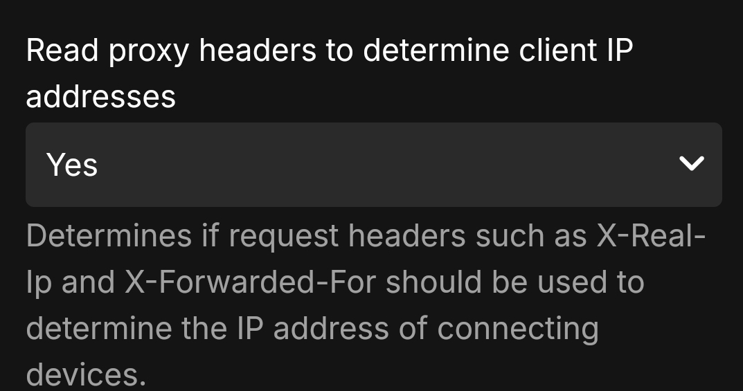

darkassassin07 674 Posted September 24, 2024 Posted September 24, 2024 Don't forget this setting (under server network settings)
