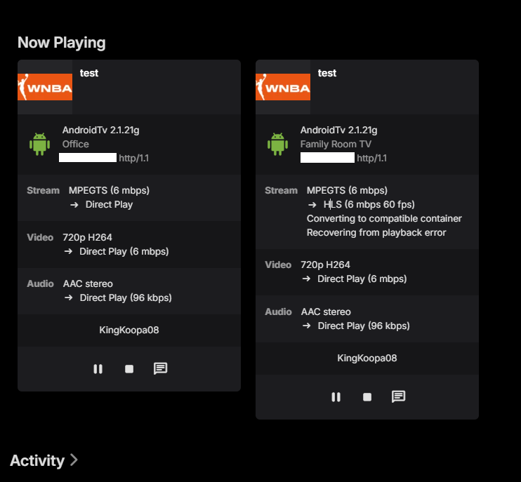

KingKoopa08 17 Posted September 24, 2024 Posted September 24, 2024 As you can see on the screenshot below. I have One stream that says its recovering from a playback error and one doesn't. They are both here at my house, wired connection, running the same device (Nvidia Shield) and same app from the play store. I also attached the log of the Recovering from playback error stream. I couldn't find one for the stream that is doing Direct Play. The one that does say Recovering from playback error seems to have a brief pause (like 1second) so its quick enough to notice the audio stopped and you notice the screen was frozen for a split second. Why is the one saying converting to a compatible container and the other one isn't? ffmpeg-directstream-ab97af62-a7cc-40ed-a782-f85433580fb4_1.txt
ebr 16334 Posted September 24, 2024 Posted September 24, 2024 Does one of the apps have the option to allow direct streaming TS and the other not?
Luke 42241 Posted September 25, 2024 Posted September 25, 2024 @KingKoopa08 This is likely your issue: Enable Playback Remuxing: False
