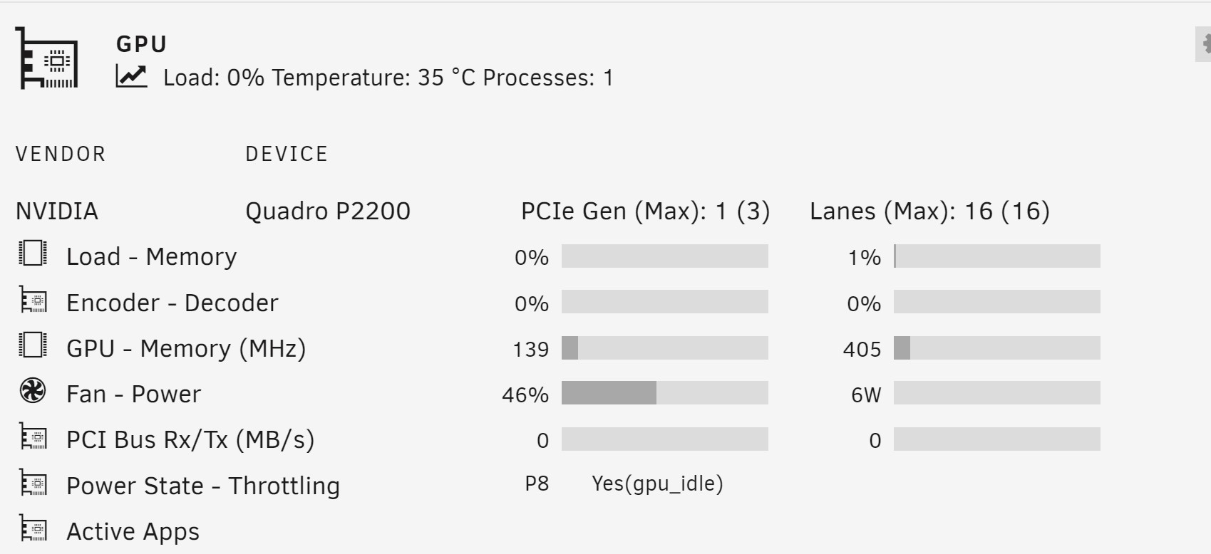

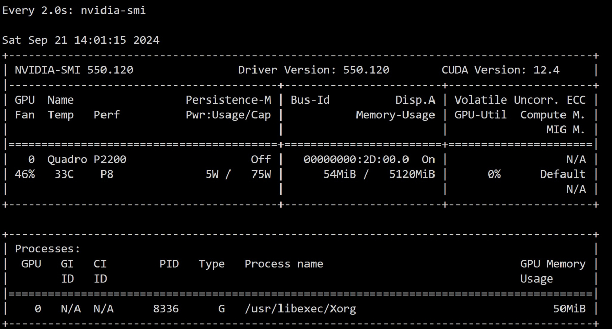

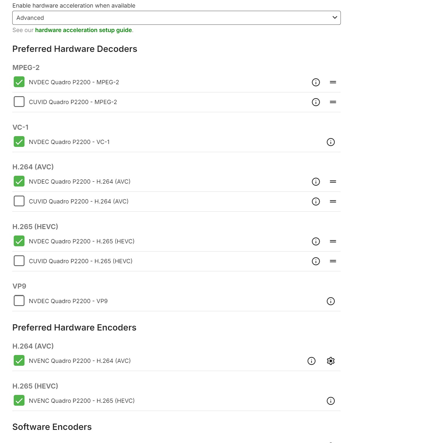

Bigdog5000 8 Posted September 21, 2024 Posted September 21, 2024 Hi, I had my Nividia GPU p22000 working fine with Plex, using the Linuxserver docker. So, I decided when I came back to Emby I would use the same docker brand. For the life of me I can't get it to see my card, but the system shows the card is there(See attachment)., but Emby won't pick it up. I put all the required settings in from the guide that's out there. and rebooted. I did go to Advanced settings, doesn't show card. The only thing I haven't tried is removing the drivers and putting them back in. They were working for Plex so I didn't see any need to. I'm using the Nvidia Driver plugin from Unraid. Tried downgrading the drivers one version. (I'm up to date) I tried to switch to the official container, I matched the Official template with mine, and copied the folders over. I couldn't get it to connect. It could be because of one the following reasons, something not syncing properly. I'm using a domain with Cloudflare (DNS Only} SSL being generated by Swag. I have the container on it's own docker network, which shouldn't matter. If i copied the exact same folders over I don't see why it wouldn't work, using the same ports. I'm just cautious about losing my data. It was a lot of work to set this up with the users. I wouldn't mined going to the official docker, it may solve my problems with the GPU. Not sure which direction to take. Any Suggestions? Thank you.

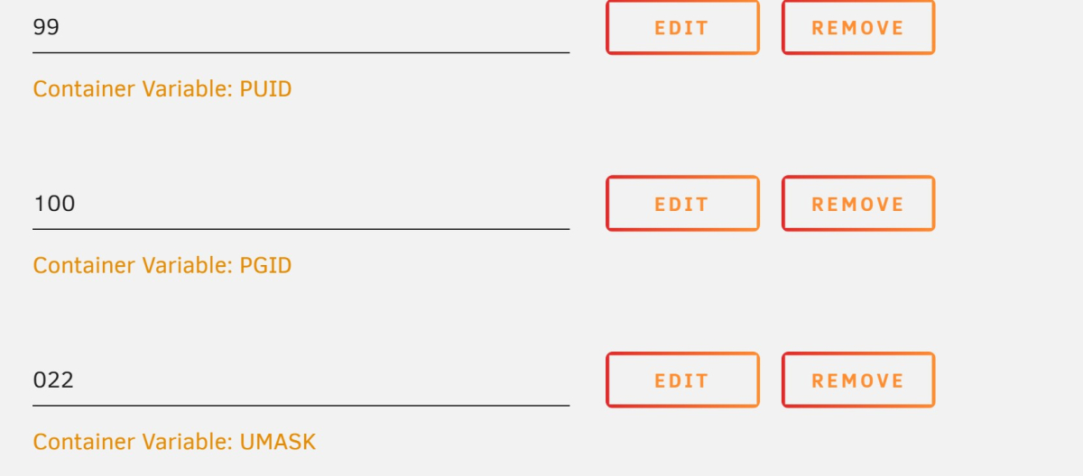

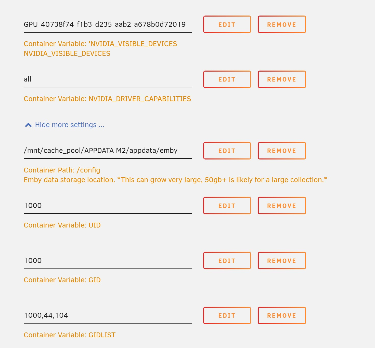

guunter 49 Posted September 24, 2024 Posted September 24, 2024 9 hours ago, Bigdog5000 said: This is what I have in the lower part right now. Should I change all those out for your settings? I appreciate you sending feedback. This is driving me crazy. LOL My Emby works fine with those settings. Those are the root uid and gid that unraid uses so don’t change it… if you were doing docker compose in Linux you’d do what @darkassassin07did

Bigdog5000 8 Posted September 24, 2024 Author Posted September 24, 2024 On 23/09/2024 at 01:08, darkassassin07 said: A couple excerpts from my docker compose file: runtime: nvidia environment: - UID=1000 - GID=1000 - GIDLIST=1000,44,104 - NVIDIA_VISIBLE_DEVICES=all - NVIDIA_DRIVER_CAPABILITIE S=all devices: - /dev/dri:/dev/dri The above GIDLIST is the user group emby runs under, the group id for /dev/dri/card0, and the group id for /dev/dri/renderD128 If I remember correctly, HW transcoding wasn't working for me until I got those right. Here's some images

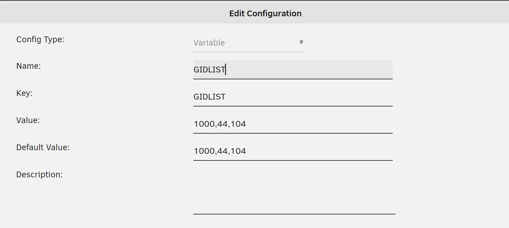

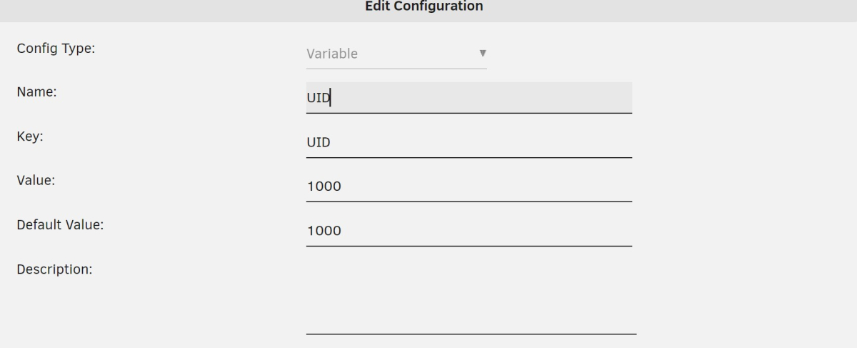

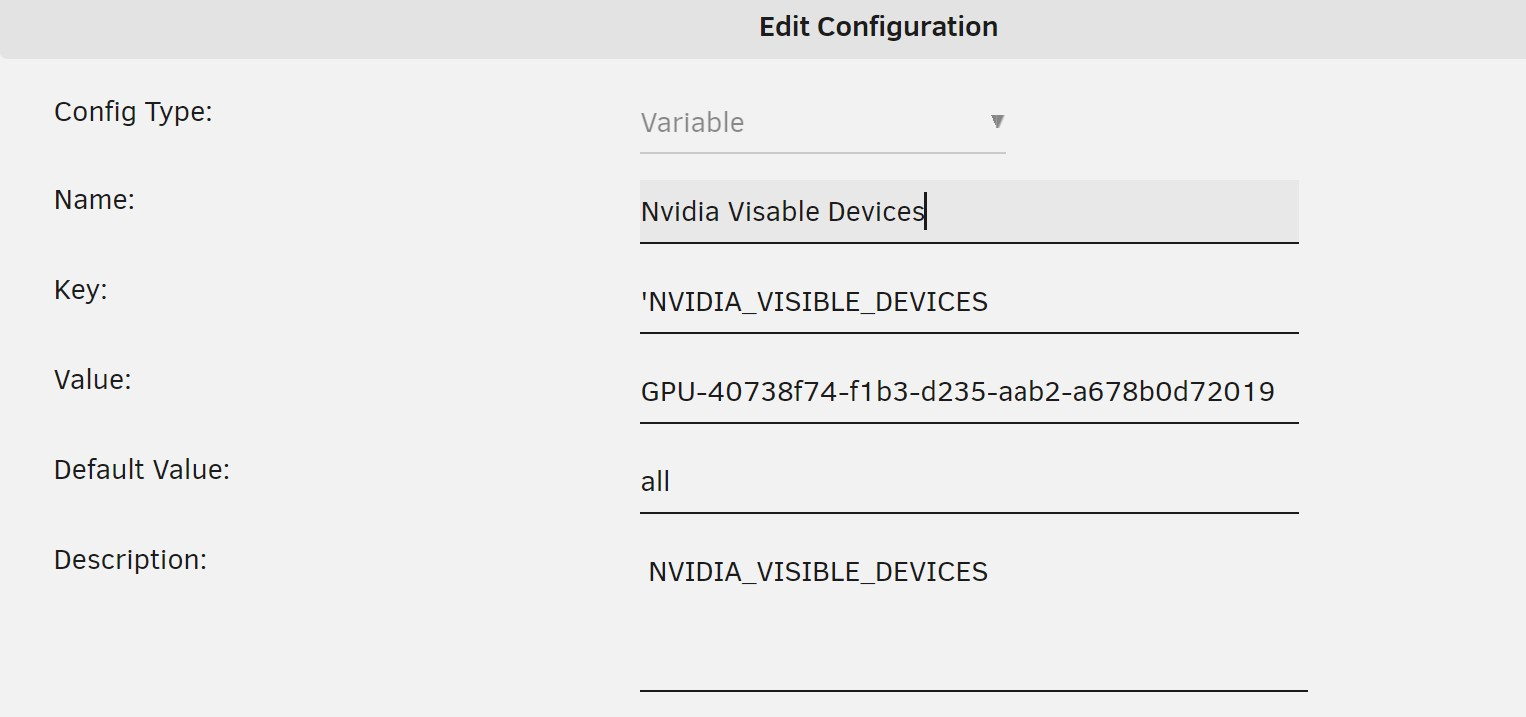

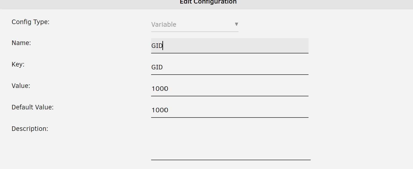

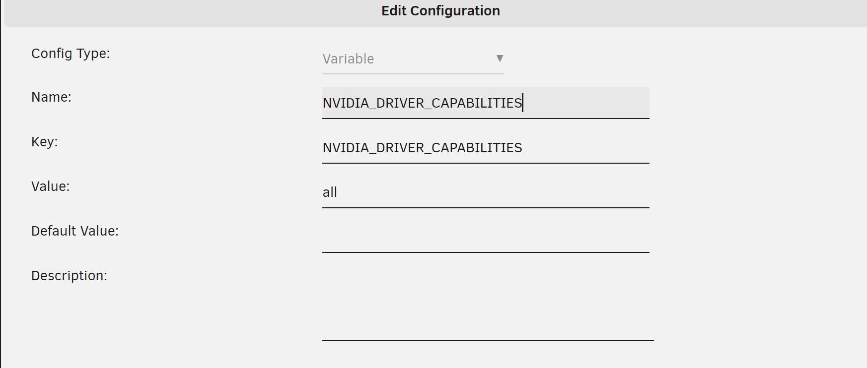

Bigdog5000 8 Posted September 24, 2024 Author Posted September 24, 2024 5 minutes ago, Bigdog5000 said: Here's some images I think I got it guys, I noticed a typo in pic 2 when I was putting them in. I have attached an image. Did it select everything i need? Thanks very very much for the assistance. 1 1
Bigdog5000 8 Posted September 24, 2024 Author Posted September 24, 2024 (edited) 22 hours ago, darkassassin07 said: If you have an option to add a GIDLIST, probably via an environment variable, make sure it contains your emby gid (looks like its gid 100 from your screenshot) and the user groups for your card (ls -ln /dev/dri/). If not, perhaps you can add user 99 to the usergroups your card is in. Tho I'm not very familiar with this part (linux permissions.... Really not my Forte). I'd welcome additional advice. Edited September 24, 2024 by Bigdog5000
Bigdog5000 8 Posted September 24, 2024 Author Posted September 24, 2024 22 hours ago, darkassassin07 said: If you have an option to add a GIDLIST, probably via an environment variable, make sure it contains your emby gid (looks like its gid 100 from your screenshot) and the user groups for your card (ls -ln /dev/dri/). If not, perhaps you can add user 99 to the usergroups your card is in. Tho I'm not very familiar with this part (linux permissions.... Really not my Forte). I'd welcome additional advice. Thanks very much, now just have to wait and see if it works. Don't see why not. Might have to adjust to your numbers maybe. It's progress. 1
guunter 49 Posted September 24, 2024 Posted September 24, 2024 3 hours ago, Bigdog5000 said: Thanks very much, now just have to wait and see if it works. Don't see why not. Might have to adjust to your numbers maybe. It's progress. It's always something super easy lol. But i would change it back to 99,100. Unraid was intended to use 99 and 100 (nobody). You don't need the GIDLIST either for passthrough to work on unraid. 1 1

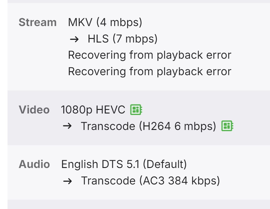

Bigdog5000 8 Posted September 25, 2024 Author Posted September 25, 2024 18 hours ago, guunter said: It's always something super easy lol. But i would change it back to 99,100. Unraid was intended to use 99 and 100 (nobody). You don't need the GIDLIST either for passthrough to work on unraid. This is strange, the movie is showing transcode, but the gpu is showing it is not in use. The movie shouldn't even be transcoding, it's a newer Fire stick they are using. My gpu always shows Processes: 1 no matter what. Something is still off a bit. FYI: I have a 3 gig Fiber line.
guunter 49 Posted September 25, 2024 Posted September 25, 2024 Have you tried another HEVC video file? It looks like your Firetv couldnt play that format.
Happy2Play 9812 Posted September 25, 2024 Posted September 25, 2024 Would need server and ffmpeg logs for that example but "recovering from playback error" suggest the play does not like something specific to the file. 1

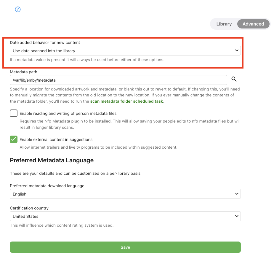

Solution guunter 49 Posted October 4, 2024 Solution Posted October 4, 2024 20 minutes ago, Bigdog5000 said: I hear you. I was thinking I would give some of my users a bonus, not working that way for everybody. I have a few people that might be able to direct stream 4ks. Emby doesn't play nice with HDR10+ & DV. I have to strip the HDR10+ on some of my files. Not a big deal, don't have that many with both. I can play it all fine, I guess that's all that matters I'm happy with my hardware as well, very seldom do I transcode. Mostly if someone is using something old. When I first started adding users I told them they had to have at least newer Fire Sticks. I figured it's free, they can spend a few bucks. LOL. Have a question for you. How can I upgrade a Tv series without it readding it to the recently added section again? It should be this setting here for your Library.
Luke 42243 Posted October 4, 2024 Posted October 4, 2024 Please note that changing this option won’t change date for content already imported, just new content going forward.
Bigdog5000 8 Posted October 5, 2024 Author Posted October 5, 2024 23 hours ago, guunter said: It should be this setting here for your Library. Thank you! 1
