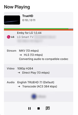

GhostRider 49 Posted September 23, 2024 Author Posted September 23, 2024 Maybe of interest, I logged onto my Emby Server whilst the TV app was hung after playing the intro, the dashboard shows the intro as "now playing"

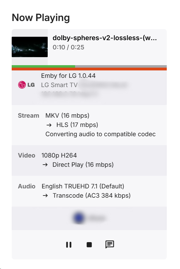

GhostRider 49 Posted September 25, 2024 Author Posted September 25, 2024 Hi @Luke, downloaded a new Dolby TrueHD Intro to test. This hangs as well, interestingly it hangs at 10 seconds in which is the same play time as the original Intro. ffmpeg log attached, I can enable debug on the server and generate a server log if required. ffmpeg-remux-ede940bd-cf73-4c20-81d0-038bb0b0c172_1.txtffmpeg-remux-ede940bd-cf73-4c20-81d0-038bb0b0c172_1.txtffmpeg-remux-ede940bd-cf73-4c20-81d0-038bb0b0c172_1.txt
GhostRider 49 Posted September 26, 2024 Author Posted September 26, 2024 (edited) Futher testing shows the same hang after 10 seconds with any Codec Intro that requires transcoding. Another example as below. Any idea what is causing this please? I can upload the Codec Intros to a share if you would like to test with the same files. ffmpeg-remux-b3d423c1-69a9-424f-82b1-835fd2164d7f_1.txt Edited September 26, 2024 by GhostRider

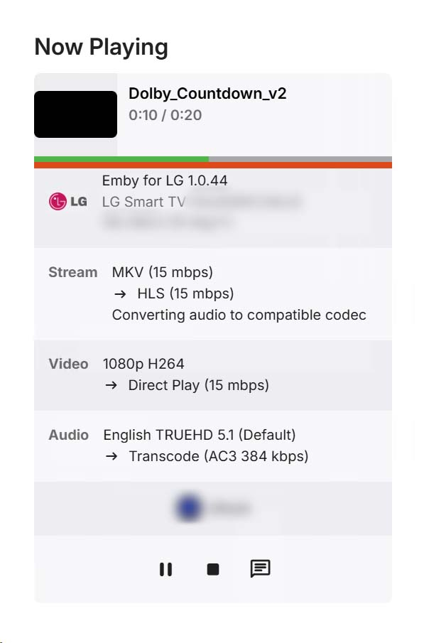

GhostRider 49 Posted October 2, 2024 Author Posted October 2, 2024 Hi @SamES To be 100% sure I just ran a library scan and the issue with Codec Intros stalling is still present. I have done several tests a summary is as below: 1) Only the LG App is affected, browser and Windows client on my HTPC play all Coded Intros with no issue. 2) With the LG App only Codec Intros with Dolby TrueHD audio fail, Dolby Digital and DTS play fine. 5 and 7 channel Dolby TrueHD both fail. 3) LG App always hangs at 10 seconds into playing the Codec Intro, tested with Dolby TrueHD intros of 11, 20 and 25 seconds duration. 4) LG App fails if there is only one or if several different Codec Intros in the TrueHD folder on the server. Windows client and Browser will pick at random which intro is played if several intros in the folder. LG App still fails if only one intro in the folder and a fresh scan completed. 4) Hang is 100% reproducible 1

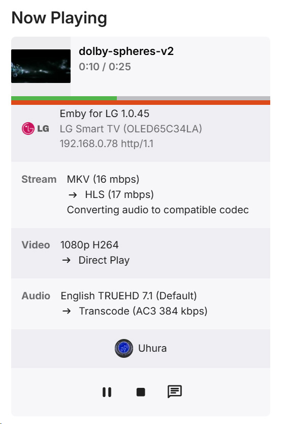

GhostRider 49 Posted March 17, 2025 Author Posted March 17, 2025 Hi thanks for the prompt reply. As requested new server log and ffmpeg logs attached. Also attached screenshot of server dashboard showing frozen at 10 seconds. Hopefully debug setting is on, I used the "yes until next server restart option". Only happens with TrueHD Intros that need encoding. Windows server version 4.8.11.0 LG TV app version 1.0.45 embyserver.txt ffmpeg-remux-f761883c-eda9-4093-8ecc-3efac0fe049a_1.txt
