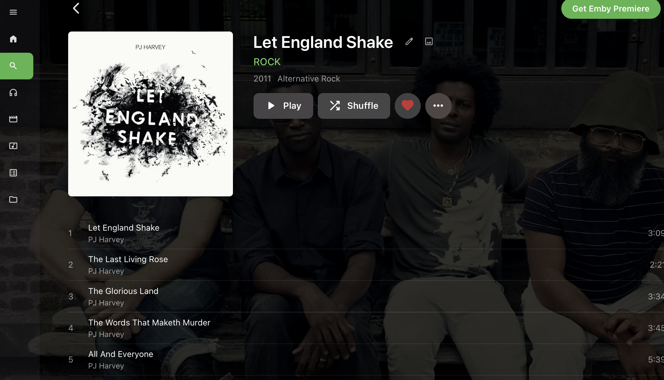

lusoemby 2 Posted September 19, 2024 Posted September 19, 2024 Just installed Emby (QNAP nas, apple ecosystem). I'm running a large library of my own music and movies, which is very well organized, particularly regarding ID tags. I've got a strange error on a bunch of albums, it just assumed "ROCK" as the band name and I can't seem to find any option to correct this under the metadata menu. These same files are running perfect in other apps (like Apple music) but anyway I opened them in my tag manager app and sure enough everything is correct, so it's not a problem with bad tagging. Looks like it took some random albums and yanked them from under the original artist. How can I correct this?

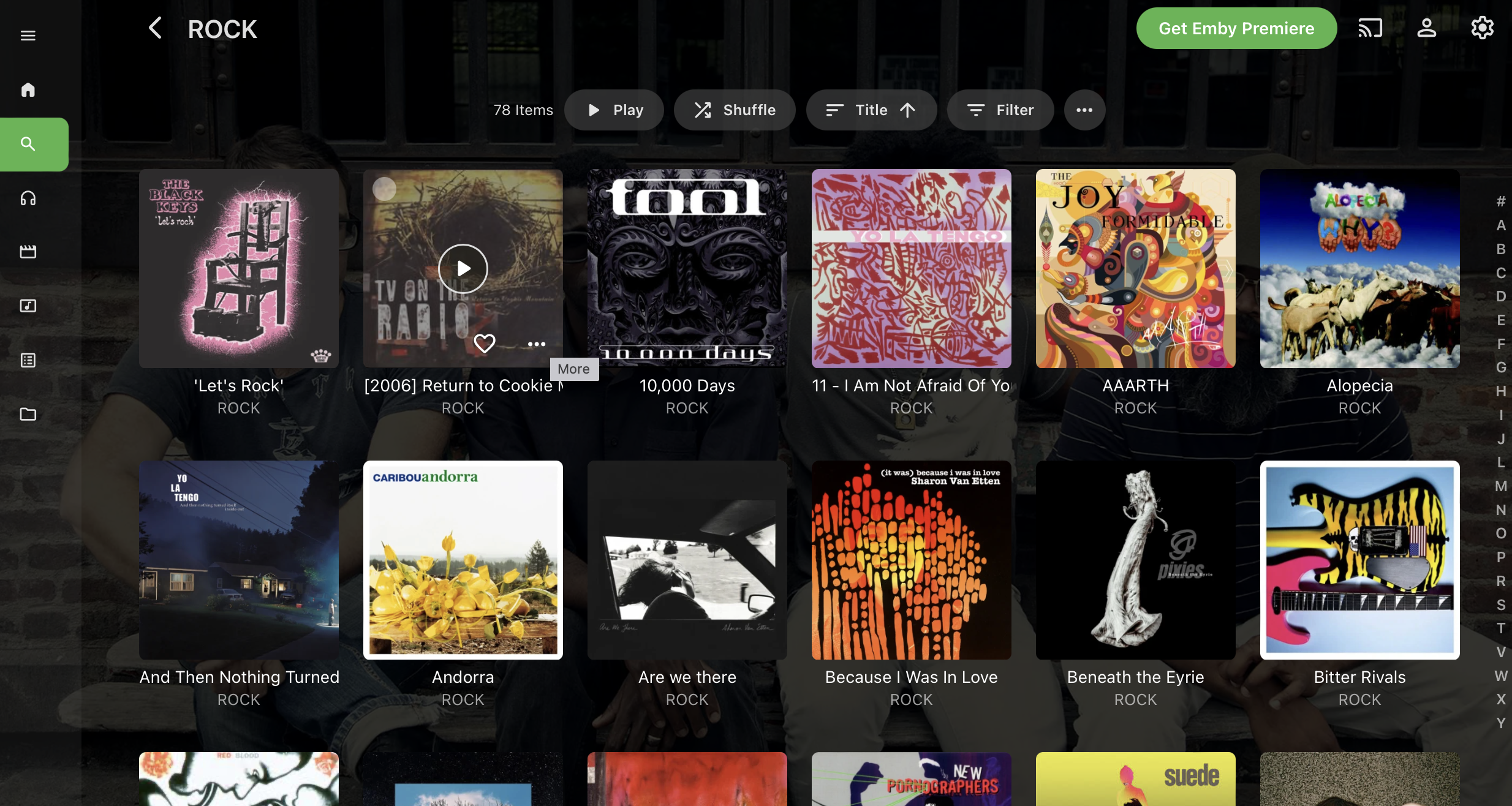

user24 349 Posted September 19, 2024 Posted September 19, 2024 (edited) Hi, From the PJ Harvey Album screenshot example, it appears that Emby is correctly importing the Artist tag as "PJ Harvey", but importing the AlbumArtist tag as "ROCK". And it seems like you (annoyingly) have 78 problem albums with this issue. For one of the problem Albums, what does your tag manager app show exactly for: Artist Album Artist AlbumArtist and/or any other related artist tags/fields? Do you use MusicBrainz Artist IDs? What tagging app do you use? Are there any tagging differences between correctly imported Albums and the problem ones? What music folder structure do you have - are the albums in a folder called "ROCK"? While not doubting that your tags are correct, sometimes there can be slight importing differences between various applications that can cause issues (as I found out for myself when first using Emby). Providing a screenshot of your tags from your tagging program (and any more info you can think of) could be useful to help resolve this. There is some basic info here, if you haven't seen it already: https://emby.media/support/articles/Music-Naming.html Sorry if that is more questions, rather than an immediate answer for you, I expect Emby would ask you for the same/similar details? P.S. I use Windows (not MacOS) and Artist/Album Artist metadata can be edited in Emby only at individual track level (I think?). I don't recommend this though. Better to get the metadata importing right, if at all possible. Cheers! Edited September 19, 2024 by user24 Added P.S. Section
lusoemby 2 Posted September 19, 2024 Author Posted September 19, 2024 Thanks for the detailed reply! My music folder structure is indeed like that, albums in folders like ROCK, JAZZ, etc, so that explains psrt of the problem. My music files are in a couple of drives I don't have here, but I checked one of the affected albums I have on my laptop and it does indeed lack the "album artist" field, so that should explain the rest. Plex allows for tag correction but from what I can see, Emby doesn't have that possibility, so maybe the best would be to delete the albums from Emby and then re-upload corrected versions?
Solution user24 349 Posted September 19, 2024 Solution Posted September 19, 2024 Yes, a blank Album Artist field and a ROCK folder was my suspicion! If you fill in the Album Artist field with your tagging app and then rescan the relevant folders in Emby (likely no need to delete them from Emby first), then hopefully that will fix the problem for you. 1 2

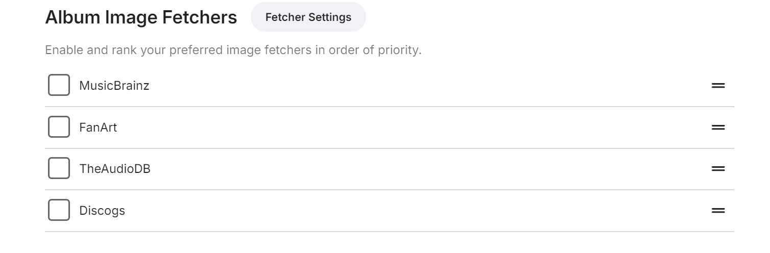

lusoemby 2 Posted September 19, 2024 Author Posted September 19, 2024 (edited) Ok, we'll do! On a related note, there are a few albums that didn't seem to get the correct album co er image. I try to use Emby sources (I basically selected all the ones available when setting up the libraries) to fetch images but it always just stays a black screen with only the sources available. Seems strange it doesn't find anything on all those sources for the 20 albums or so I tried? Edited September 19, 2024 by lusoemby 1
user24 349 Posted September 19, 2024 Posted September 19, 2024 I have all my album covers embedded in the files, so don't really rely that much on Emby fetching them from MusicBrainz, etc. I assume you have all these turned on: Are they obscure albums that are not in these databases perhaps??? Did they appear in Plex for you previously??? Also, sometimes when you are setting up a large library, it takes a while for the scan to import everything. Perhaps start up a separate thread/post about this with some further example details. More info is usually useful! I won't be able to look at it immediately, but if no one else does in the meantime, I might be able to help a bit later on... 1
