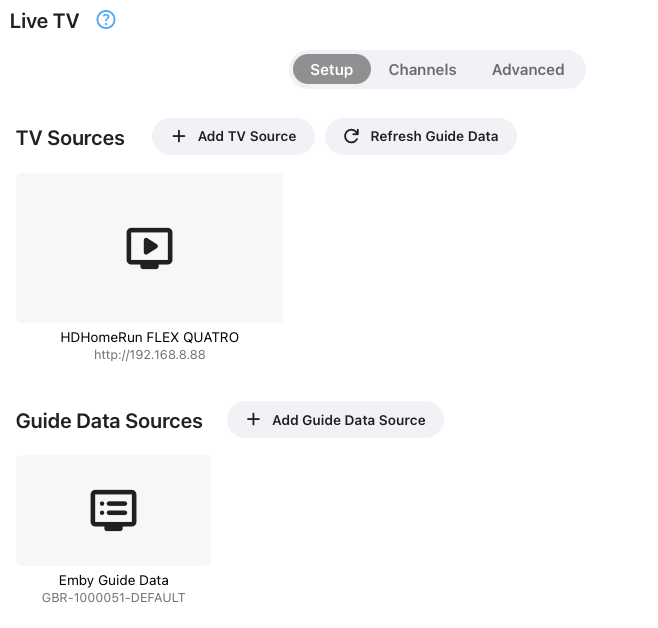

Luke 42237 Posted September 19, 2024 Posted September 19, 2024 And are you using emby guide data or xml?
Cluttered 15 Posted September 19, 2024 Author Posted September 19, 2024 It's GBBO that I want mainly, so I guess I can live with iot this way but it's a bit worrying that other things may fall foul of this too.
