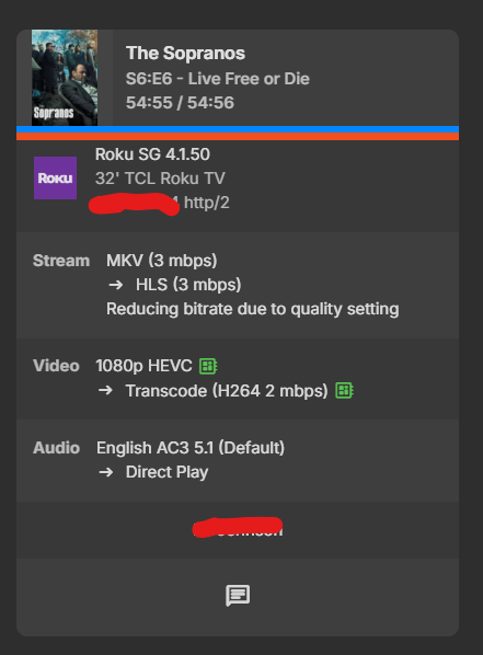

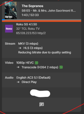

bandit8623 235 Posted December 6, 2025 Posted December 6, 2025 Hi there, @sa2000 So think i have an example. this has been sitting here for the day. ffmpeg-transcode-f3ca136e-ef5a-4df3-9dca-c05877b22e5b_1.txtembyserver (20).txt
sa2000 703 Posted December 6, 2025 Posted December 6, 2025 11 hours ago, bandit8623 said: So think i have an example. this has been sitting here for the day Thanks. I have added this example to the issue that is with the development team I see it shows playback got to the end. There is no indication of that in the log other than it started at 07:39 at offset of 29 min 33 seconds 1
bandit8623 235 Posted December 6, 2025 Posted December 6, 2025 3 hours ago, sa2000 said: Thanks. I have added this example to the issue that is with the development team I see it shows playback got to the end. There is no indication of that in the log other than it started at 07:39 at offset of 29 min 33 seconds user says the show was not over when they shut of the roku. was around the middle point of the show
sa2000 703 Posted December 6, 2025 Posted December 6, 2025 24 minutes ago, bandit8623 said: User says the show was not over when they shut of the roku. was around the middle point of the show The log confirms that - actually it was only played for about a minute and a half from 07:39 starting at offset 29 minutes into the 55 minute episode and last successful request from the roku was for an offset that was only 80 seconds beyond that. The 32' TCL Roku TV must have got switched off about a minute after start - and the server did not notice it
