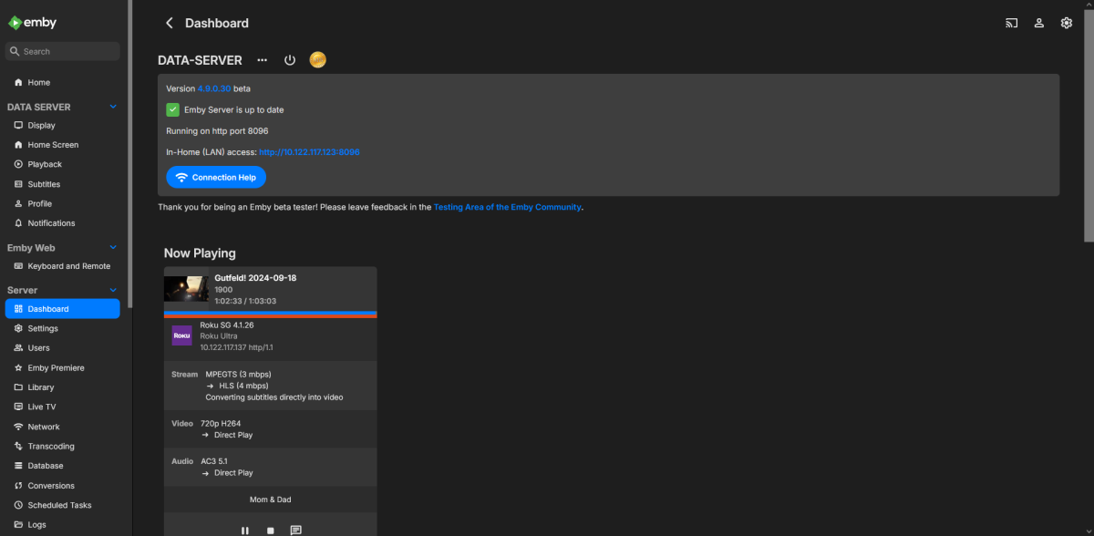

coreymichael 1 Posted September 19, 2024 Posted September 19, 2024 As you can see in the picture, when a file is finished playing on one of the Roku devices, it doesn't remove itself from the dashboard. I have no issues with any of the files being played on all the other devices in the house, it only appears on the same device. Does anyone know if the file is not properly closing out somewhere either in Emby or the Roku? This file will remain on the dashboard until I reboot the Emby server. It will stay even when rebooting the device, or playing any other content from another app on the problematic Roku. This Roku always holds onto the file in the Emby dashboard. Three of the four Roku devices in the house are all the same model number and all of them are updated. None of the others have this problem. It's one of those three that do this every time. I've noticed it's been happening for a few months. It's not really a huge deal, but it's annoying to see on a constant basis. It happens with all video files regardless of the content or extension. Any help would be greatly appreciated. Like I said, it's not a huge deal. Just more of an annoyance. Thanks in advance!
Happy2Play 9814 Posted September 19, 2024 Posted September 19, 2024 (edited) There are several of these topics of abandoned playback session stuck on Dashboard and currently the only way to remove them is to Restart Emby. Devs would like to see the server log for that playback session to see if they can see any issues. But in the end the server never recieved the stopped command from the client. So a question could be asked what did the user do at the end of playing this content? As Roku is can be the worst of just hitting the Home button and Emby having no idea what has happened. Edited September 19, 2024 by Happy2Play
coreymichael 1 Posted September 19, 2024 Author Posted September 19, 2024 Awesome. Thanks for the info! That makes perfect sense. The user most of the time either just leaves it abandoned & the Roku goes into screensaver mode, or as you mentioned, hits the home button on the remote as soon as the file is over. The weird thing is that it doesn't behave that way on the other two TVs with the same model Rokus. I'm not sure if it is user account related, but would make sense if it was. The other Roku devices are used with my sign in and neither one has that issue. Next time the issue happens, I'll re-visit this thread and post the logs.

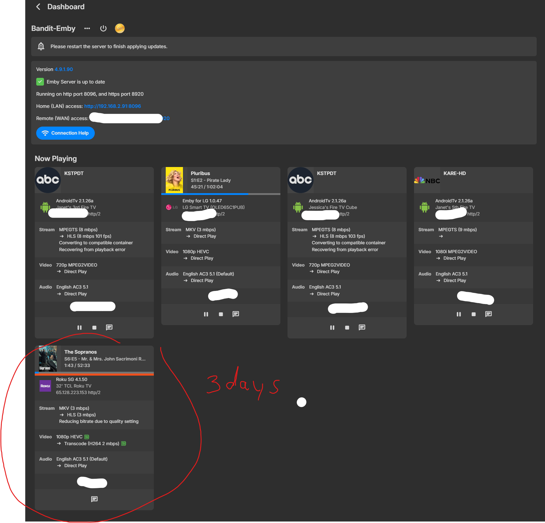

bandit8623 235 Posted November 18, 2025 Posted November 18, 2025 (edited) 3 days sitting idle on my dashboard embyserver (18).txt embyserver-63898934397.rar Edited November 18, 2025 by bandit8623
sa2000 703 Posted November 18, 2025 Posted November 18, 2025 (edited) 9 hours ago, bandit8623 said: 3 days sitting idle on my dashboard Emby Server does have "idle" playback session detection and would normally remove the session. But obviously this "idle" session detection is not always working and the cause needs to be found. I did 3 tests with roku today, pressing the remote "Home" button during playback and even pulling the power lead - and in all the 3 tests, idle detection worked ok and the session was removed from the dashboard 3 examples in my tests - idle is detected when the periodic playback progress updates from the app stop 2025-11-18 12:51:10.495 Debug SessionManager: Playback progress (TimeUpdate) reported by app Roku SG 4.1.50 on Roku 3 (UK) - 6225AG007943 playing Robin and the Hoods. Position: 32000 ms. PlaySessionId: 74413d299d5044b993d25d7eee5050e5 2025-11-18 12:51:21.493 Debug SessionManager: Playback progress (TimeUpdate) reported by app Roku SG 4.1.50 on Roku 3 (UK) - 6225AG007943 playing Robin and the Hoods. Position: 43000 ms. PlaySessionId: 74413d299d5044b993d25d7eee5050e5 2025-11-18 12:52:28.519 Info SessionManager: PlaySession 74413d299d5044b993d25d7eee5050e5 has gone idle while playing 2025-11-18 12:55:19.426 Debug SessionManager: Playback progress (TimeUpdate) reported by app Roku SG 4.1.50 on Roku 3 (UK) - 6225AG007943 playing I Am Legend. Position: 22000 ms. PlaySessionId: 77d1a8abefc44aa4b5d6d0d07251171f 2025-11-18 12:55:30.430 Debug SessionManager: Playback progress (TimeUpdate) reported by app Roku SG 4.1.50 on Roku 3 (UK) - 6225AG007943 playing I Am Legend. Position: 33000 ms. PlaySessionId: 77d1a8abefc44aa4b5d6d0d07251171f 2025-11-18 12:56:30.438 Info SessionManager: PlaySession 77d1a8abefc44aa4b5d6d0d07251171f has gone idle while playing 2025-11-18 13:03:55.592 Debug SessionManager: Playback progress (TimeUpdate) reported by app Roku SG 4.1.50 on Roku 3 (UK) - 6225AG007943 playing The Adventures of Tintin - S2, Ep2 - The Broken Ear (1), The Broken Ear (2). Position: 895000 ms. PlaySessionId: bd3e7f71a1c34b2dbfc7c8b12c4ad293 2025-11-18 13:04:05.981 Debug SessionManager: Playback progress (TimeUpdate) reported by app Roku SG 4.1.50 on Roku 3 (UK) - 6225AG007943 playing The Adventures of Tintin - S2, Ep2 - The Broken Ear (1), The Broken Ear (2). Position: 905000 ms. PlaySessionId: bd3e7f71a1c34b2dbfc7c8b12c4ad293 2025-11-18 13:05:11.207 Info SessionManager: PlaySession bd3e7f71a1c34b2dbfc7c8b12c4ad293 has gone idle while playing There is currently an issue open with the development team regarding idle session detection Edited November 18, 2025 by sa2000
