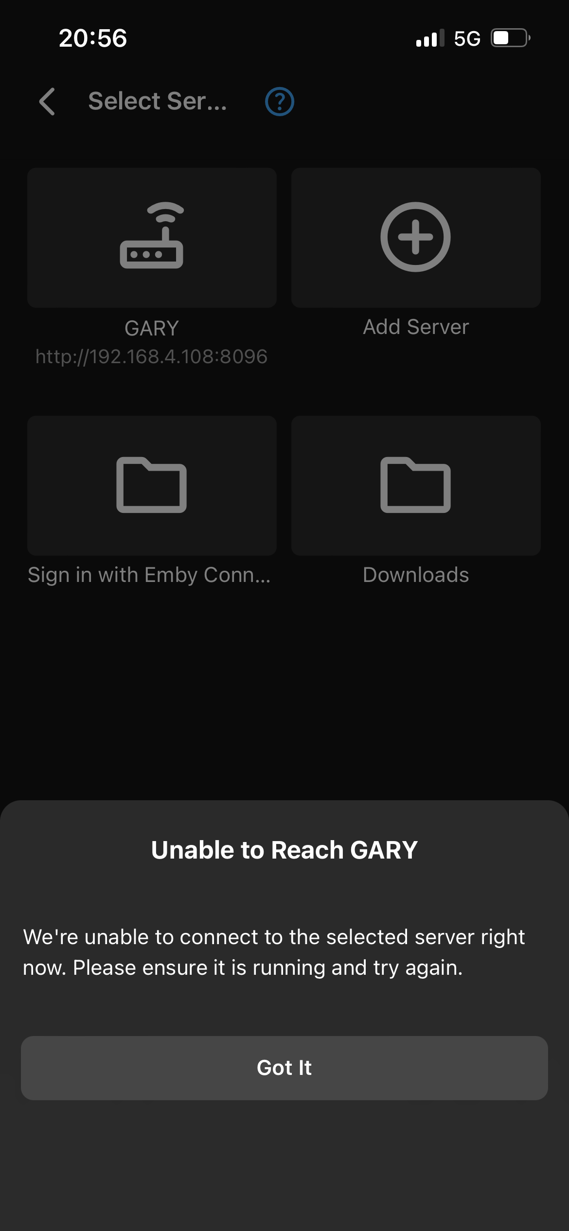

garygary 0 Posted September 19, 2024 Posted September 19, 2024 So my home network works with Emby in multiple devices, but not on iPhone outside of the network/with WiFi turned off. Remote access is granted, and I tried signing into Emby connect on the app but it just goes back to main screen. Anyone able to assist?

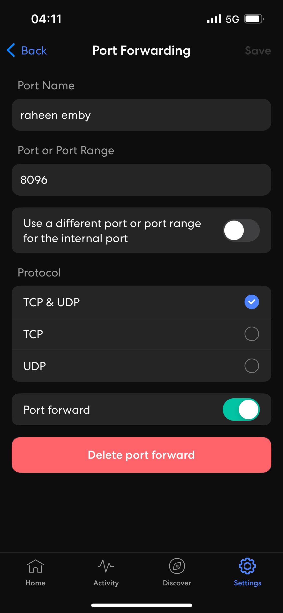

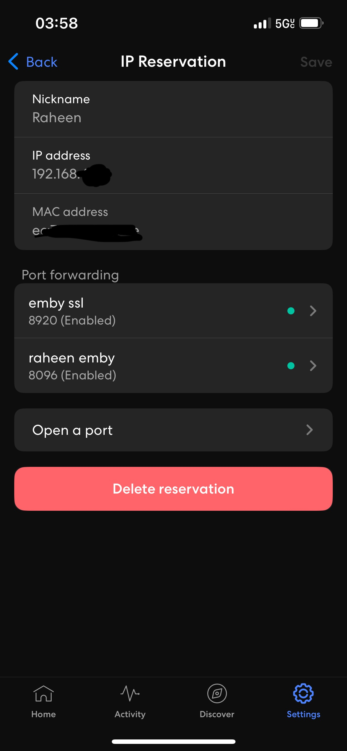

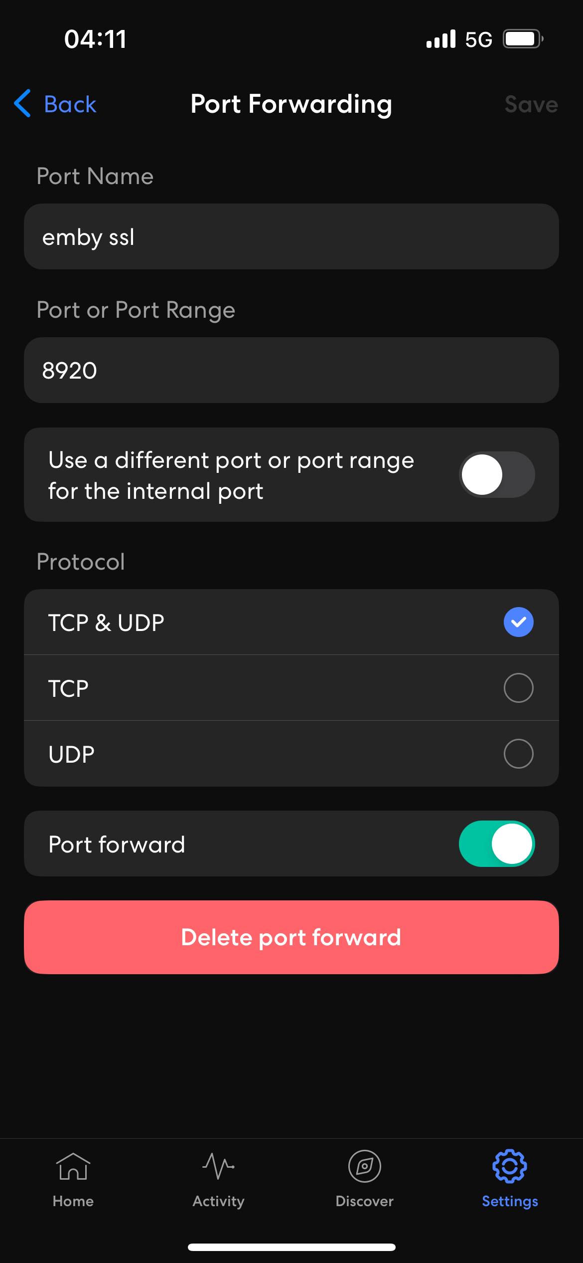

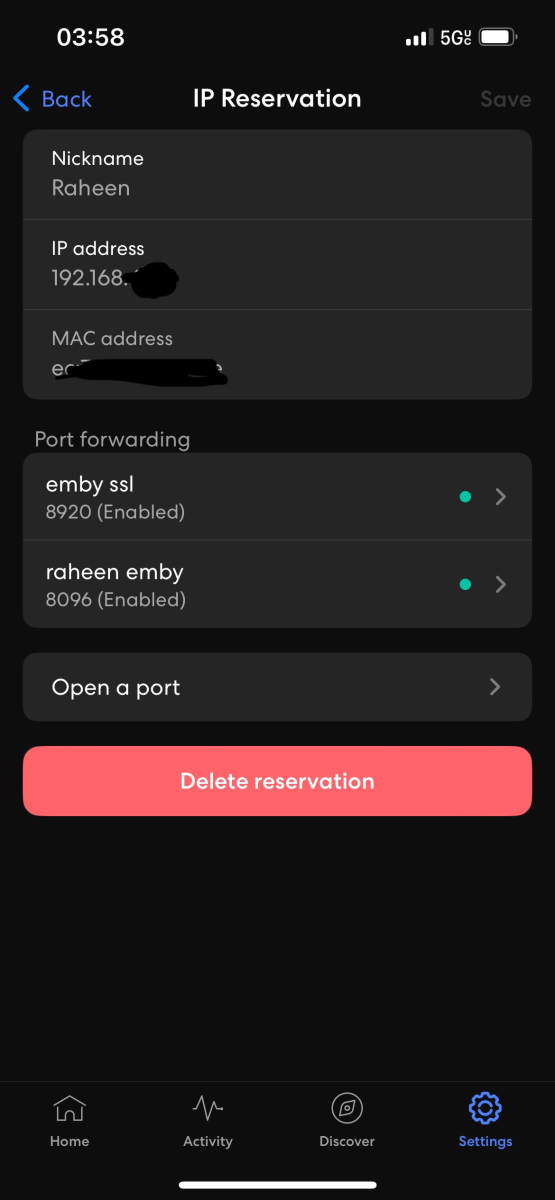

garygary 0 Posted September 19, 2024 Author Posted September 19, 2024 5 hours ago, seanbuff said: You say 'Remote access is granted', but have you also followed the Remote Setup guide? This will ensure that your Emby Server can communicate over the internet outside of your WiFi. Let us know how you go. Thanks mate I tried following the instructions and added port forwarding and it is still not working. Using Eero as a router if that helps you see what I am doing wrong?
seanbuff 1356 Posted September 19, 2024 Posted September 19, 2024 11 minutes ago, garygary said: Using Eero as a router if that helps you see what I am doing wrong? Can you show a screenshot of your port forwarding rules?
Luke 42241 Posted September 19, 2024 Posted September 19, 2024 HI, have you checked to make sure that your ISP isn't using a CGNat? If they are then this will require additional workarounds such as a VPN or TailScale.
