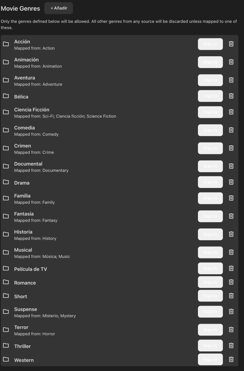

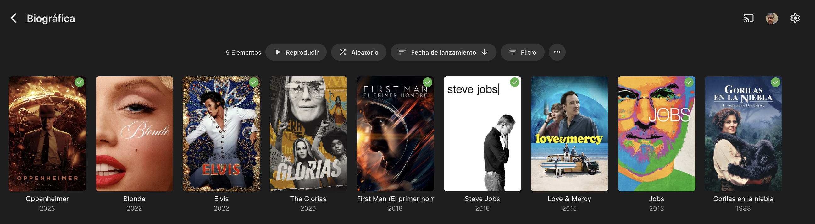

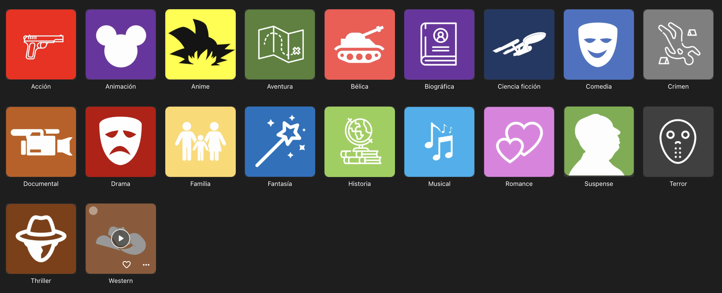

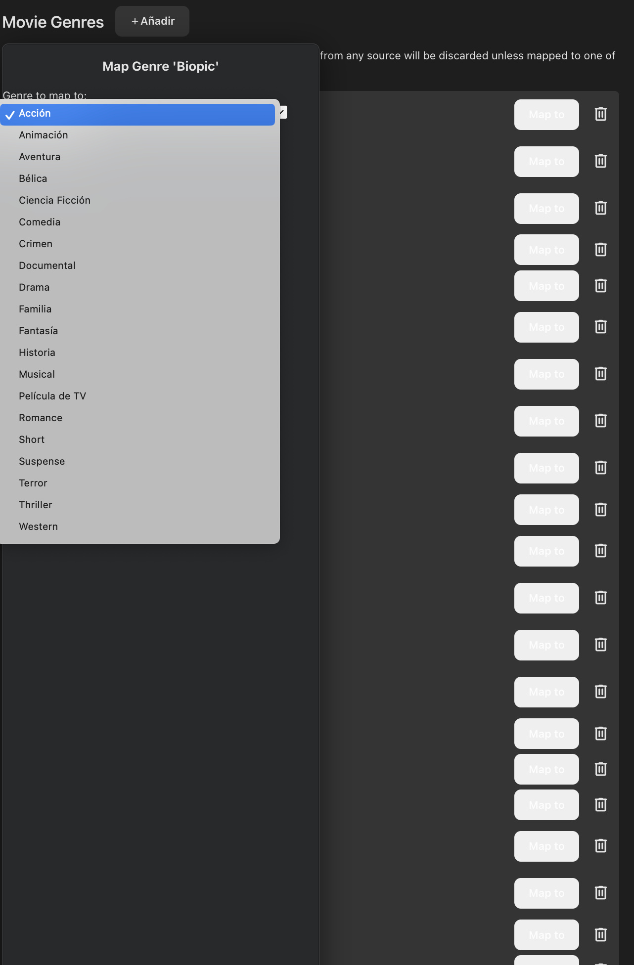

DarkStar1977 120 Posted September 17, 2024 Posted September 17, 2024 Hi, I noticed that Genre Cleaner is not working properly. Those are the genres I've in Movies: This is the mapping I have in Genre Cleaner: As you can see there's not Rule yet for "Biográfica" (Biopic in Spanish). Let's create one to modify Biográfica to Biopic: As you can see, seems there's no "Biográfica" Movies to be mapped to Biopic .... but, those movies exist: So seems that Genre Cleaner is not reading properly Genres anymore. Can someone (the developer) take a look at this ? thanks in advance.

GrimReaper 4828 Posted September 18, 2024 Posted September 18, 2024 I'd guess we're not on the same page here: - OP has genre Biografica in his library (visible from the screenshot) - However, he cannot map Biopic to that genre as it is not listed in plugin dropdown - How would Refresh Metadata solve that? At best, genre Biografica would remain unchanged - at the worst, it'd be replaced with some other, depending if full refresh and/or field locked; - Question is why genre Biografica isn't already listed in plugin dropdown?
ebr 16302 Posted September 18, 2024 Posted September 18, 2024 2 minutes ago, GrimReaper said: Question is why genre Biografica isn't already listed in plugin dropdown? Because it hasn't been added with that "+" button at the top of the page. The first time you bring up Genre Cleaner settings, it will scan your library and bring in all the genres that exist. But it only does this once. If you wish to map a new genre, you just create that genre with the + button and then map (I have to admit I'm working on very old knowledge here but I'm pretty sure that is still the process). @softworkz? 1
GrimReaper 4828 Posted September 18, 2024 Posted September 18, 2024 Yeah, haven't checked it myself in quite some time, but if understood correctly, OP should actually create 2 genres by "+": Biografica and Biopic, and then map latter to former?

softworkz 5105 Posted September 18, 2024 Posted September 18, 2024 2 hours ago, ebr said: The first time you bring up Genre Cleaner settings, it will scan your library and bring in all the genres that exist. But it only does this once. If you wish to map a new genre, you just create that genre with the + button and then map (I have to admit I'm working on very old knowledge here but I'm pretty sure that is still the process). @softworkz? I can only explain the new (yet unreleased) cleaner plugin. I had looked at the current one only once during development of the new one but I don't remember the UI logic. But what I do know - and what never made sense to me - is that the current plugin scans all genres you have just once, and among all those, you can do the mappings you like, but that's kind of like once and forever. You can manually add mappings for additional genres at any time later, but you never get to know about any genres that you don't have in your mappings, because the plugin removes all unknown (non-mapped) genres before you ever get to see them.

ebr 16302 Posted September 18, 2024 Posted September 18, 2024 3 hours ago, softworkz said: I can only explain the new (yet unreleased) cleaner plugin. I had looked at the current one only once during development of the new one but I don't remember the UI logic. But what I do know - and what never made sense to me - is that the current plugin scans all genres you have just once, and among all those, you can do the mappings you like, but that's kind of like once and forever. You can manually add mappings for additional genres at any time later, but you never get to know about any genres that you don't have in your mappings, because the plugin removes all unknown (non-mapped) genres before you ever get to see them. The plug-in was designed back when tmdb put a ton of trash (tags and keywords) into the genre field and this was a way to limit your genres to just a few that you cared about. tmdb no longer does that so the utility of this plug-in is really quite limited at this point IMO. If you wish to allow a new genre after the initial scan, you must add it with that "+" button I mentioned. 1
