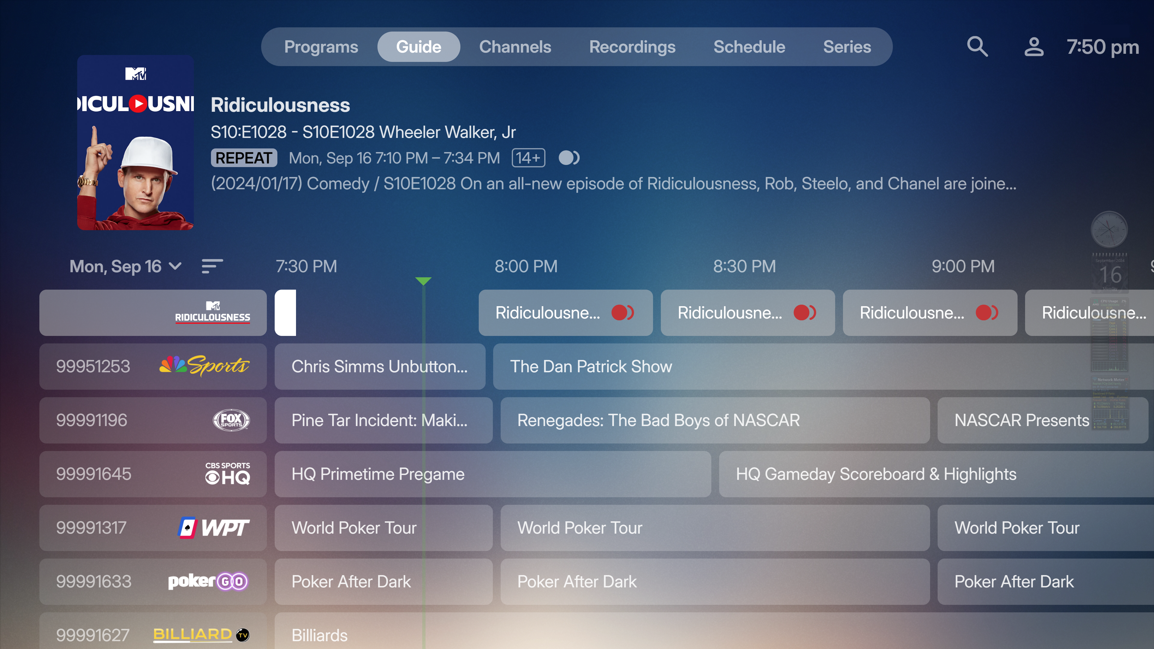

flic 13 Posted September 16, 2024 Posted September 16, 2024 (edited) a picture's worth a 1000 words...So, why the hole in the guide? the issue is, as you can see the gray dot, the show is not recorded because Emby does not see it in the guide PlutoTV is the m3u provider and is working fine Edited September 17, 2024 by flic
Luke 42241 Posted September 17, 2024 Posted September 17, 2024 HI, what guide data re you using? Have you checked the data to see that it has content during that time?

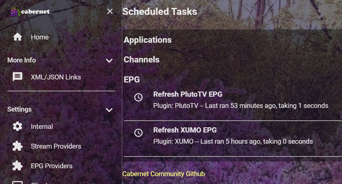

flic 13 Posted September 17, 2024 Author Posted September 17, 2024 (edited) it's coming from cabernet docker installed on UnRAID I didnt check the actual raw data yet here's a screenshot Edited September 17, 2024 by flic
Solution flic 13 Posted September 17, 2024 Author Solution Posted September 17, 2024 (edited) last EP in the raw EPG is the same as shown on top of the guide: S10E28. no E29 nor E30 that explains the gap Edited September 17, 2024 by flic 1
