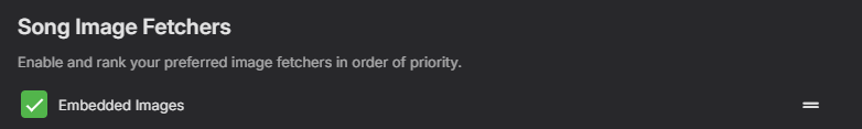

Neminem 1592 Posted October 7, 2024 Posted October 7, 2024 (edited) True thats why I do not have Nfo saver enabled, It serves no funktion. Unless you need it for something else. In fact I have no metadata enabled, but this Everything else is bloat. Here is a great FR to read through and contribute Edited October 7, 2024 by Neminem Missing link
